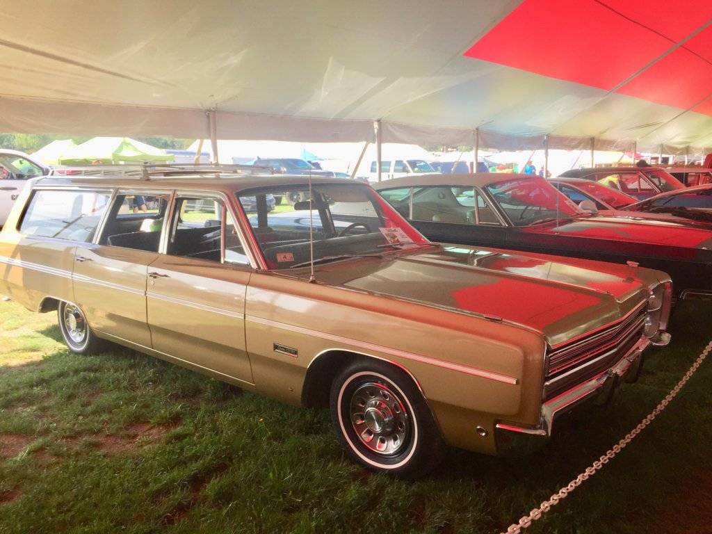

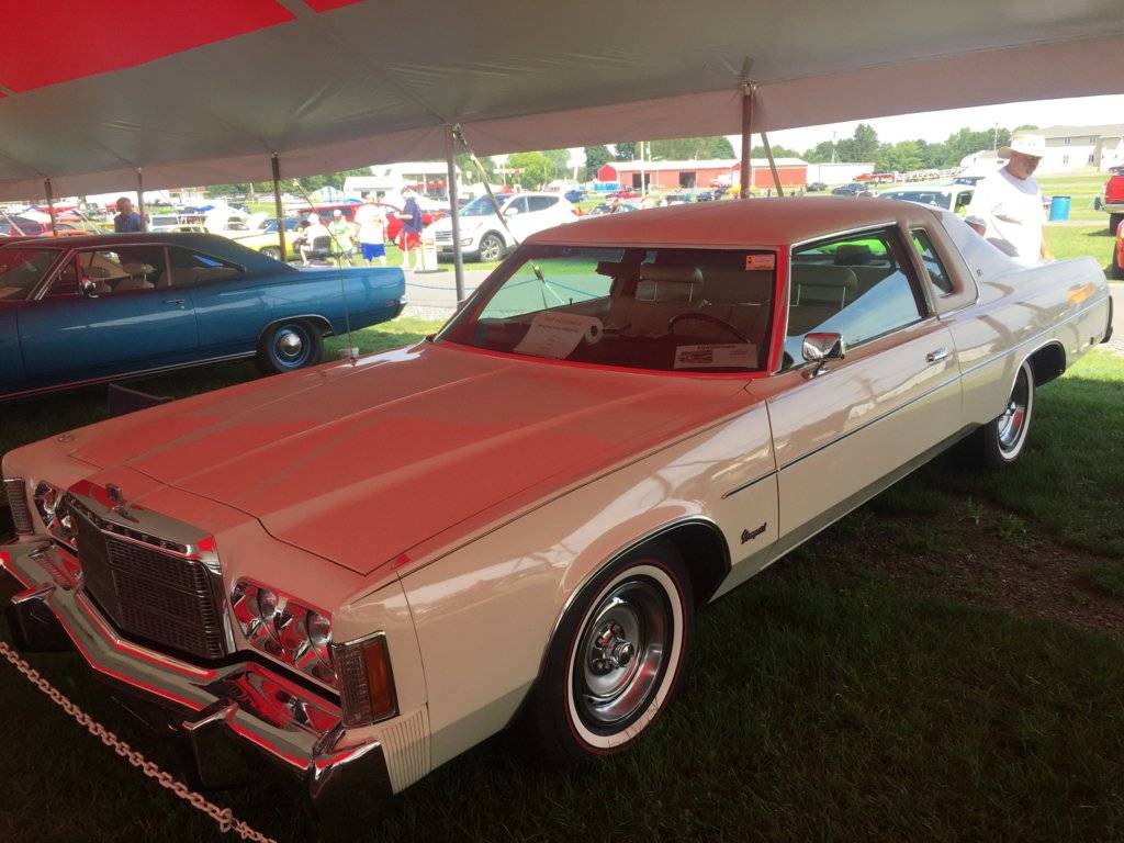

maybe ask this guy?
Very few Real survivors.

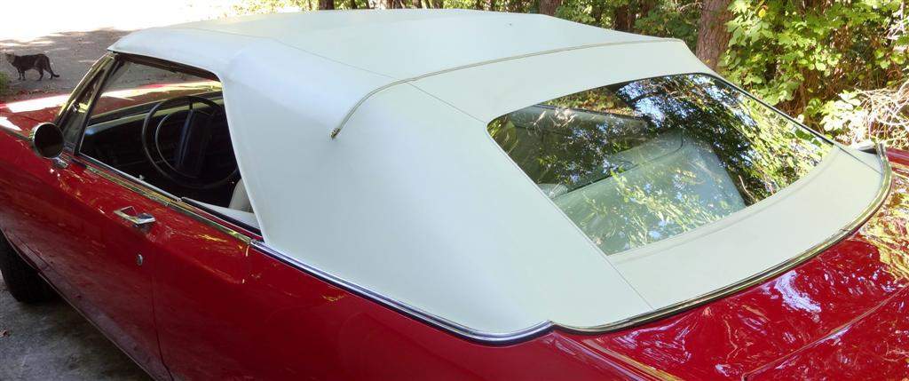

You still have the original top? Mine still has its original, stitching has failed around the rear window welting. That, general wear and shrinking have me thinking 50 years is enough for it. I've seen some on eBay that look to be a close match for the original.

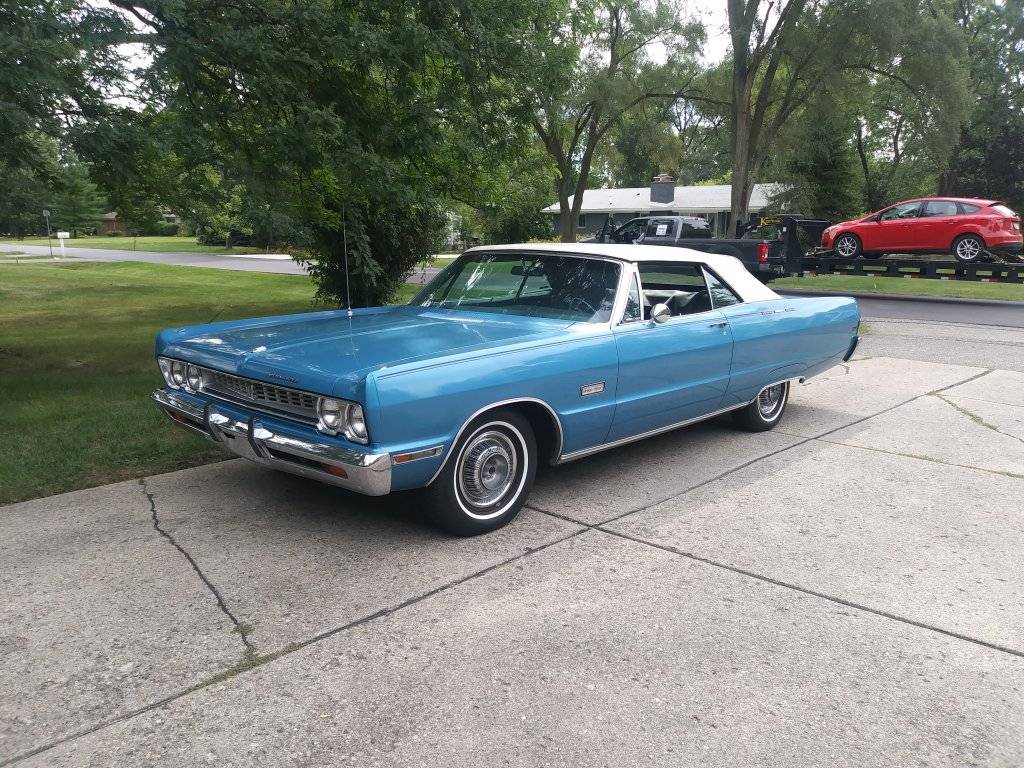

Paint,top,interior,engine compartment,ECT. All original,only upgrade is electronic ignition.
google "perfect fit tops", ask for Putt. I got the top for my 69 300 convertible and it was perfect. My trim guy installed it. He has been in the business for 50+ years and said it was one of the best tops he had worked with. Crushed vinyl material is what you want, as original.

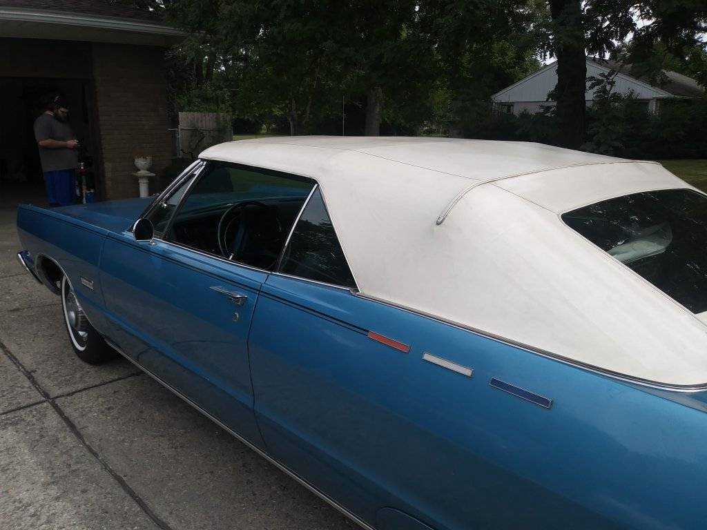

Top is original 51 years old and still soft! Have orig dated blue boot and orig floor mats.

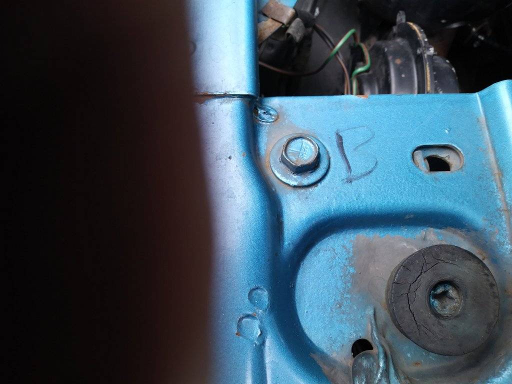

A couple more.....View attachment 372137

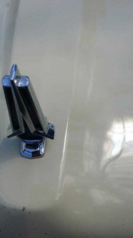

Factory paint runView attachment 372138

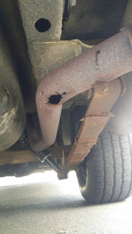

Old exhaust

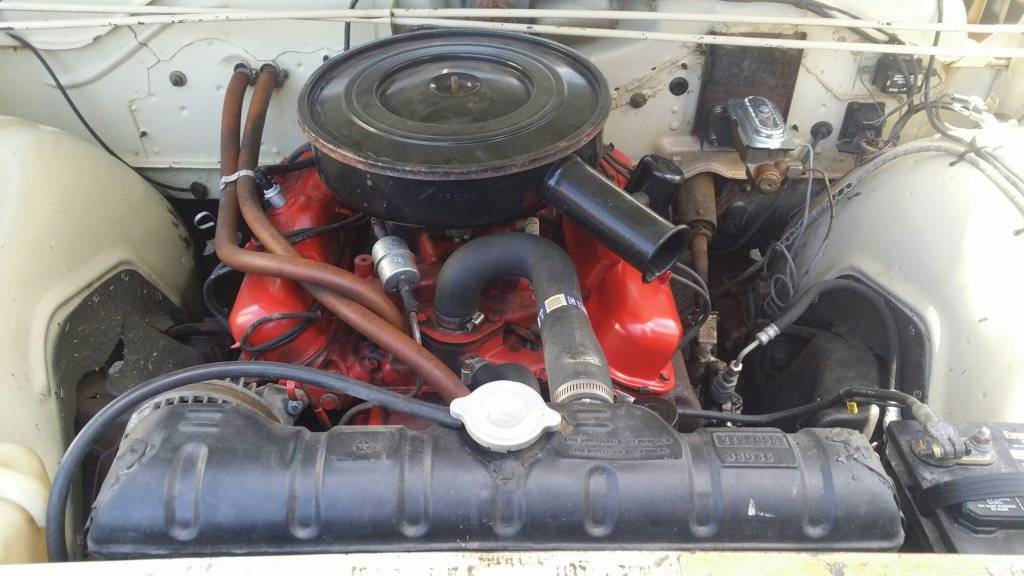

Nope, I see a safety thing-look at the alternator mounting? WTH? Bolted to the head. Probably bolted to the bracket also. Needs to have the spacer between the ears and the long bolt through them. It keeps the ears from breaking off. They could break over time with it mounting that way.
Now look at the rest of the underhood. What holds the air cleaner in Place? Wing it gone. The master cylinder is an aftermarket replacement, not original type. The bolt on top is different with a larger bolt size holding it on. Take the aftermarket sticker off the upper rad hose. Worm drive hose clamps not Corbin clamps. Bypass hose not painted engine color. Radiator number is 2898055, that is a 68 rad in a 67 car, didn’t come that way. Voltage regulator replaced with aftermarket. Aftermarket negative battery cable with an accessory wire with a yellow crimp connector on it. Never came that way. Battery is a one size fits all as it has GM bolt on studs on it as well as posts. Rear shocks with coil springs? Magnum wheels and fat tires?
Don’t get me wrong, it’s a neat and clean car. The interior looks nice with buckets and console but it’s changed. It’s pretty original on the paint, but many things changed from stock, too far away now. Not even close To a survivor. You wouldn’t get close to the survivor area at a major show.
