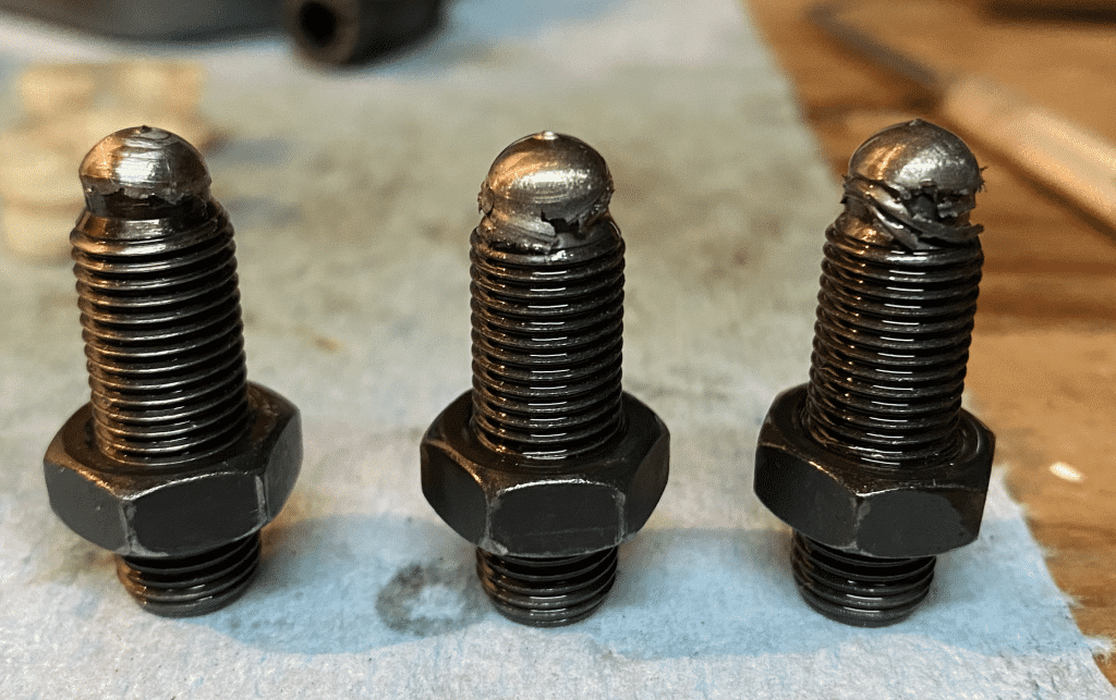

What is going on with my valve train?!?!?!?!

But we aren't talking about a lot of metal here. The adjusters look like they mushroomed and then flaked a little off. I don't think I would bother to pull the pan.
I will bet those chunks are too big to get through the pickup screen and never get as far as the filter.

Darter, upon calling 440source I found that this IS a problem that was discovered. So I am not the only person who has had a problem. I don't know why they didn't contact everyone about this and suggested they do so immediately! New adjusters are in the mail.
Now I have to figure out how to flush the engine or do I pull the engine and tear it down or drop the pan. I'm still in a little shock here.
I hate to be the bearer of bad news. A through tear down and cleaning of all engine parts is required. This is a lot of effort on your part to carry out Make sure that 440 Source provides all necessary gaskets to do so. Failure to do will certainly reduce engine life and guaranteeing catastrophic failure in the future. There is no way to flush metal particles completely w/ reliability.
