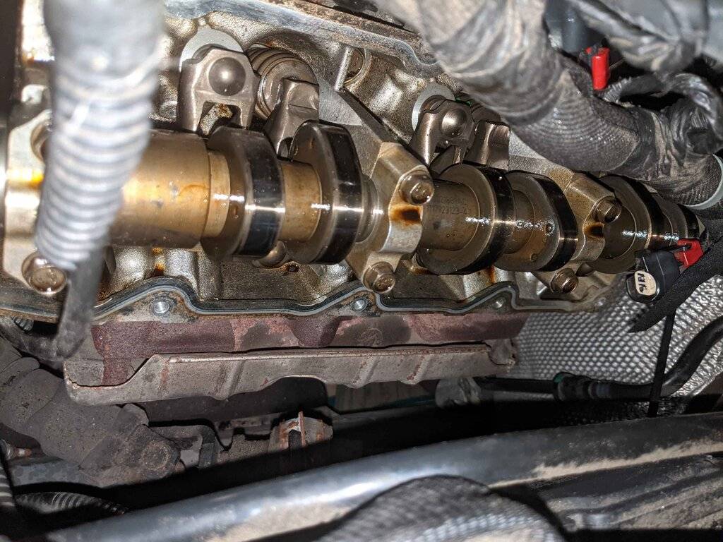

Our situation with my wife's 2011 Dodge Nitro 114,000 miles is that it is been running poorly and sometimes refusing to start. Check engine light on. Engine codes are cylinder 3 misfire permanent and multiple cylinder misfire permanent. Removed left side valve cover. I was hoping to see a rocker arm fallen off because of a bad lifter, but unfortunately I didn’t see that.

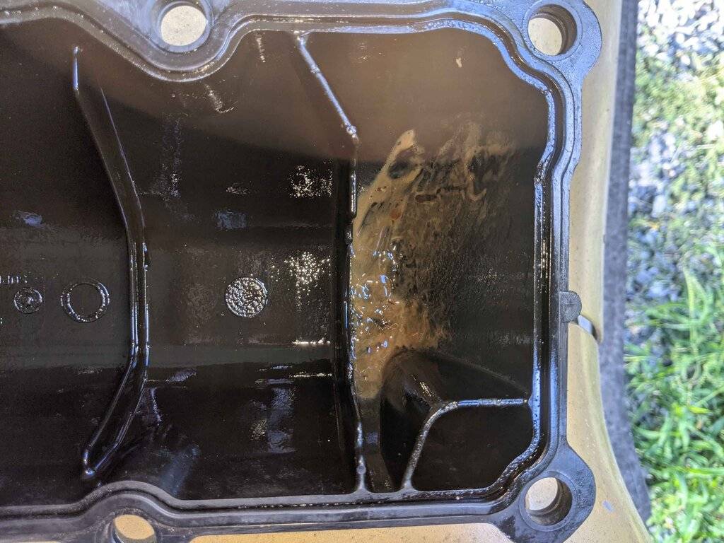

Valve cover: Has water mixed with oil deposit at rear of valve cover. Looks like brown cream. Otherwise valve cover is clean.
Rocker arms: still in place. I had my wife turn over the engine while I watched. I could not see any dysfunction of any kind in the rocker arm movement at any of the left side cylinders. This included exhaust and intake valves.
The block is cast-iron, but the cylinder heads are aluminum. I’m starting to suspect a cracked cylinder head at number 3. Although I don’t understand why that would create a creamy deposit at the back of the valve cover rather than directly above number 3 valves.

I am not familiar with every engine configuration, but generally overhead cam engines do not have lifters. Usually a blown head gasket, cracked head, or broken block gives you a mix of oil and water under pressure and temperature that results in the emulsion you see under your valve cover and/or in the coolant passages and sometimes in the oil in the crankcase. I would think further disassembly is warranted until you can for sure determine the cause.

As far as the emulsion, I've never had the valve cover off so I don't know how long it's been there. The valve cover has no breather or PCV. Wondering if water/oil could be from crankcase gases that can't escape.
With no ventilation in the valve cover, other than possible windage from the moving items, it might well be that the emulsion you see is from accumulated condensate in the crankcase/head area. How many short trips does the vehicle make where it does not get to full operating temperature for over 10miles at a time?

That was my first thought about the brown goo. It's pretty common to find that stuff under the oil cap of a short-trip vehicle that doesn't spend enough time at full temp.
i would say creamy oil means head gasket or cracked head-------on the 3.9 magnums it is a given....a good mechanic will have a sniffer to detect it....and i wouldnt hang around a mechanic that says he can look at it----either he has the tech or he doesnt-----the looking costs extra every time....

  • I pulled the #3 lash adjusters this morning. The stems are stiff, no sponginess.

· Charles said that they added a chemical to the coolant which changes color when exposed to exhaust gases. The blue color changed immediately to yellow in reaction to CO2 gases from exhaust.
· Pressure in the cooling system: built up in cold engine cooling system on the way from the parking space into the shop. It should not have built up at all. Pressure from cylinder(s) entering cooling system.
· Blown head gasket: when both of the above occur, it indicates a blown head gasket or more serious damage. Both heads will have to be removed and sent off to a machine shop to be magna flux tested and surfaced. Because of the backlog in his work, they will not get to this job for 2 weeks and it won’t be finished for another week after that.
· Estimate: $2000.
Your are right. The reason the white smoke from the exhaust pipe stops after the car warms up is that the gap where the head gasket is blown is closed by metal expansion due to heat. I approved the $2000.
