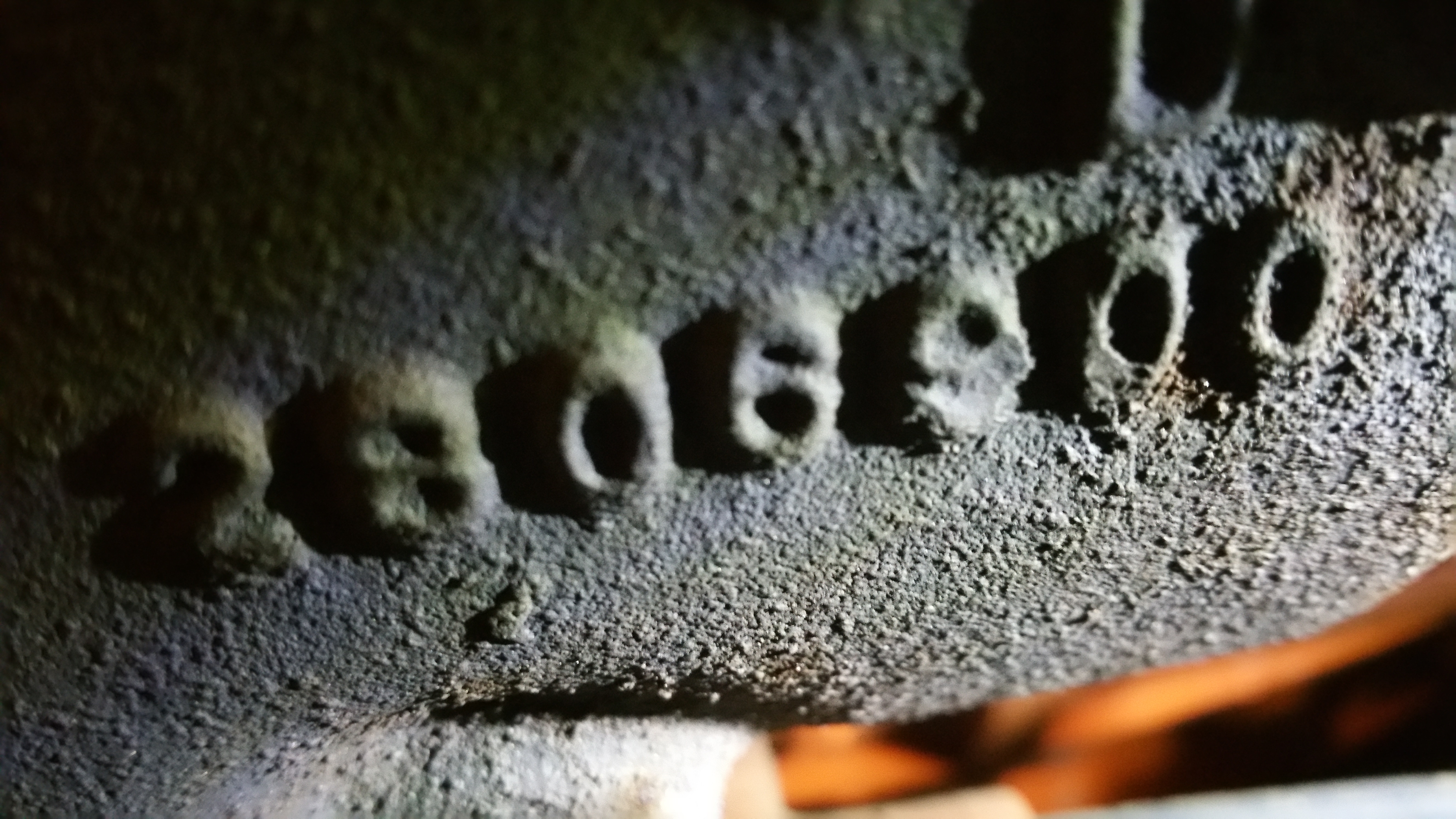

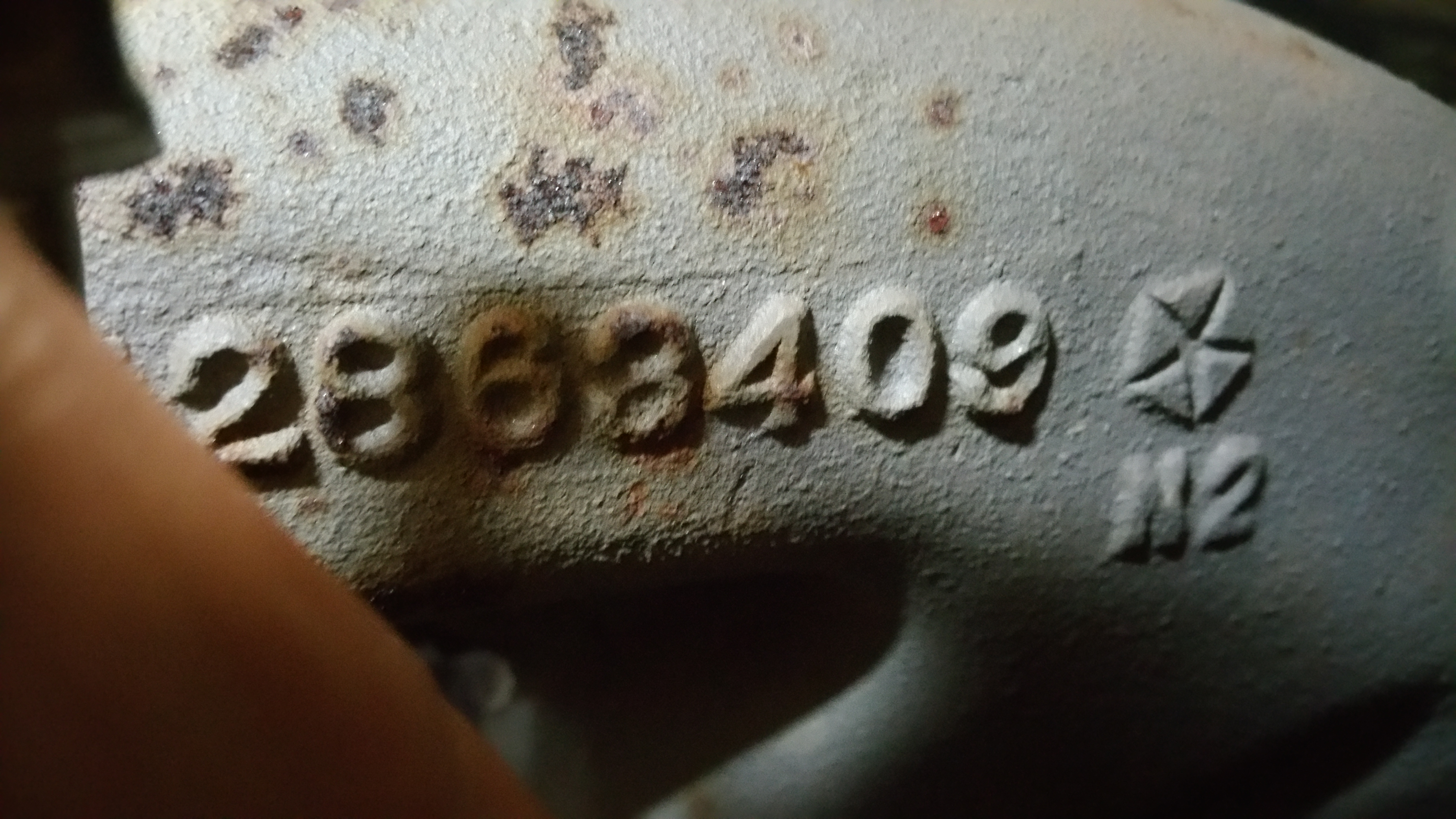

Here are my manifold number pics. Drivers side ends in 409 so I assume that is an HP and the left I have no idea of the number.
