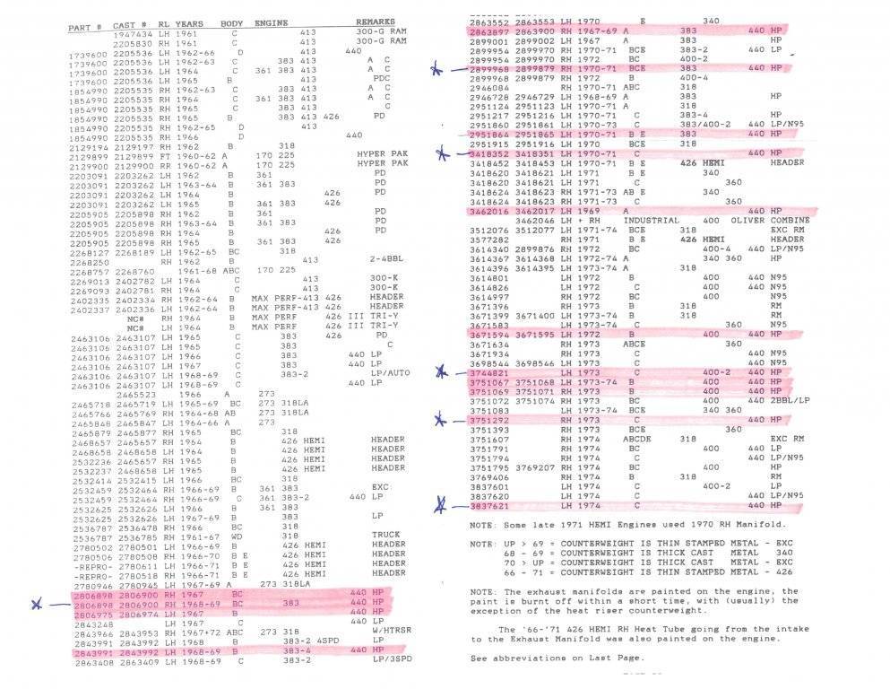

I agree with the $200 - 400 range. Here's a listing of applications. I know one of the ones I used wasn't intended for a C body, but I cannot remember which one or side at the moment. I'll have to try to check tonight.
