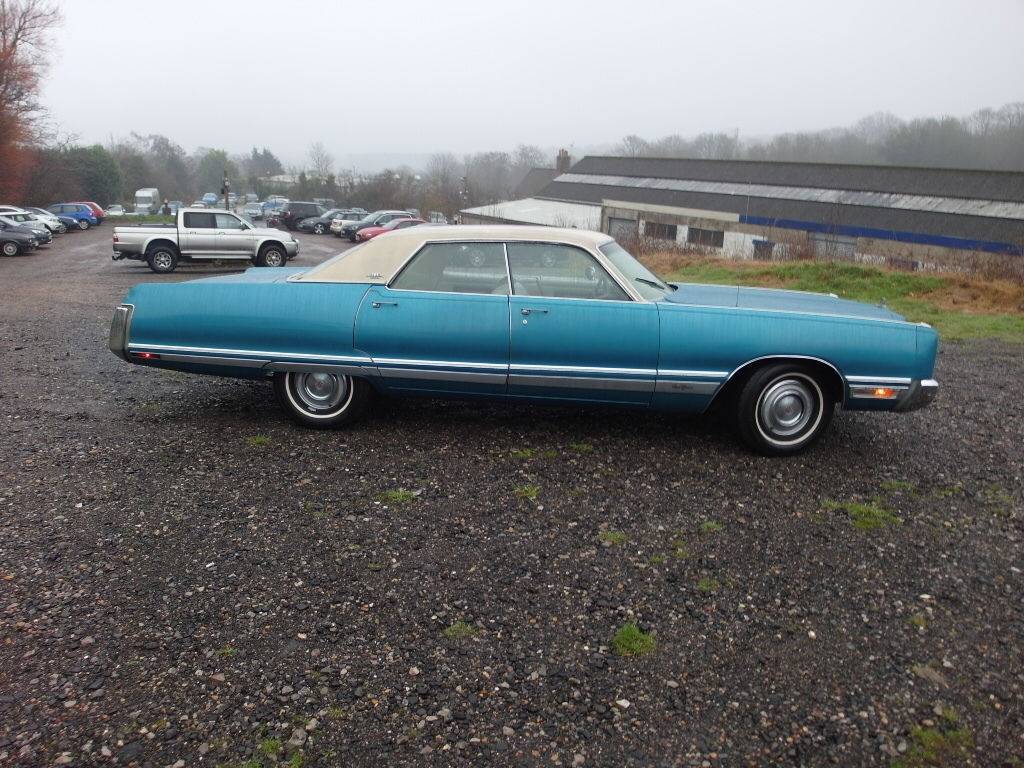

hi will they fit
American toque thrust wheels chevy 5 stud pattern 17x7 rims With tyres 225/45/17 and 30mm wheel adapters
If they are the typical Chevy pattern, 5"x5, they will not fit. The Chrysler pattern is 4 1/2" x 5.
However they will fit an Imperial.
hi will they fit View attachment 74625 American toque thrust wheels chevy 5 stud pattern 17x7 rims With tyres 225/45/17 and 30mm wheel adapters
I just re-read your post and saw you mentioned wheel adaptors (assuming you mean for bolt pattern).
Horrible idea. Especially since you need to clear a skirted rear wheel opening. Those adaptors are basically levers that increase the side loading of your wheel bearings for no good reason.
Compounding this: 45 series tires are basically rubber bands on a car of that size. It's a lot more like an SUV than a Viper, and high speed cornering is the reason for lower aspect ratio tires.
I'm not a prude who is against any/all wheel changes... just bad ideas. I had 225/60/17s on an Imperial of that era, but that's the smallest tire I'd ever consider unless I was driving to a junkyard and wanted to keep my original rims.
