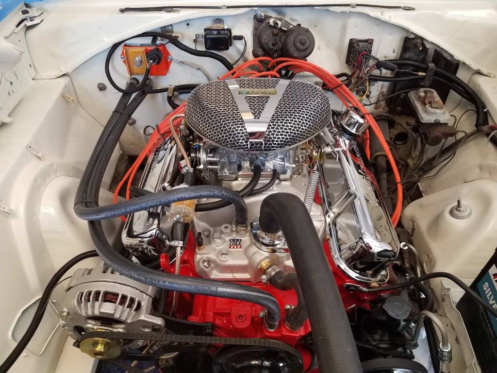

I just put a 1406 with the performer intake on my 318 with a mild cam, dual exhaust with stock cast iron manifolds and electronic ignition conversion.

Apr 6, 2018 #6 Dodgy Dick Active Member Joined Mar 13, 2016 Messages 254 Reaction score 128 Location Queensland, Australia Hey Newport 66, that looks nice !
