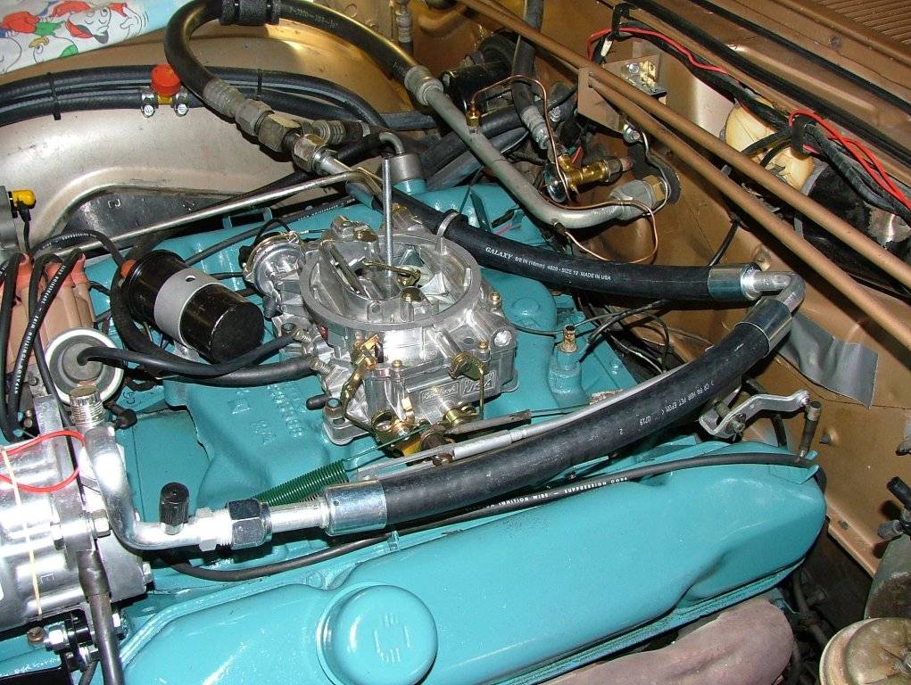

As I exhort the mechanic to get that Edelbrock 1405 plumbed in RIGHT, I ask The Wise here: is it worth investing in an after market throttle cable bracket or not? We have the recommended throttle adapter, stud and kickdown adapter from Edelbrock, so I'm curious if its worthwhile to get some after market bracket, or to just go with the instal manual and bend the throttle cable a little to fish it into position with the adapter on the carb?
