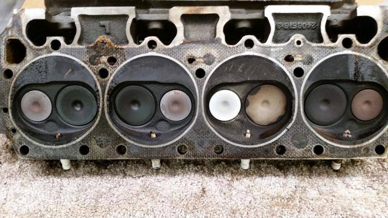

Jan 31, 2015 #1 jake Senior Member Joined Oct 23, 2012 Messages 1,537 Reaction score 1,079 Location wisconsin Is it **** fuel or head gasket leaking? I assume a leak because of the one valve.
Jan 31, 2015 #2 M Mopars & Missiles Well-Known Member Joined Mar 30, 2012 Messages 805 Reaction score 1,191 Location USA Extremely rare, special order, one year only albino valve. :yaayy:
Jan 31, 2015 #3 jake Senior Member Joined Oct 23, 2012 Messages 1,537 Reaction score 1,079 Location wisconsin Aint she a beaut!!!
Jan 31, 2015 #4 commando1 Old Man with a Hat Joined Mar 10, 2011 Messages 37,381 Reaction score 38,546 Location Sebring, Florida That's ash caused by oil due to a bad ring(s).
Feb 1, 2015 #5 Knebel Senior Member Joined Mar 21, 2013 Messages 1,538 Reaction score 581 Location Beaverton, Oregon Portstealing. That one cylinder runs a little leaner than the others..
Feb 1, 2015 #6 Big_John Illegitimi non carborundum FCBO Gold Member Joined May 21, 2013 Messages 20,603 Reaction score 30,472 Location Marcellus, NY I'd say that cylinder was lean. The intake valve and spark plug are also light.
Feb 1, 2015 #7 Knebel Senior Member Joined Mar 21, 2013 Messages 1,538 Reaction score 581 Location Beaverton, Oregon And that could be the result of so many things, vatiation in combustion chamber ccm, vacuum leak, worn out valve guides or seats, worn rockers ect ect.
