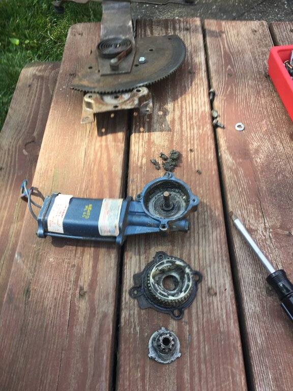

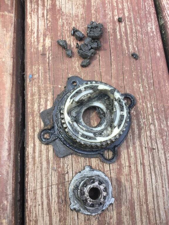

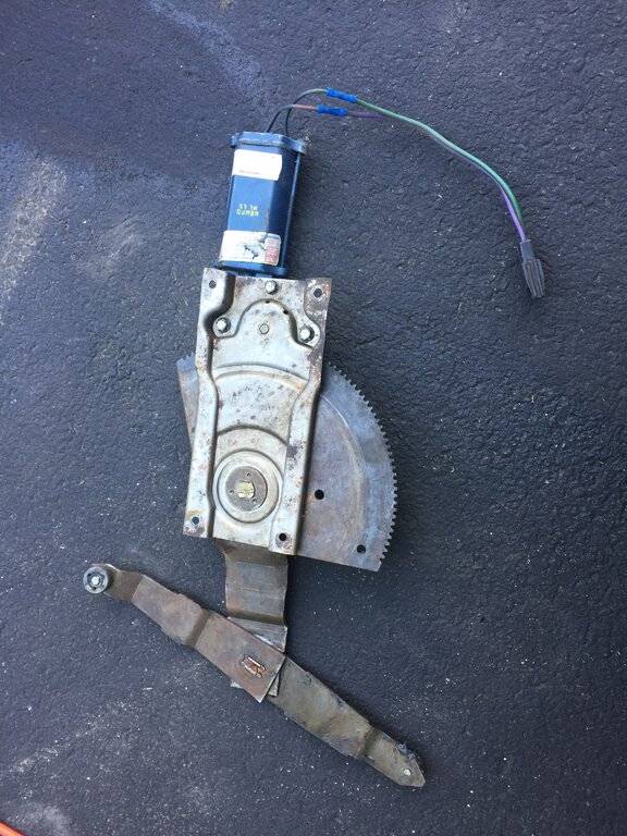

Had a simulator issue with my 77 drivers door, but it turned out to be the regulator gear inside the motor housing, it’s plastic. It was destroyed. All the other windows work fine, they do bind a bit going up and down, but that’s for an adjustment later on. Pulled the window regulator and motor from the drivers door did a clean up and rebuild, works fine now. As mentioned above, there are later years of motors that may work. You’ll just need to probably cut the plug off of your motor and add it to the newer one. Or if you’re going to rebuild your existing, no need for the aforementioned.
