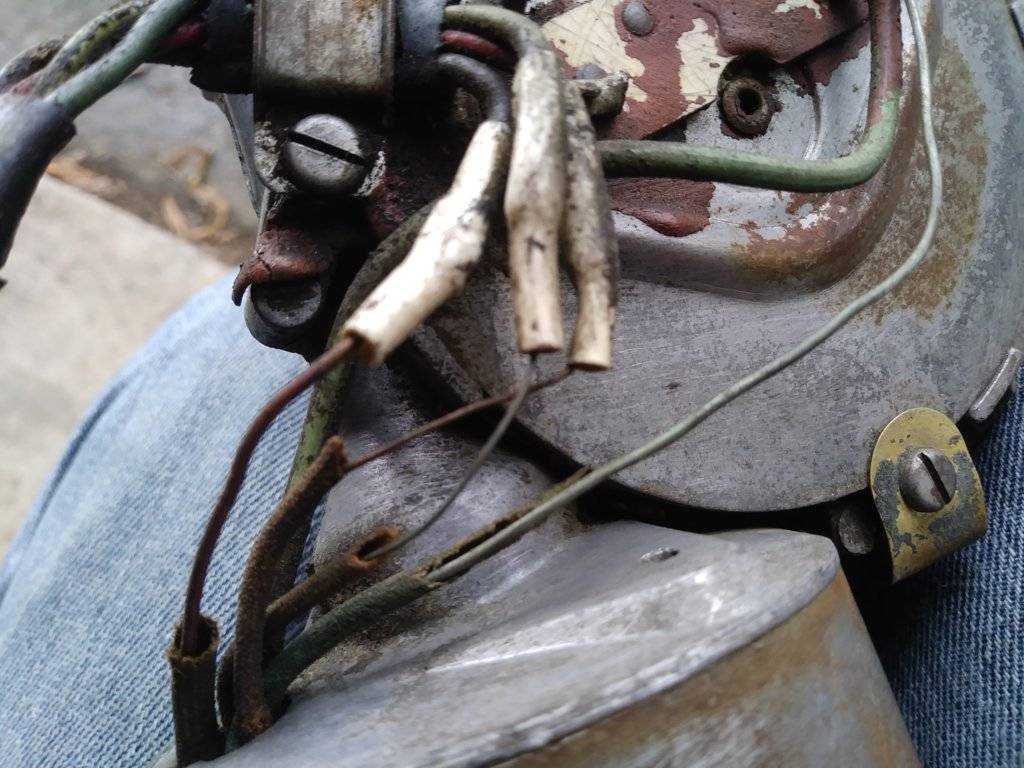

1. swisherred
    swisherred Well-Known Member
    Messages:
    856
    Likes Received:
    417
    Joined:
    Jan 19, 2016
    Location:
    winston salem, nc
    So my three speed wiper motor had three wires coming out of the motor that are soldered to the harness. The insulation on them is rotted away leaving them bare...it works but does anyone have any info on taking the motor apart so I can reinsulate them correctly?

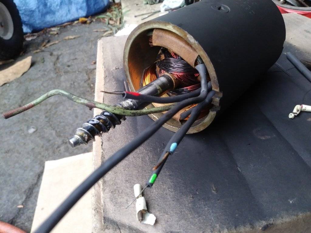

  6. swisherred
    Messages:
    856
    Likes Received:
    417
    Joined:
    Jan 19, 2016
    Location:
    winston salem, nc
    Hell....I took it apart anyway. It was dirty and the wires needed heat shrink into the case....almost back together. Just have to solder the wires together again. Wasn't bad.

  7. swisherred
    Messages:
    856
    Likes Received:
    417
    Joined:
    Jan 19, 2016
    Location:
    winston salem, nc
    I took the time to strip the case and paint it, polish the stator drum contacts and regrease the whole thing. I will post pics when I get the wires terminated.

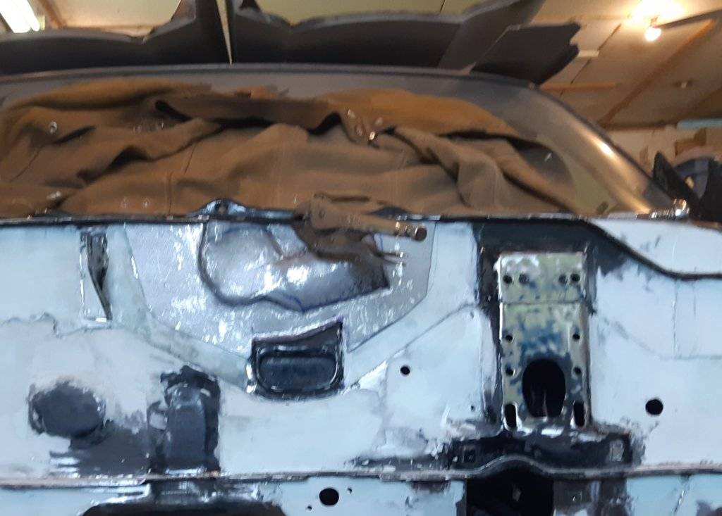

  8. swisherred
    Messages:
    856
    Likes Received:
    417
    Joined:
    Jan 19, 2016
    Location:
    winston salem, nc
    Some pics
  9. swisherred
    Messages:
    856
    Likes Received:
    417
    Joined:
    Jan 19, 2016
    Location:
    winston salem, nc
    Installed.
