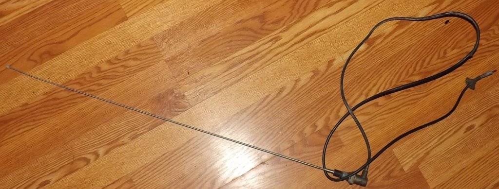

I haven't done anything with the dash at all, it is sitting on a table still fully assembled, the last two weeks I have done nothing at all, oh and here is a pic of that antenna you want. It is in good overall condition and only needs to be mounted in your car.
Thanks for the pic. I definitely want the antenna. It's a matter of when we can get together to make a parts exchange.

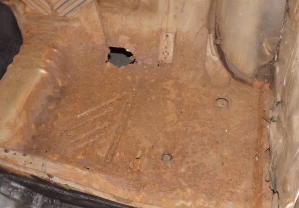

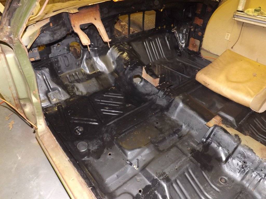

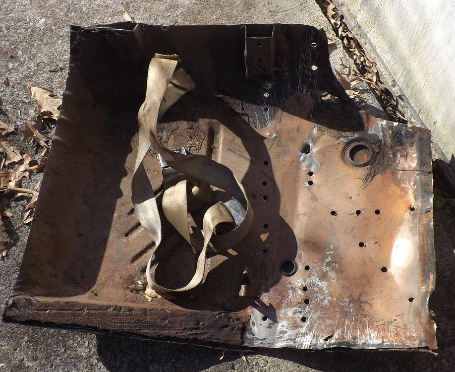

I started sealing the floor after all the new pans went in and went to take the rear seat belts out bolted through the floor, well that didn't go well as the floor gave way around the mount. I have decided to replace that entire pan section with one out of the 69 300 sedan which is mint. So today a bit of warmer weather saw me cutting and drilling etc. I also coated the rest of the floor too as well as the firewall internally. This was all after I helped the neighbor concrete his car park area.
Yes this has been an odd car from the start.
