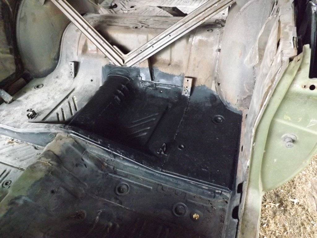

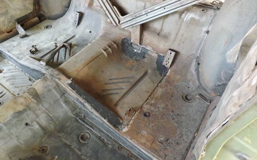

I started sealing the floor after all the new pans went in and went to take the rear seat belts out bolted through the floor, well that didn't go well as the floor gave way around the mount. I have decided to replace that entire pan section with one out of the 69 300 sedan which is mint. So today a bit of warmer weather saw me cutting and drilling etc. I also coated the rest of the floor too as well as the firewall internally. This was all after I helped the neighbor concrete his car park area.

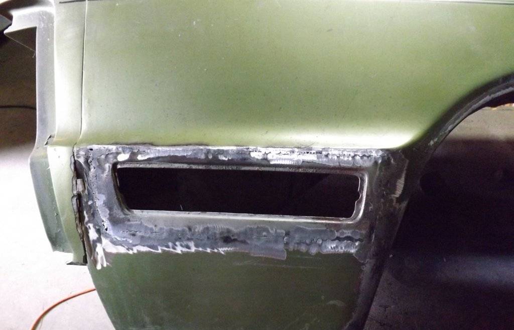

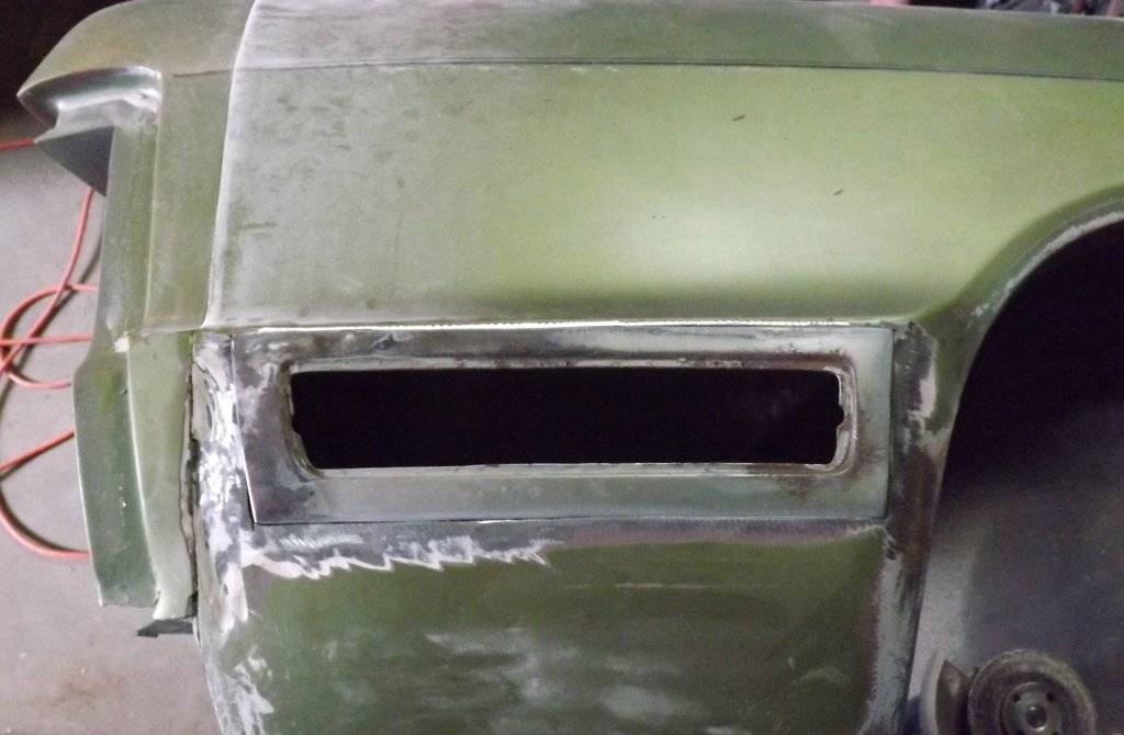

A warm day and I did some work today, check the picks, I think I have gotten the welding work done on the car finally. PHEW!!

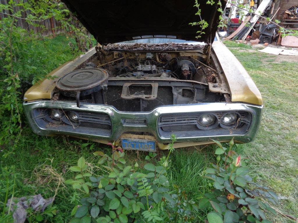

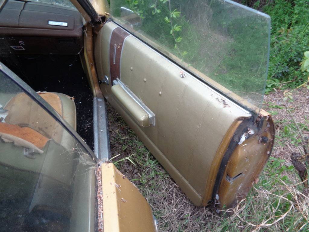

True, we can't save them all but this one appears to have a pretty solid body, which is something that most of the country has a hard time finding. Humor me and clean it up, take better photos and see if someone will buy it as is before you take it apart.
well you guys have a point there , it is a solid car . so i was at my tranny guys shop last night . told him about the 72 fury 3 . now hes thinking on building it for a driver , so it just might get pulled from the axemen (me) . after all it just some parts i want . they can come some another source . or this one and he can replace them on it .

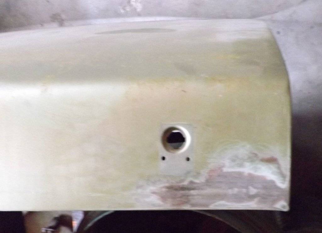

Okay it has been a year since I purchased this car and it has been sitting idle way too long. This is what happens when you have too many cars and so on. Anyway, on to the car, the body is almost ready for primer, hope to have that done in a couple of days. Will post pics of that when it is done.

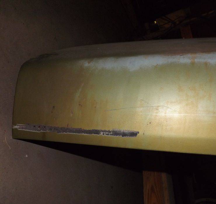

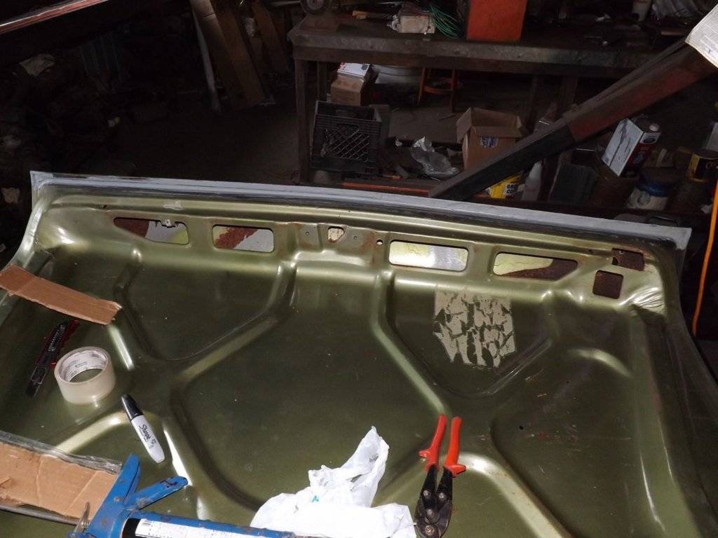

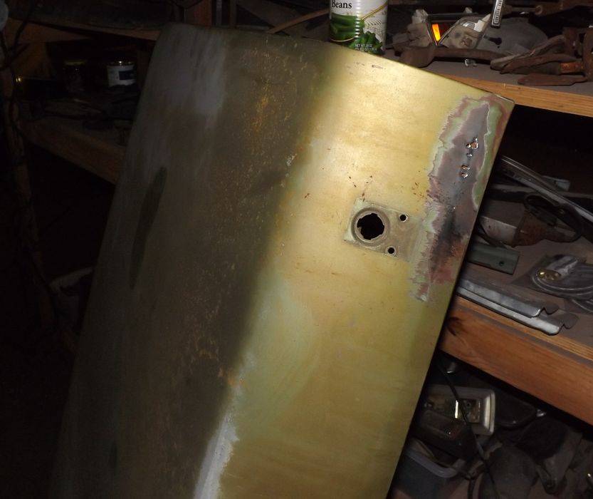

I have also been working on parts too. The first photos are of the trunk lid, it had a couple of pin holes at the outer edges and i decided not to weld them up. I am using a product called DEVCON metal putty, this stuff I have used before to repair corroded forgings in the air frames of aircraft to make them airworthy again. So it is very strong stuff, I backed the pinholes with tape then mixed some and laid it in, once hard i sanded it off with 36 grit paper, which took me over five minutes of sanding to do, as I said this stuff is very strong. Lat picture is of paintable sealer on the inside edge.
