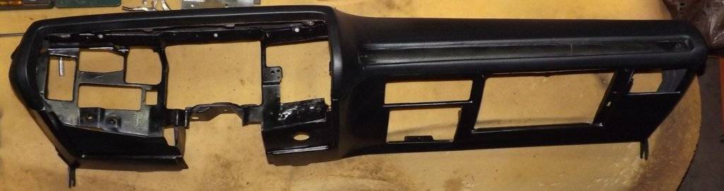

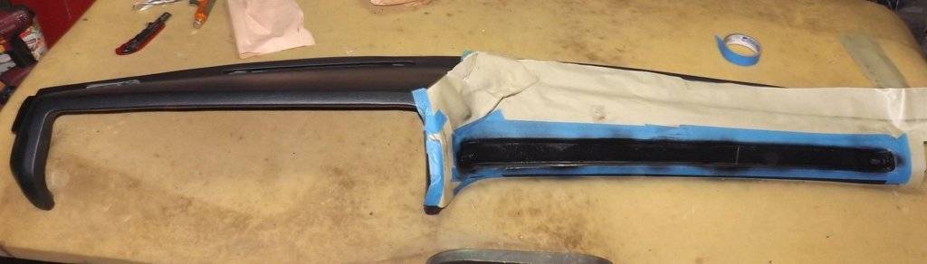

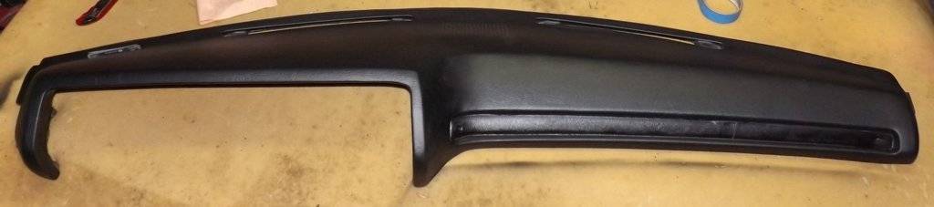

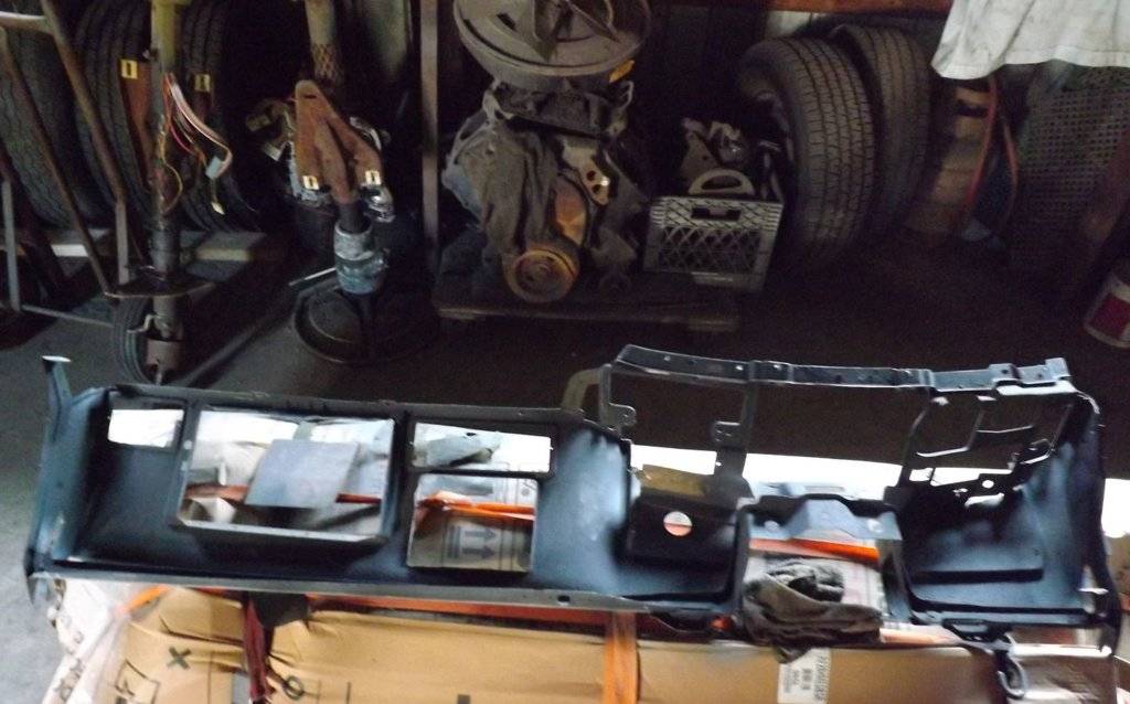

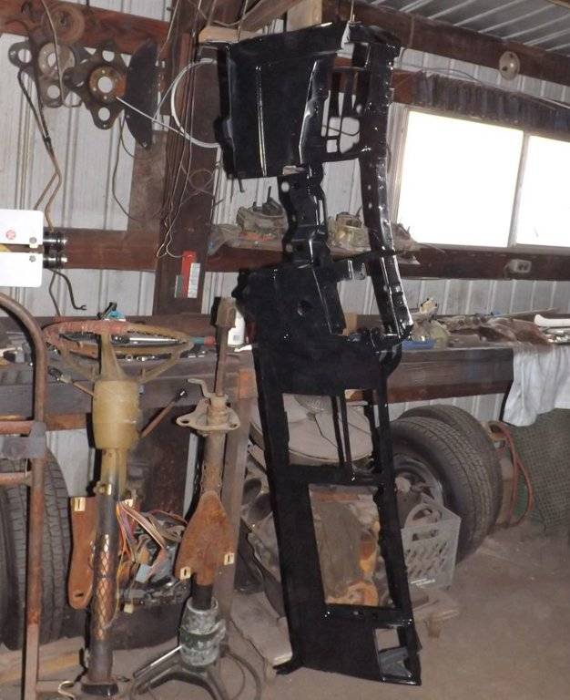

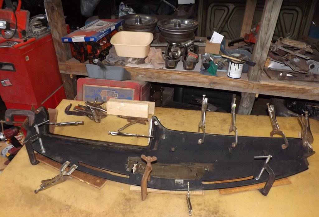

    Okay a bit more work, I decided to disassemble the dash assy and start working on that. I painted the back of the dash frame and dash pad after running a wire brush over it. I used Eastwood rust encapsulator to seal the bare metal. Then I test fitted the dash cap over the old pad before gluing it in place, the pic shows the test fit stage. Dash frame painted in semi gloss black, looks pretty.

    That came out nice!

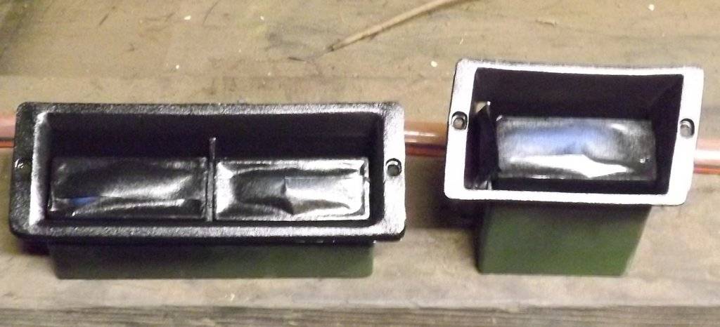

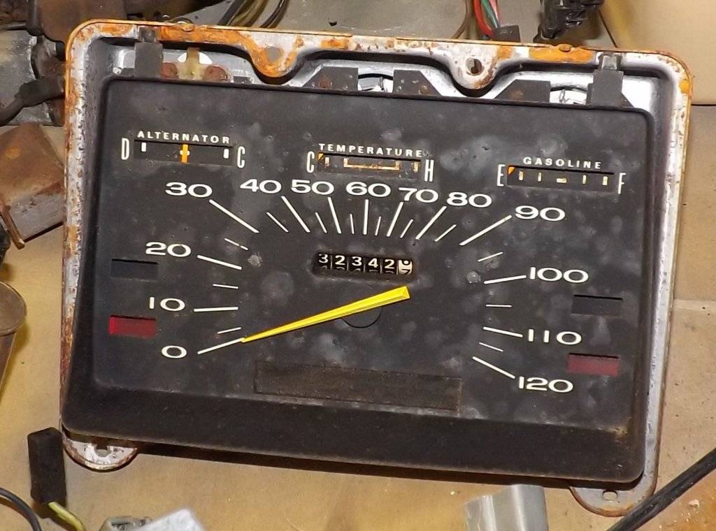

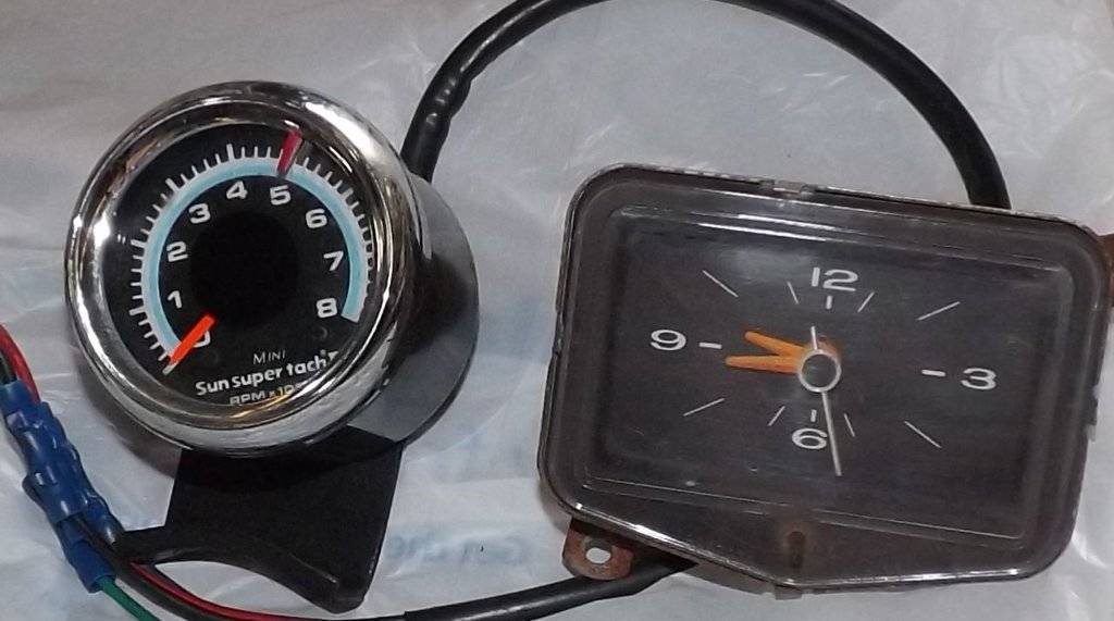

    Okay, the pad glued nicely into the dash cap, I had to touch up the area where the wood grain strip goes in as this area is exposed and was the original green of the pad. Then I mounted the frame to the dash pad, looks good even if I do say so myself. I also went through all the other parts, painting the glove box lid ashtray etc. Then I inspected the speedometer face, it doesn't look good. I did have one of these n much better condition but sold it a long time ago thinking I wouldn't get myself another fury. Blah, now if only I could remember who I sold it to...
    On another note, the clock is out and doesn't appear to be operational, but I do have this nice tachometer that could be converted?

    If you can make the tach fit, DO IT. The dash looks great

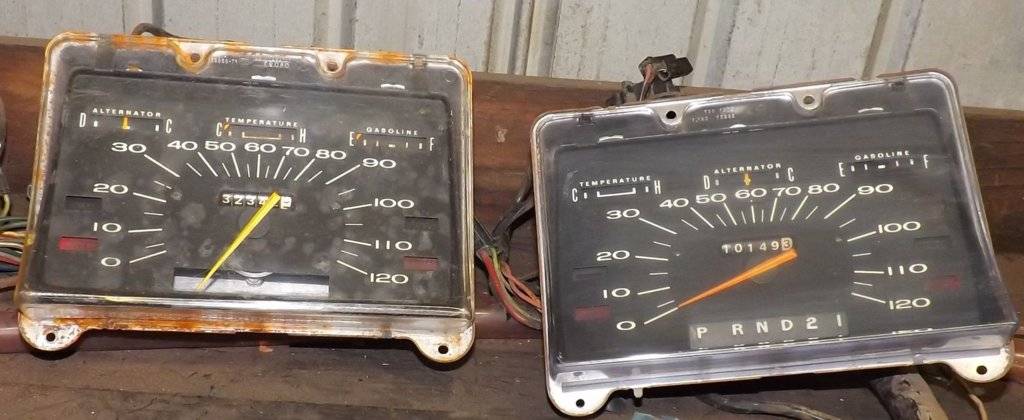

    So the storm passed and I pulled my 73 cluster out and put it next to my partially disassembled 70 cluster, apart from the gear selector display, there is a difference, can you pick it?
  16. C Body Bob
    C Body Bob Old Man with a Hat FCBO Gold Member
    Messages:
    12,456
    Likes Received:
    12226
    Joined:
    Apr 8, 2012
    Location:
    Youngsville, NC
    Alt & temp are switched

    Makes you wonder why doesn't it?

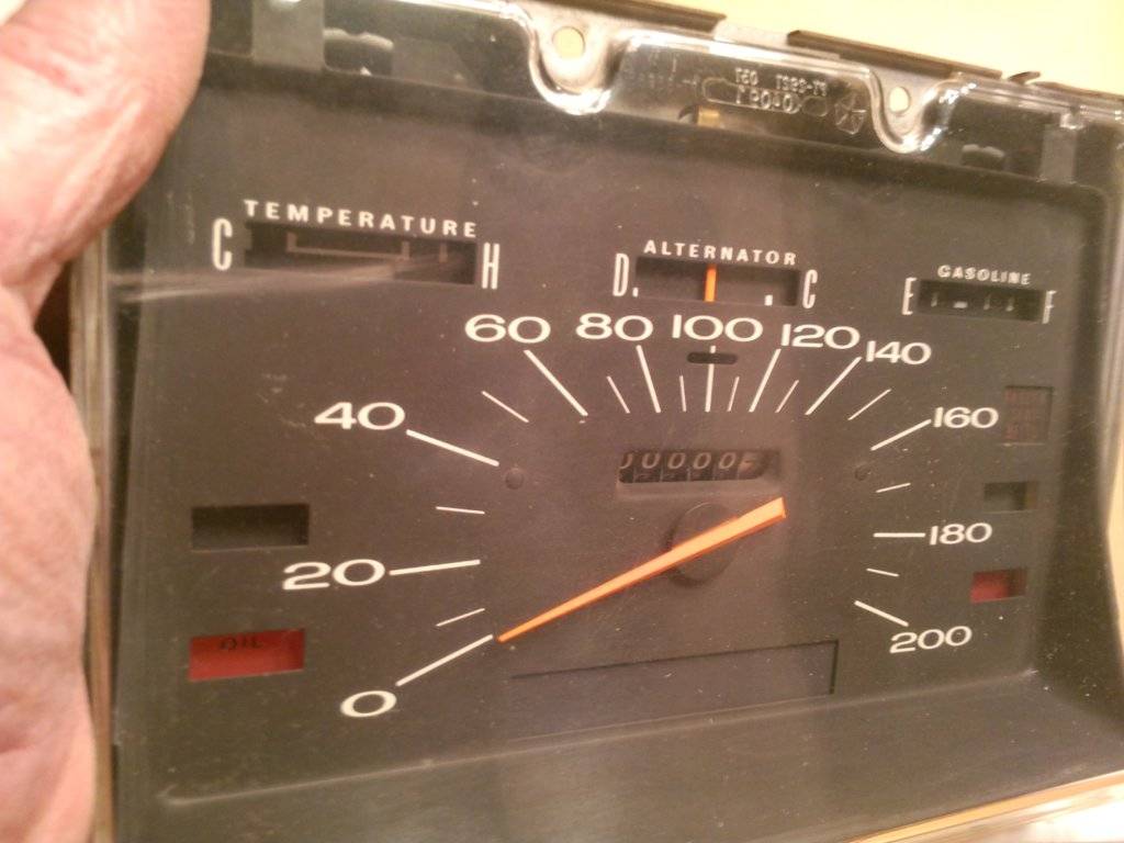

    I think the 70 speedo was a single year product. I put an European speedo for a '71 in my '70 and virtually nobody notices the alt-temp swap. There are a bunch of extra idiot lights but i don't use any of them.

    The needle is yellow in one and orange in the other.

    I think the one is faded
