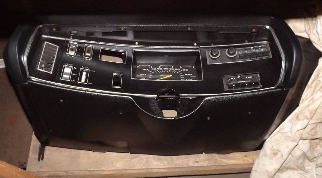

    Okay, the picture doesn't do it justice, the flash of the camera makes it look patchy, but the instrument panel framing is now done.

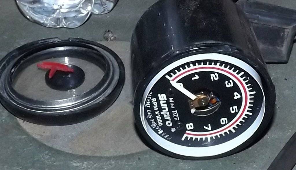

    So I got a sticker from welder guy with the idea of converting a clock into a tach for my dash, as you know I also had a donor SunPro (two of them actually one is a SunSuper)tachometer and i pulled the face off to begin the conversion. Well the Sunpro isn't going to work, the needle isn't set up like the ones in the original. There is no center pin to push a new needle onto. Well, back to the drawing board, I am going to have to guy a tachometer that will do the job. So this little project goes on the back burner for now.

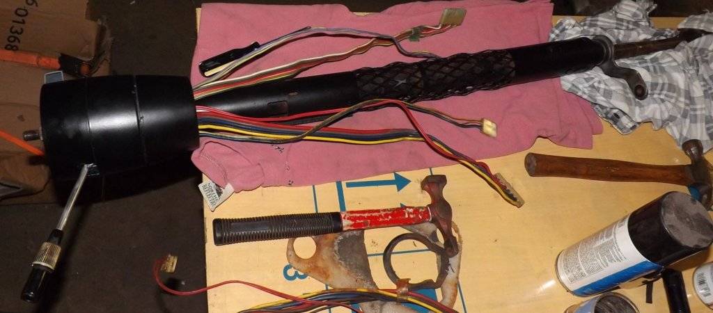

    Okay one more update. I have been working on the steering column and matching parts as I go, working out the best condition ones to put into it. I came across a variation in the turn signal indicator wiring setup. The S23/Sport Fury is different from others as it has three extra wires, checking the service manual I found out it is for the "Cornering Lamps." Most wiring harnesses don't carry it, check the first pic for comparison. Next i slid the ignition wiring harness then the cruise control lever and mini harness making for a total of four plugs hanging out of it so far, it will end up with five.
    Then I assembled the lock mechanism and did final internal assy, was almost finished when I realized I made a big stuff up. I am going to have to take the whole thing apart again, ugh. Can you see what I did?
    Last pic shows a mockup of the instrument cluster assy in place in the dash.
    steering column3.jpg steering column4.jpg steering column5.jpg Dash assy97.jpg

    Okay, bad night but I am totally missing it. Let me in on your mistake please.
  18. Wollfen
    Wollfen Old Man with a Hat
    6,496
    3361
    Jul 18, 2012
    Greenville NC
    The mount plate that bolts to the firewall near the end of the column has to go on before the column shaft slides into the housing.
    • Thanks! Thanks! x 1
  19. 65sporty
    65sporty Old Man with a Hat
    7,084
    1729
    Aug 24, 2013
    Kingston, Mi
    Ok, now I see what you did. Thanks for sharing

    Okay, so I disassembled the column and put it back together again correctly. Here it is, now put into storage too, covered up for when the car is ready for it. Then I puled out the 5 AC boxes I had and picked out a suitable unit which I tested with air pressure as well as hot water. This one passes the test and i will be using it. I will check each of the vacuum canisters too and repair whatever is necessary.
