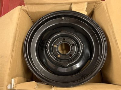

On my 66 Newport (provided I can even get them)?
You would need to know the offset of that rim. I don't see that spec in what you posted. The offset is most important for the front wheels. That rim would almost certainly work for the back wheels.
"Cop Car" wheels. Should work well, just keep the tire width close to the P225/75-15 range. Probably have a 4.0" or 4.25" backspacing, I suspect. Looks like a nice price.
CBODY67
CBODY67
Yeah, that’s an old price. Plus they aren’t available anywhere. Still searching for cop wheels.
You might also consider the '76 Charger SE 15x6.5 Rallye Wheels. Look just like the E-body 15x7s, but are 15x6.5s. Would need the same E-body center caps, though, with trim rings being optional.
CBODY67
Those wheels and cop wheels should be essentially identical other than appearance and either will fit your car without issue. The 15x8 pickup/Ramcharger wheels on the other hand don’t have quite enough backspace and the tire, depending on size, can rub on the skirts.

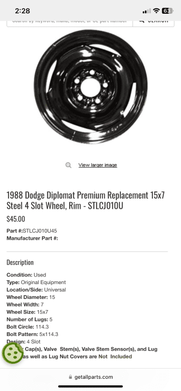

Yeah, I’d keep the poverty caps too, they’re nice looking. I’d like to find a set for mine as I have a set of those diplomat 15x7s that I could paint match. I think it would look sharp in an understated way.
Travis..
You really don' t need 15 x 7. I would think there'd be more available in 15 x 6.5 and you'd have plently of tire choices.

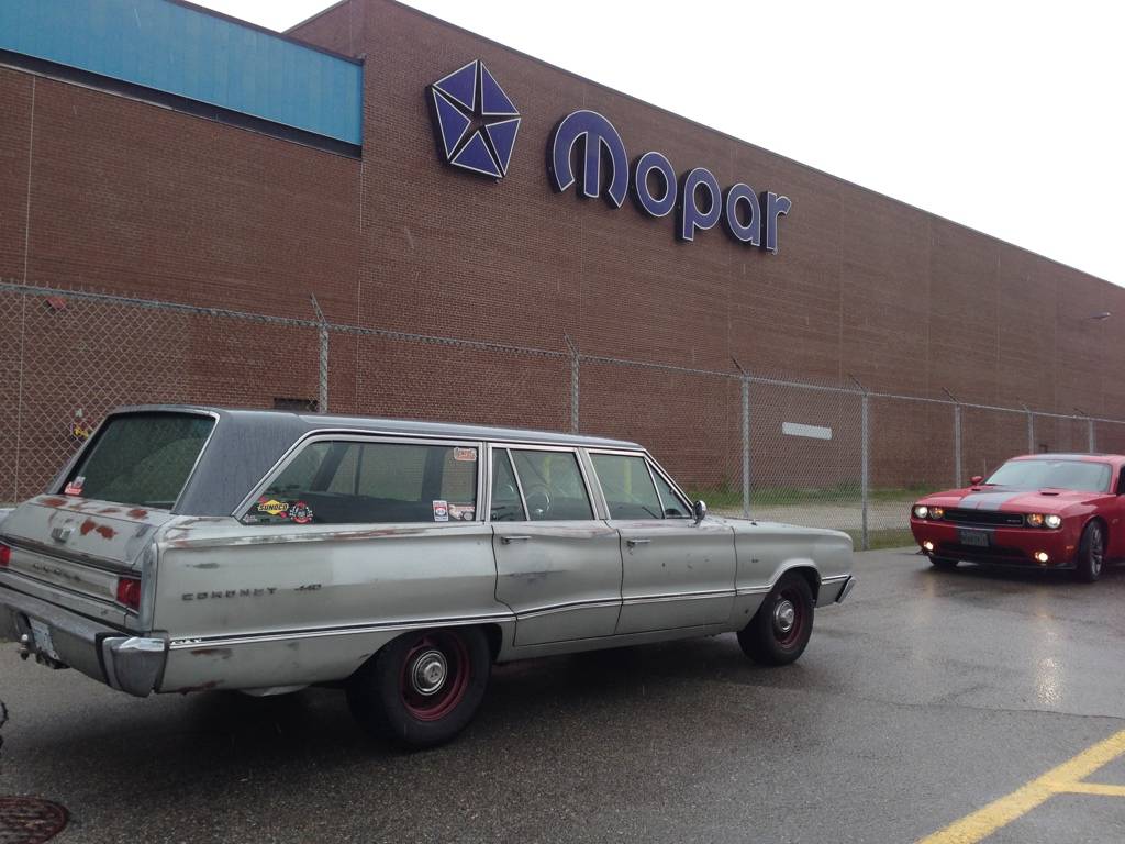

These are the wheels on my '67. We painted them body color as you can see. Looks like they are out of stock at the moment though.
[/URL]
The 15x8s as pictured were on Ramchargers, as I recall. A car club friend got some of the factory 15x8s for the back of his '69 Super Bee, painted body color like the fronts on his car. Not a correct color, but looked good on his car.
As for the Rallyes, I was not impressed with them back then, only in the 15x7 size on E-bodies back then. UNTIL I found a set in the salvage yard. THEN I re-discovered they were 15x6.5s. As they were not specifically tied to a "muscle car", they cost the same as any other steel wheel. To me, the E-body centers look much better than what those wheels came with back then, which was similar to the 14x5.5" Rallyes which came on '73 'Cuda 340s from the factory.
