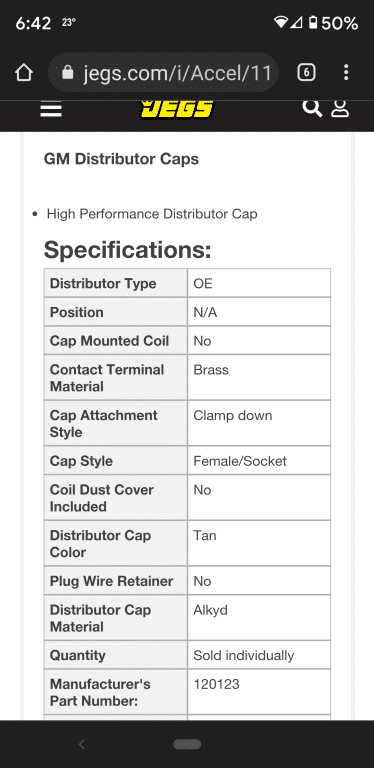

Buy one for a 57 Chevy that's what is based on. Summit had them, but no rotors. That was a while back.

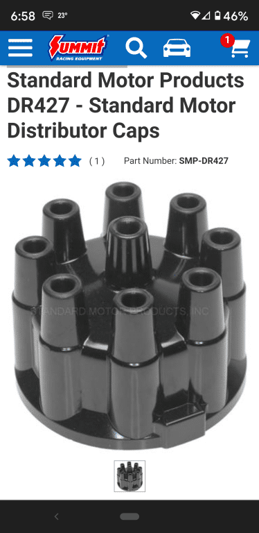

If you have a #37300 accel dual point distributor, it uses a stock mopar cap and rotor, same as the ones on a Prestolite dual point used on many RB mopars.

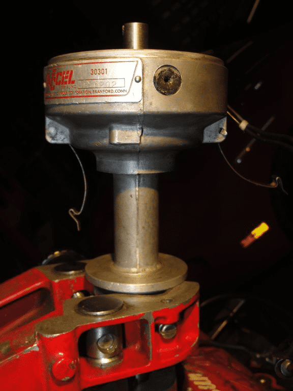

this is what i have, what cap and rotor?
I have one similar to this. Mine had a square shouldered O ring between the cap and the distributor body-My brother lost it, now the cap does not fit tight on the distributor. I seen where somewhere it was mentioned that the later units were made without that thin O ring. I had also seen where 57 Chevy stuff fits.

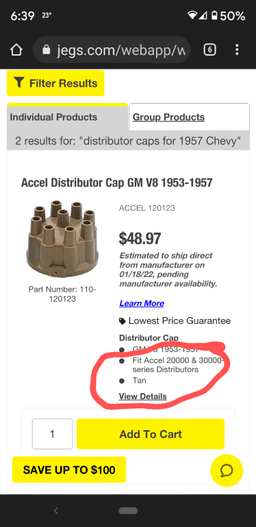

The 30300 is for RB and Hemi.
The 30301 is for SB.
The 30302 is for B, low deck BB.
They all use a clamp down cap that is a original cap for a ~1957 Chevrolet all V8s if memory serves.
Thank-you, halifhops has measured the shaft and it is RB 4" long, apparently someone has changed the shaft
