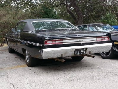

Here's a pic of its butt end with new 1968 original issue TX plates. I know the tailpipes look crappy; I will replace the whole system including new "Mopar hook" pipes as soon as I can.

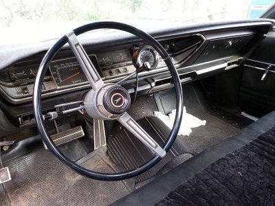

Here's the interior. The dash is fine, that's just a thick piece of cloth to protect it from the sun while it's sitting outside the shop. Please don't give me any crap about the tach! I put it in when I was 15. I may take that out soon. At least when I put it in I just used an existing trim screw, so there are no holes other than factory ones in the dash. The front seat is beat up and cracked; what you can see there is 22-year-old, faded, mouse-eaten JC Whitney velour (!). The back seat is in good shape.

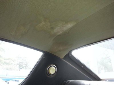

Now for the question: would you say this is from a water leak or a possible mouse nest up under the headliner? I don't see anything on the outside of the top there. There have been other mouse nests under the seats and in the heat ducts (good lord, it smells horrific in the Texas heat; it's already 80 degrees here!). If it's a mouse nest, should I try to carefully peel the headliner down in that area so I can vacuum all the crap out, and then how would I reattach without f-ing up the headliner, which is otherwise in ok shape? Use a razor blade to pop some stitches and try to re-stitch? Make a discreet cut along the edge, clean out, then glue back in place?
Right now my gut says clean it as thoroughly as possible without opening it up and try to deodorize as best as I can. I've ordered some CSI-type corpse-stink remover so we'll see...

Nice looking ride, don't ever be ashamed of anything you put on or into your car if that is what you wanted. Keep it up and more pics of the car!!!! Looks to me like water, but I am far from an expert.
Nice Ride !!! :3gears: what Tach ????.... :poke:...........:oops:
It looks like water, however mouse pee is also essentially water. Is the roof over that area feel crunchy under the vinyl top ? I have a very similar looking stain in my F350 but it is from a leaky gasket at the third brake light / cargo light unit.
I'll have to get back to the shop in a couple days and feel the roof there, although I'm afraid to...
That's a good point about the mouse pee, never thought about it that way.

That car is sweet and I have nothing bad to say about it. As far as the headliner goes its really not glued in place and I wouldn't try cutting into it. What I would do is carefully remove it if in fact there aren't any holes in your roof. It's held up by metal rods that go from side to side so I would remove all the trim from around the perimeter along with the dope scope. At this point you should be able to take it down by removing the rods from the keepers at either end and take it right out of the car for a gentle cleaning.

What would you suggest for the cleaning? Soft brush with, what, diluted Dr. Bronner's or Simple Green or something? This particular headliner is gray mesh slightly rubbery-feeling stuff. Thanks so much for your tips!!!
Most likely the headliner won't come out in one piece,but I've found using a cleaner called Tuff Stuff,do wonders cleaning vinyl,cloth and headliners.Spray it on and let it foam up for a few minutes but don't let it dry up.Then scrub the area lightly in circular motions with a very fine brush or a toothbrush.I have a 67 NYer fastop and my headliner was glued in around the front and back windows,but there are rods in the center bows that are removable.Worst case scenario.....have a new headliner installed at an upholstery shop,should run somewhere between $200-300.She looks more like a water stain from where it's located,and I doubt the roof is leaking or rotted in that location.Could be due to some moisture getting into the car from an open window,someone's wet shoes,etc. and then being sealed inside and evaporate due to heat condensation,which explains the stain on the headliner.I once had that happen to a trunk lid on an old t-bird.When we got the trunk open,the entire inner frame structure rotted and separated from the trunk skin.The skin's appearance from the exterior was perfect.Heat and water don't seem to mix well in enclosed areas!
I've had good luck on a couple of occasions removing headliners without causing them any damage, slow and steady. The suggestion stands if you had something nesting up there and can't get rid of the stink.
I would ether use a stain remover with the understanding that it may leave a discoloration spot there, It may remove the stain. But could also leave a bleached looking spot. Or rip out and purchase a new one as time, and money allows. I have had no headliner in my car since I bought it in 2007. The owner before me pulled it. It doesn't bother me not having one. But then again I have a white painted roof so its not hot in the summer time. :)

I'm going to do my best to keep the factory headliner as long as I can and just clean it for now. It really is in good shape except for that spot.
