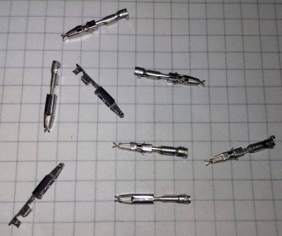

You can buy the connectors separately.
Like these for example from my VW..

the missing wires are probably for features that are not included!?
You can remove the connectors with cables from the old piece. It's a pain in the *** to remove these connectors but that would be the easiest way, I guess?!
