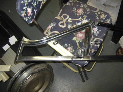

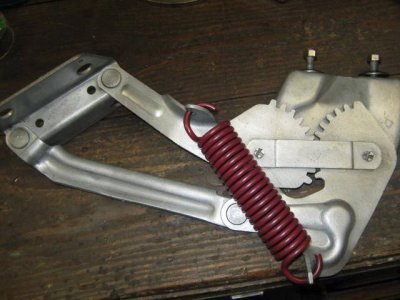

Worked on hood hinge assemblies and the vent window assemblies this weekend. Fortunately the rubber seals around the vent windows were in great condition. Still very pliable and made a good seal around the glass and the frame. Installed new division bar window channel and they are now ready for re-install after the car is painted. The hood hinges were in very good condition as well, so just a clean-up and they are ready for re-install as well.

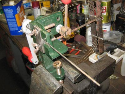

Rainy day down here so I decided to make a spring for the door opening handle. The old had broken and the handle would rattle. Seems like about 20 years ago a pal gave me a spring winding setup so I put it to use. All is good now, plus we got a really good soaking rain which we really needed.

I had an e-mail about the spring winder I used to make the replacement door handle spring, so I thought I would post a few pictures of it. It is called a Porter Spring Winder, model P-2 and came with mandrels for making springs 1/8" to 1-1/4" diameter in 1/16" increments. You can make either right hand or left hand wound springs, either compression type or torsion type.
