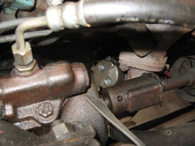

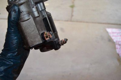

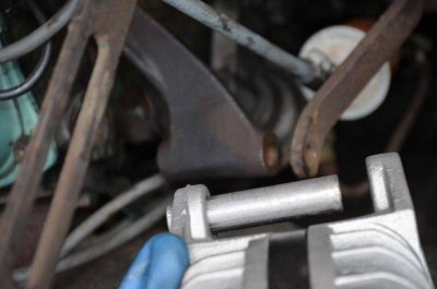

When reading up on the new starter, there was some discussion that it didn't fit, and would need to be trimmed. As it turns out that wasn't quite necessary. If you look at the bottom of the unit, you can see that the connection posts have a Z-shaped connector on them to move the connections and offset them from the body. It turns out that this is what contacts the block. These can be removed, and then the starter fits.
The problem is that when you install the starter, those posts are on top of the starter, and not accessible from the side or bottom. So you need to do it by feel, and not lose any of the nuts into the crotch between the solenoid and the motor. Or if you do, you will need a mirror and a flexible magnet to fish them out (yes, I said 'them').
Since someone makes an offset for these already, someone should make another offset so that it will work on a 440. I'd pay a premium for one of those.

When I got back to it, I could see that the cables were the starter cable, the charging wire, which peeled off after 6", and the solenoid wire which came into the bundle where the charging wire peeled off. To my inexperienced eye, it looked like the original wrapping. Fabric, with no real insulating properties (not that it needed it).
I cut the fabric casing and separated the cables.
View attachment 36122View attachment 36123
No real pictures of me trying to get the nuts in place, but it took about an hour and a half. The wires were just long enough to fit, because the posts were rotated a few inches further away from the original location. If I were making a cable from scratch, I'd add another 4" of length.
I don't know if you can really tell, but I held the camera and pointed up. This shows what you can see of the starter. That's the driver's torsion bar, transmission and linkage. You need to thread your arms up through there and get each nut on with one finger from each hand. Luckily there is room to swing a shorty wrench. Open end works on the starter, and box on the solenoid.

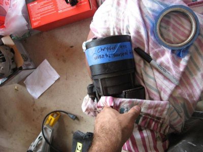

After that, I snapped the little plastic keepers back in place and cleaned up. Since both the starter and alternator work (alt just a little lazy at idle), I kept them, and marked them for future reference.
I don't know why, but I did. Maybe someone from the board will be stranded in San Diego with a bad starter, all the parts stores will be closed, and a free used starter will get him back on the road.
Or I'll just end up throwing it away in 20 years.
