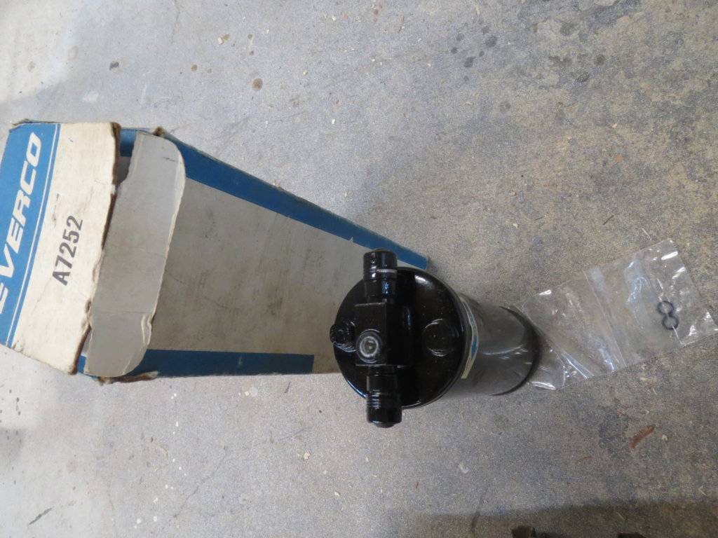

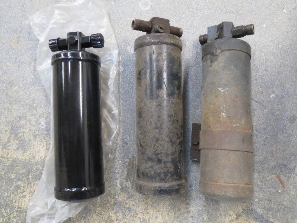

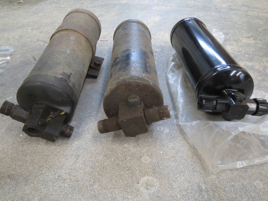

    I don’t really know anything about these but these are available for sale if any of them would work for you. Is there anyway to test the used ones?

    I too have no idea which would work. I think I will purchase generic drier, than have my original refilled if an orginal used is not located. Thanks for your time. Bob

    Cool that you have those!
    While I'm sure you know this, keep in mind that any dryer left uncapped for any length of time other than a few minutes while being installed is rendered effectively non-functional and will require rebuilding/replacement.

    Well the good news is is that the two new units are sealed, thanks for the information. I’m sure the used ones were removed from parts cars over the years.
