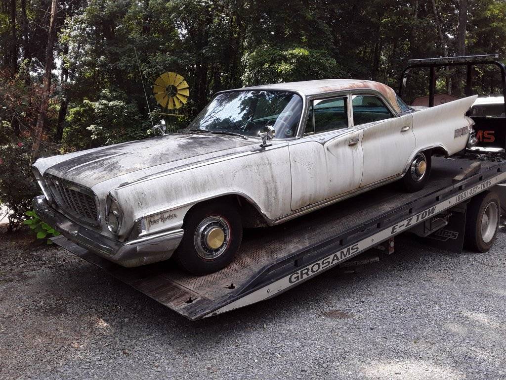

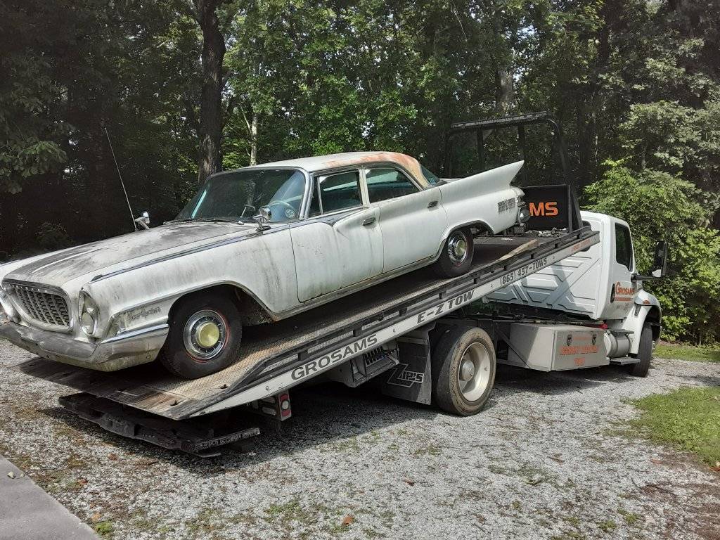

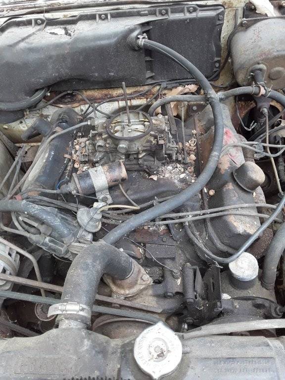

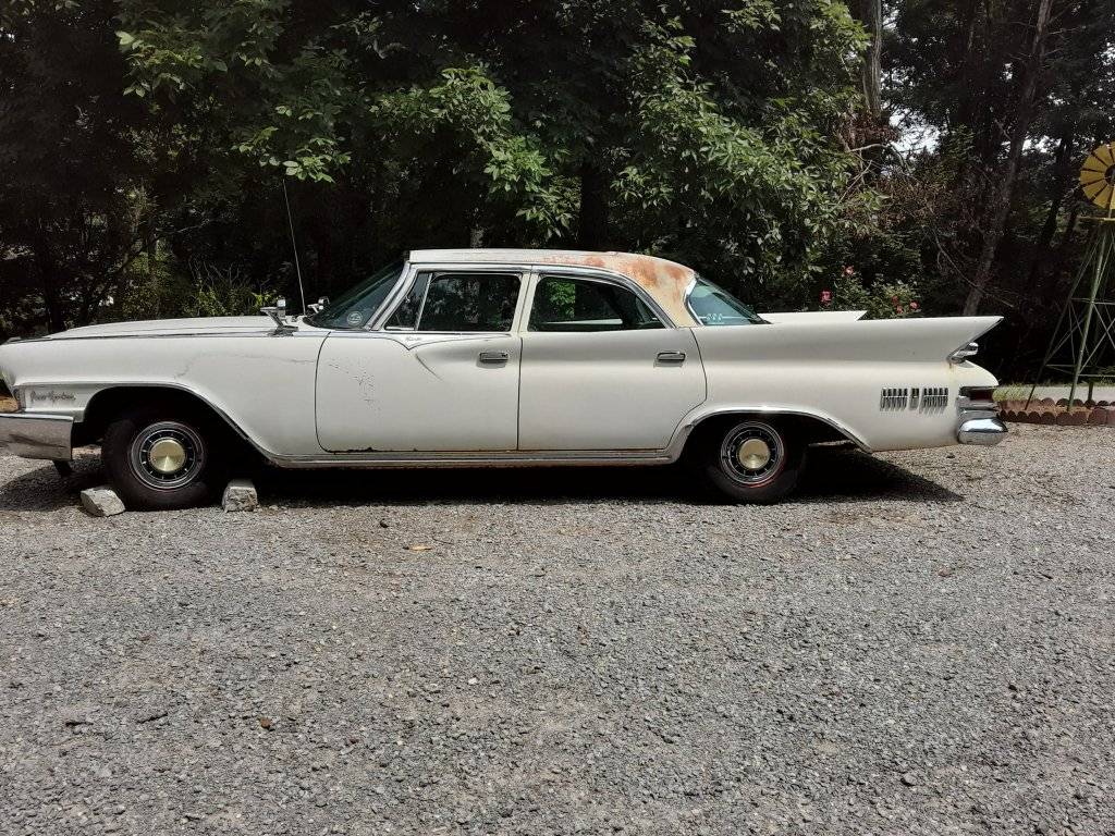

I tried for 20 years to buy this car. It belong to my late aunts mother. It sit in her barn until my late uncle pulled it out and let it sit in his driveway. The tag has a 1995 plate. The deck lid leaked and rotted some of the trunk out near the deck latch. It has the 413 wedge engine. They both passed away a few years a go and it and all they had was left to their grand daughter. She gave it to me. She found the title in a ammo box with the land deeds. I was lucky she did and I found the keys in a can in the garage. I had it pulled home and since I live next door it didn't cost much. Needs complete brakes. The engine was stuck and I soaked it with tranny fluid mixed with diesel fuel and it broke loose. I had the starter and alternator rebuilt and installed a new starter relay. Getting ready to check for spark and going to put new plugs in and see if it starts with starting fluid before I go further. It needs the carb rebuilt and new fuel tank. The water pump is also froze. Only 58 thousand miles on this car. I have cleaned it and power washed it too.

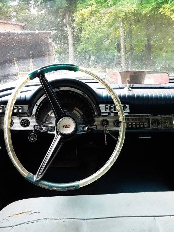

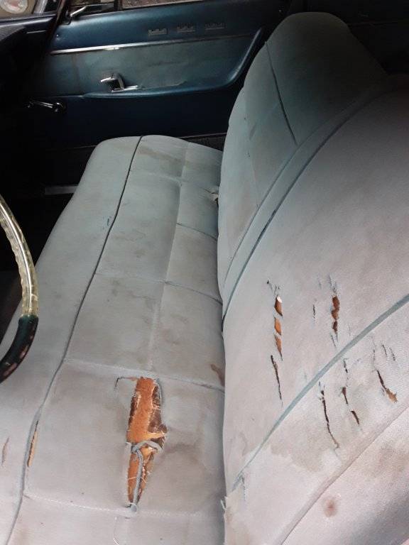

They're great looking cars and I love seeing the engine bay, so simple and easy to work on. Now post some interior pictures.
Disconnect the rubber hose from tank to fuel pump, don’t suck the garbage and pump it into the carb
I did cut the fuel line hose. Got a set of points today but they are the wrong ones and it got hot so I stopped for the day. I will take some of the inside and post them
