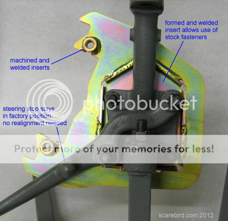

scarebird.com shows this bracket on ebay, works w your spindles but not w 14 inch wheels. may want to ck it out.John.

Thanks, John, Will and Kevin. I'll check out that link and I'm looking at the scarebird products. Your help is appreciated.
