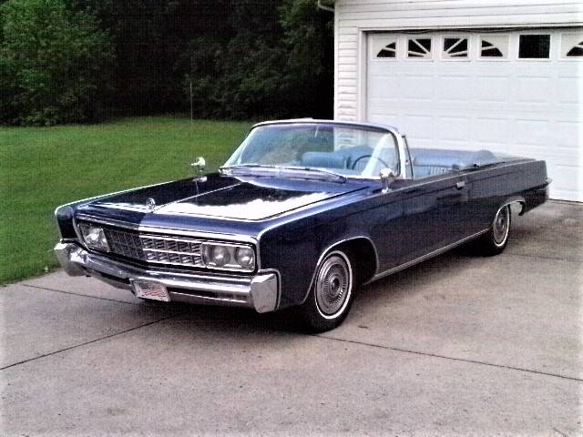

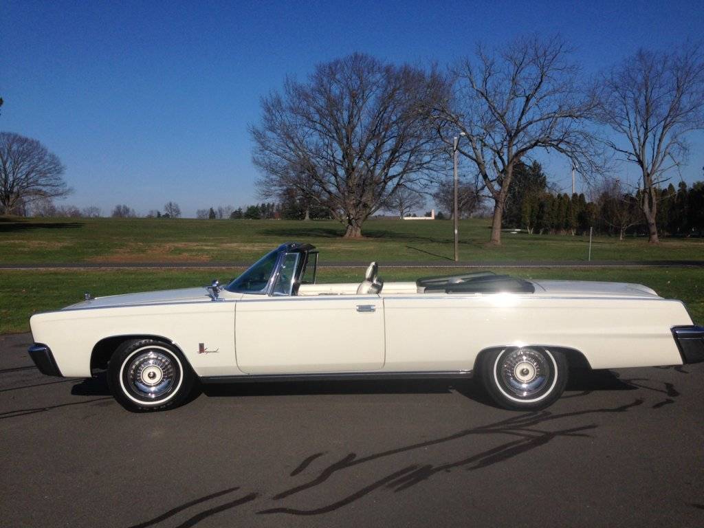

Your Imp is gorgeous! There's something extremely elegant about these 64-65-66 Imps with the top down....absolutely stunning! Yours shows beautifully in its blue! BTW, what tires/size are you running?
Thanks for taking the time!:thankyou:

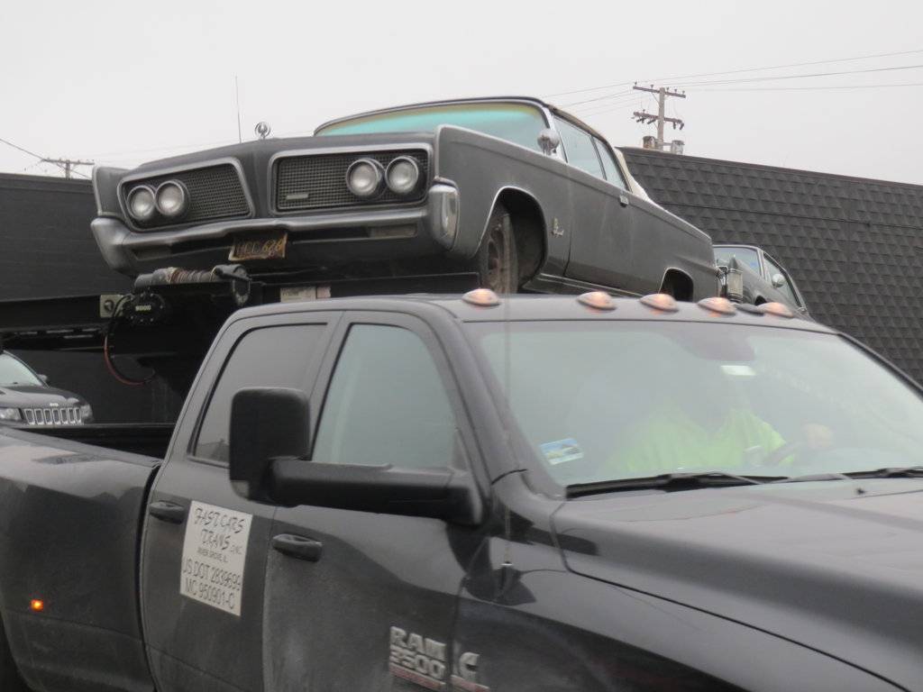

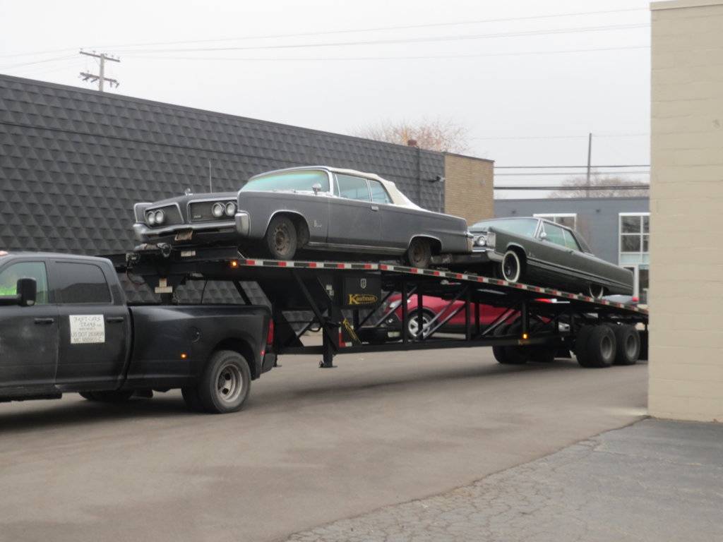

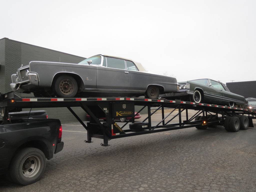

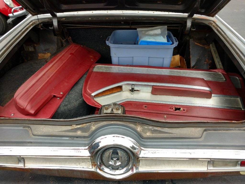

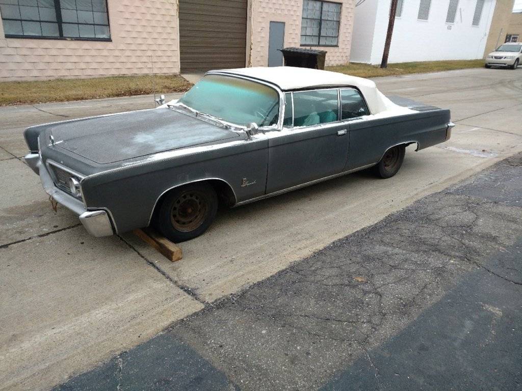

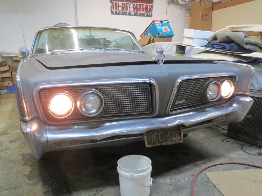

Yes, here’s mine when it arrived in January.
Well I’m not planning a restoration so much as I am just getting it complete and back on the road. It’s patina is consistent front to back and I don’t think I could afford a full on resto for now.
Now you say that! :mad:
View attachment 304654 View attachment 304655 View attachment 304656 View attachment 304657 View attachment 304658 View attachment 304659 View attachment 304660 View attachment 304661
Great shots! Good luck....there seems to be a number of the 64 Imp drop tops out there. They ride beautifully even on the bias ply tires....and it's like sitting in a living room. The 'verts have great seats, thick and supportive. I did my Imp interior to factory specs so it also shows as well as it rides These 5300lb beasts are the best in ride quality and elegance. Last week a '64 Caddy 'vert parked next to me at a local show....the Imp was by far the more interesting and elegant of the cars. The Caddy was done very well, too. I think part of the allure is the relative overall rarity of our converts....

The silver car photographs well but it’s in desperate need of a paint job. Thanks for the kind words though!

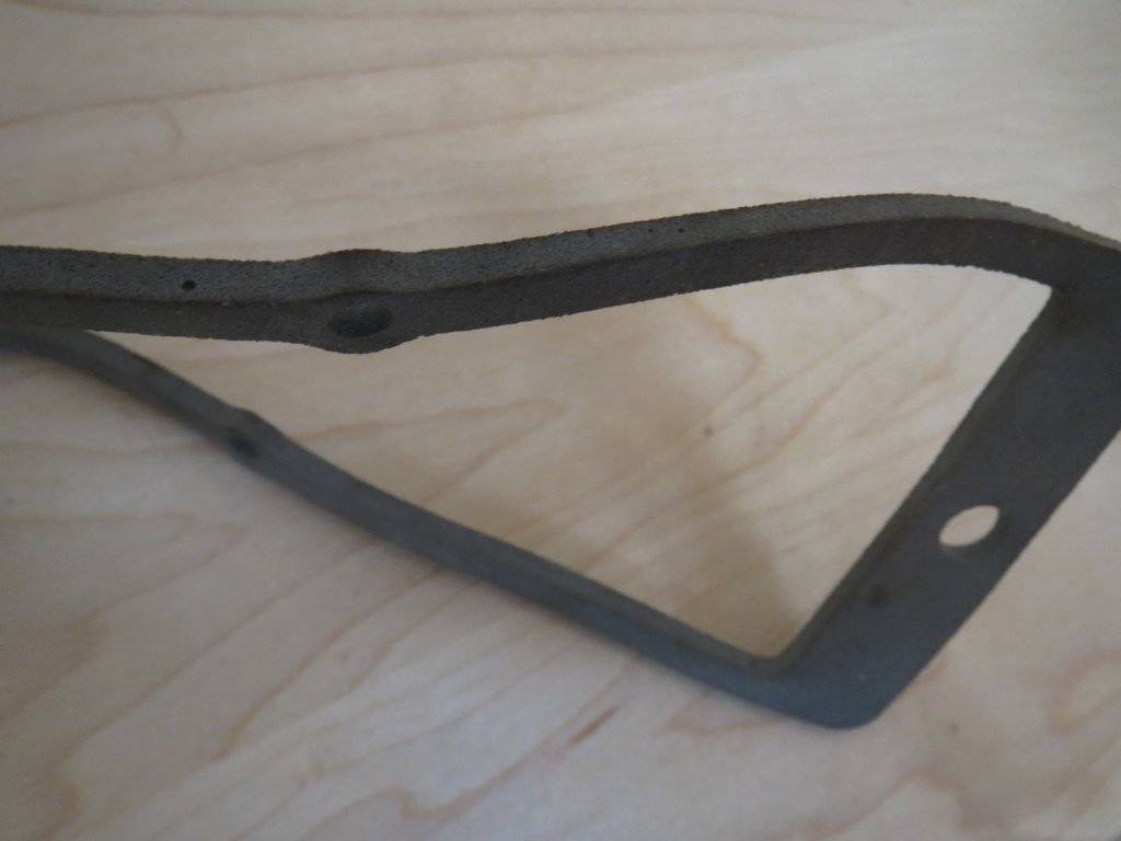

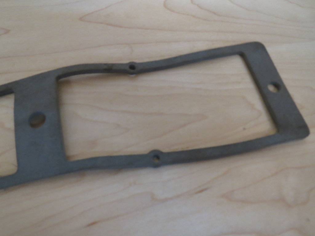

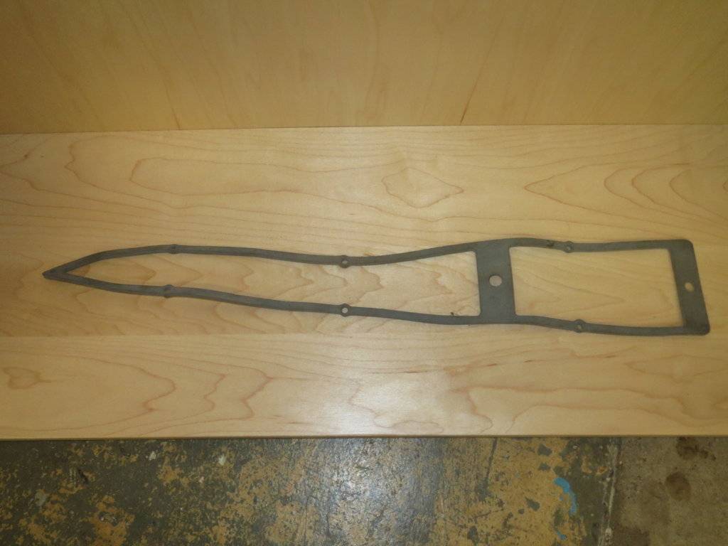

Are the gaskets molded or die cut. If you have a good sample we will consider reproducing.
Dave
Quirey
Dave
Quirey
I have one that’s like brand new if you need a loaner to reproduce new.

Hello Dave, and thanks for the offer. The work of Gary Goers was spectacular and all of us in Mopar restoration land are glad you're carrying his torch! Thanks! Without his work being continued restoring 300 Letter cars, Imperials, Plymouths, DeSotos, and Dodges, just wouldn't be possible. I'm sure I speak for all of us in Mopar Land when I offer a collective sigh of relief knowing that our projects can move forward and that you're so readily able to help with those projects. Restoring any Mopar, especially the C bodies, can be traumatizing without specialized help!:(
On the 64-65-66 Imperial tail light gaskets, mine are dried and essentially "married" to their housings. Years b back I told the restorer not to remove anything consumable items that were not immediate replaceable and that included those back tail light gaskets. Gary did have door handle gaskets and we were able to replace those. It appears from what I can tell that these are die cut where the handle gaskets were rubber molded. I can't get mine off; but they do still seal. Maybe someone else out there can help? I do have a lot of spare parts that came with the car so I'll have to look and see what's around. I will reach out to you if I do find any that can be copied.
Thanks again for the offer, good luck on maintaining the Goers product line.:thumbsup:
bob
If you don’t mind sending that we will make for the imperial owners. Ship to Quirey Quality Design

I sure will as long as I get it and a new set back, yes?
I would love for this to occur....I'm sure there would be loads of us indebted to both your generosity and that of Dave for the company's efforts to repop these things....with appreciation, my friend!
