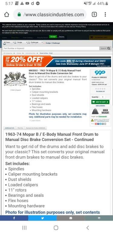

    Hey all. New here and I've learned (after buying ofcourse) that parts for my 1964 300k are actually hard to fine whether it be aftermarket or OEM. But I was wondering if anyone knows if this kit would work on mine. Any advice would be appreciated!

    The B-body and C-body use different lower ball joints and spindles, so I think the answer is probably no. You might try contacting this outfits customer service folks to see if they have done this conversion before, they might know for sure.
