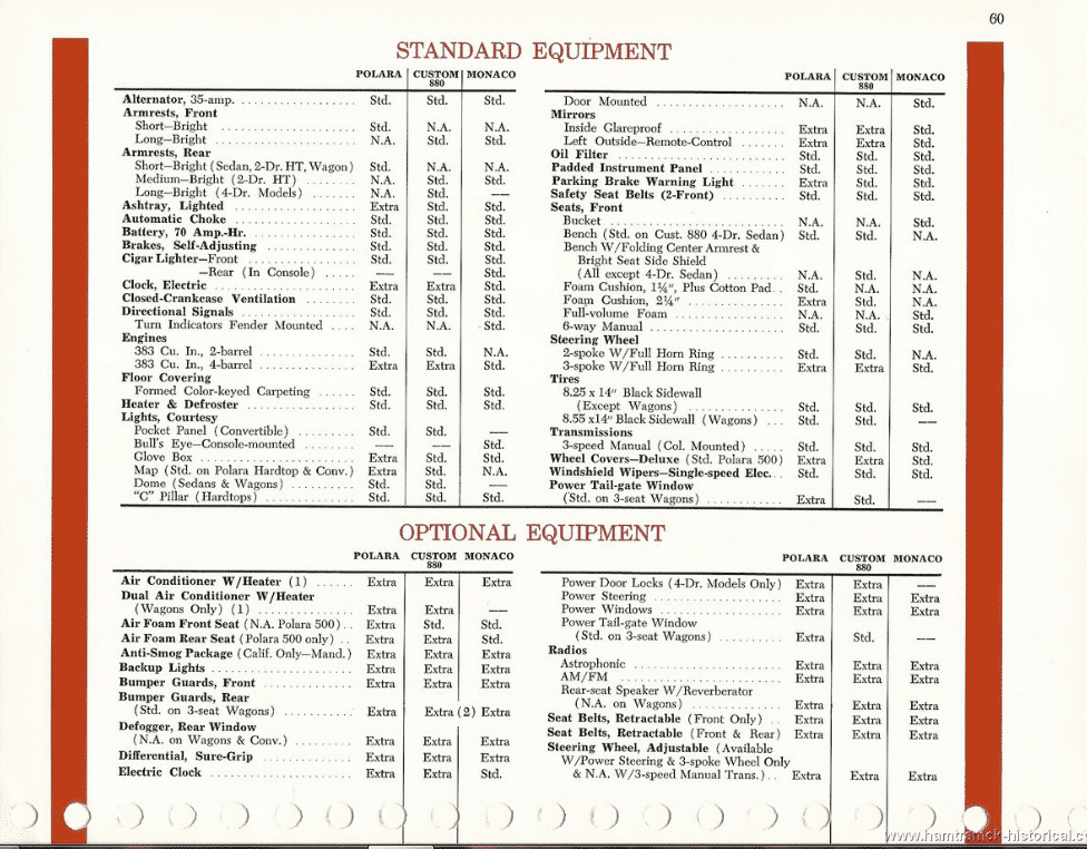

The bumper guards were optional.
As for the ends - are you talking about the gap fillers on the tops?
Awesome this option list helps greatly. Thank You!

The Dealer Data Books are on Hamtramck Historical and contain a wealth of info. The 1970 Hamtramck Registry - 1965 Dodge Dealership Data Book - Monaco & Polara

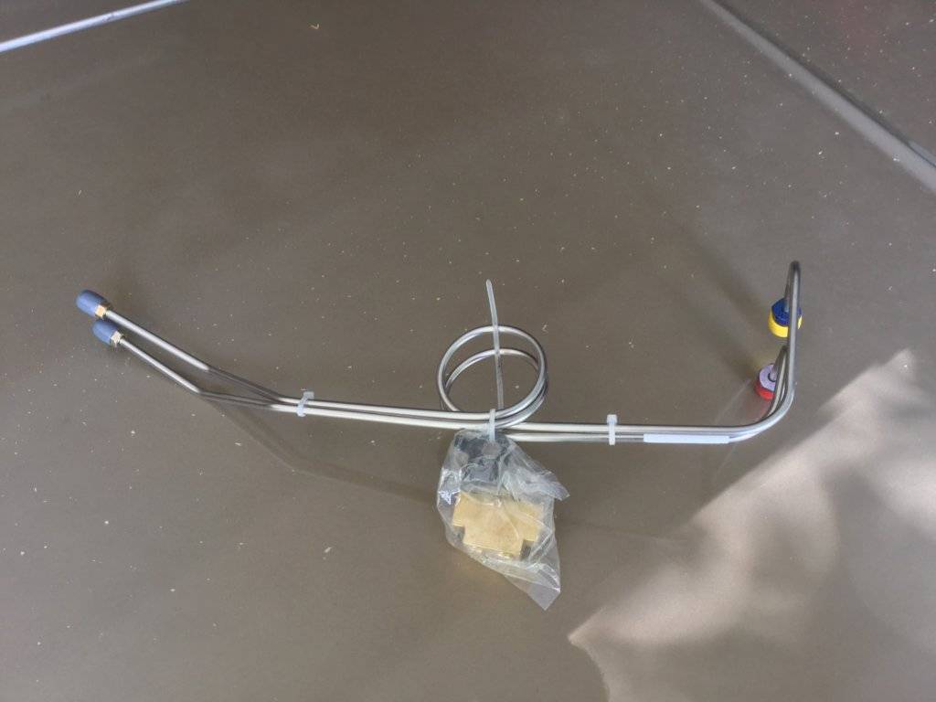

Nice car. I will be faced with brake upgrades on my 66 also. Inline Tube offered a dual master conversion kit with lines and block, not sure if its still available.
The car looks very good! I know you'll enjoy driving it. Plus seeing others admire it, too!
On painting the firewall, unless there was a color change and it isn't "white", repainting might be an option. BUT if the firewall is "white", then I'd suggest a thorough cleaning rather than a repaint. It should be body color and without the constant exposure to UV light and such, you might discover it's still pretty good paint back there. Not unusual for some undercoat overspray on the firewall, either.
You can probably find a repro CertiCard from one of the Mopar restoration vendors. Main thing would be that it's for your model year. Plus for a "Dodge" if they were red rather than the blue Chrysler/Plymouth versions. Get a Dymo Label Maker and put your name and such in there as if you were the first owner, if desired.
Congrats on getting to the point you have!
Enjoy!
CBODY67
@CBODY67 - Interesting info about the certicard - all Canadian Dodge 65/66 certicards I've seen are blue...
Do you know who reproduces the certicards, and do they imprint them with your car's information, and does it look correct? I'd love to know, because the Certicards from my cars are both long gone... :(
Thanks for the advice on the dual m/c.
Is the distribution block different on the fwd drivers frame for a dual m/c setup?
Also, have given this alot of thought. I like originality too but safety is a big topic as well.
The distribution blocks are different. You can get the newer one, or install an adjustable proportioning valve in the rear line.

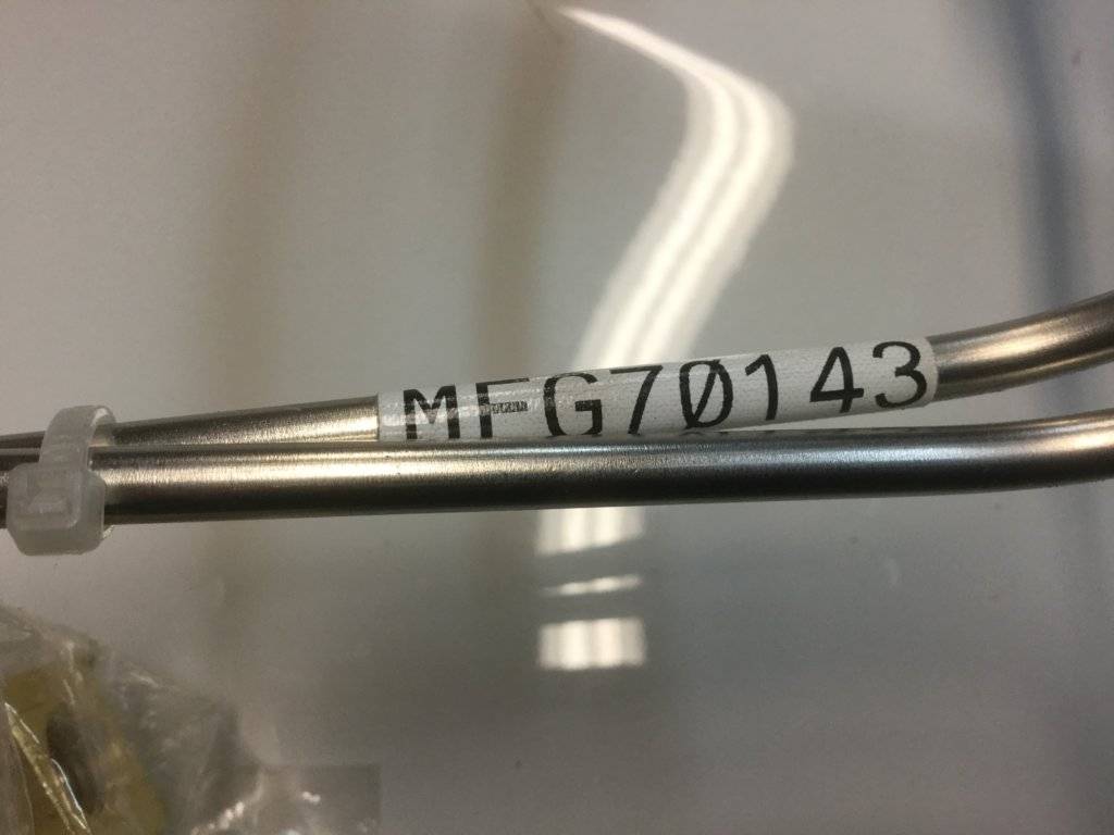

Inlinetube sells this kit to convert to the dual master. The distribution block mounts in place of the original. The old/original front and rear lines connect right up to it.
You’re right. I can’t find it online either among all the GM stuff.
I bought mine at a car show at their shop a while back.
Part nos. on the bill are: SCDB6504 and SMFG70143 for s.s.
