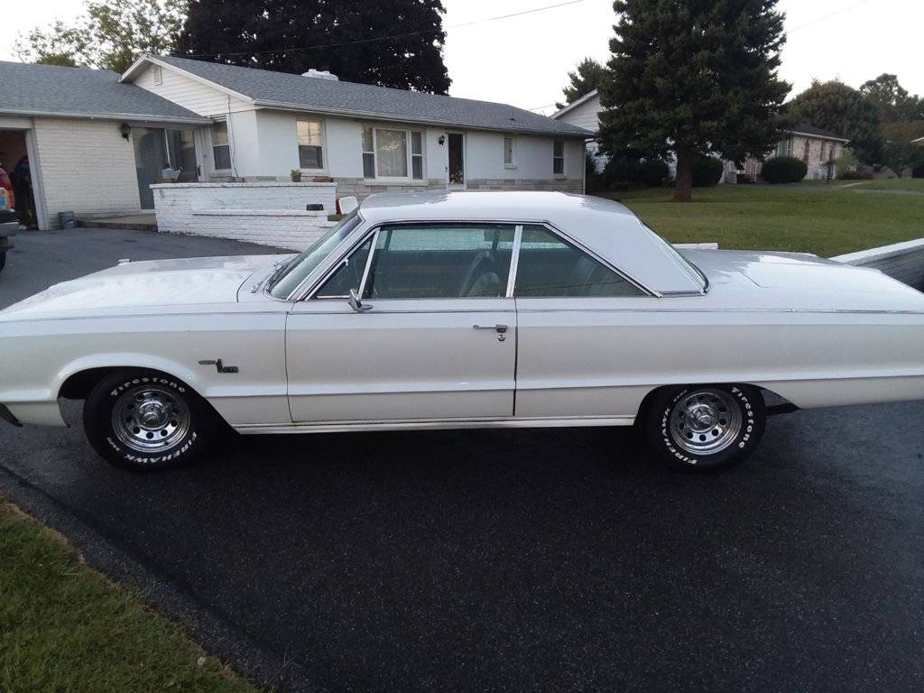

Finally after many up's and down's over the last year or so I was able to get the car on the road this past fall. I know many of you had asked me about updates on the car the last few months. Sorry for not being able to get any pictures up until now.
Overall a good experience. Everything is working well. Just a few minor problems to rectify.

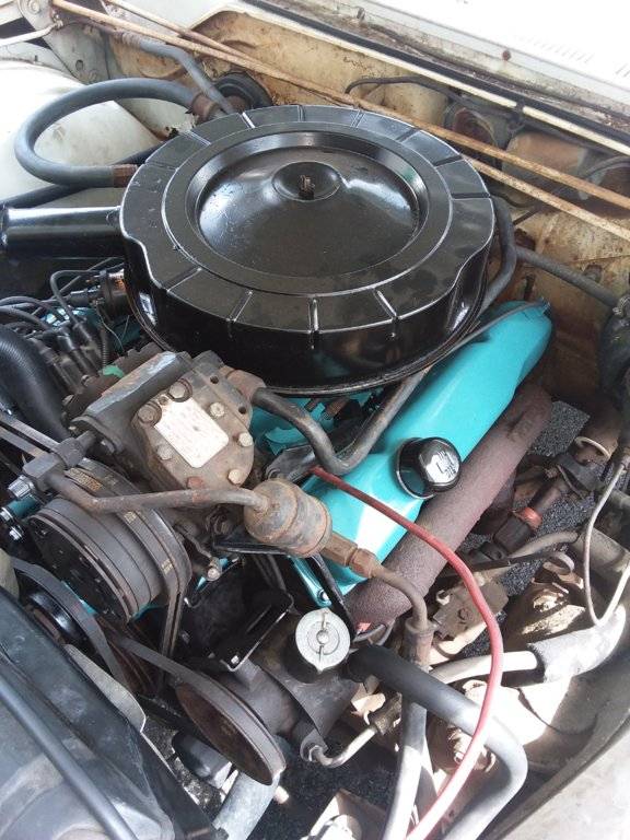

1. Temperature Gauge: Just not completely accurate or trustworthy. I put a 180 thermostat in the car and the gauge does not read accurate. Sometimes it's in the middle or runs, high and then bottoms out. I have a new sensor, just need to change it. I did hit the motor many times with my laser heat gun and it is showing 180 front and back of the motor. Thinking I will replace the water pump this spring as well. I have a new Auto Gauge triple pod I'm thinking of maybe installing? Heater does work nicely though and heater core doesn't leak.

Nice looking car. Try the new temp sensor first. The erratic temp gauge might also be a power issue to the instrument cluster, although this will usually result in erratic readings on all of the gauges powered by the cluster regulator. You might want to hook a voltmeter to the hot lug on the gauge and see if you have a steady voltage reading.

Thanks Dave! Great advice as always. I honestly think part of the problem is the sensor terminal. That nail head terminal is painful. Hard to mess with under the AC pump also.

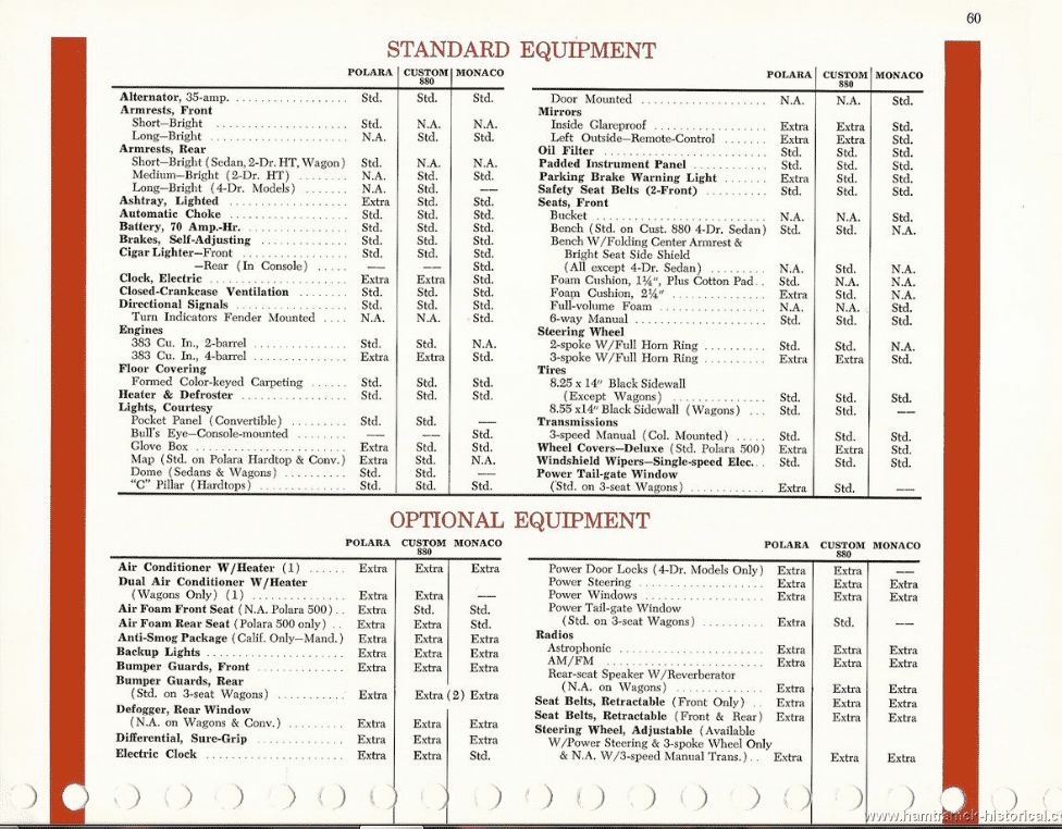

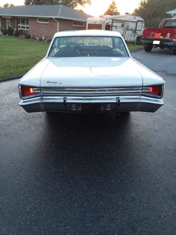

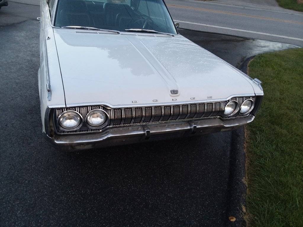

I've had alot of people comment about the bumper ettes on this car. Guess that's the correct term or bumper pushers. Are these an original common option or rare? Haven't seen many other 65's that have those.
The hardest thing also I've not located is the bumper rubber ends. My bumpers were rechromed once and the rubber fillers weren't reinstalled.

The bumper guards were optional.
As for the ends - are you talking about the gap fillers on the tops?

As noted by Polara 500, the rubber bumper guards were an option on these cars. If they are factory installed, they will probably be listed on the build sheet. There was also a dealer installer bumper protection package that had a very similar appearance. I do not know of any one currently reproducing either type.
