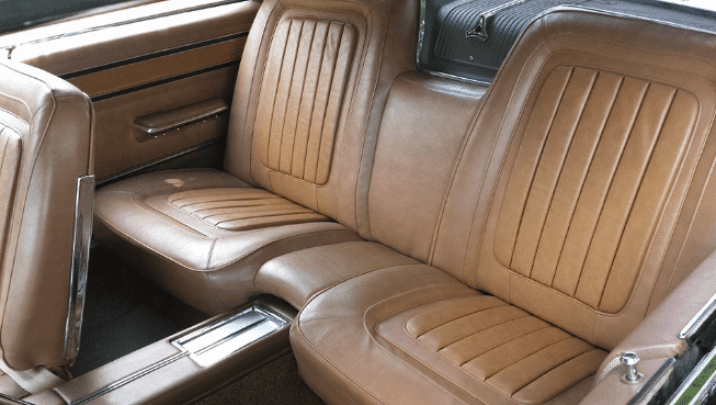

Have to repaint the molded package tray (deck behind the rear seats by the back window) and not sure of the original color with that saddle interior. Mine looks like a gray color but it could be a black that just faded over time. If anyone knows the correct color or has the saddle interior and can post a few pictures of that area it would be helpful. Here is a picture of the original saddle vinyl interior.
Thanks in advance.

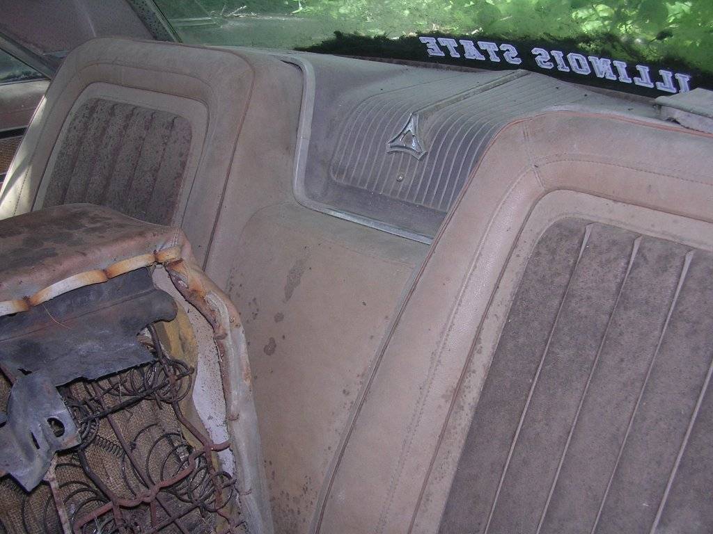

Well, my parts car also has the saddle tan, (I think that's what it's supposed to be), and the package tray appears to have been maybe a medium brown originally or possibly charcoal. I didn't feel like fighting thru the cobwebs to get too close.
Autocolorlibrary.com. has paint codes for interior trim. It shows a low gloss "Medium Tan Poly" for the rear package shelf. Evidently the tan fades to a charcoal color over time. Previous owners probably assumed the gray was originally black.
That sounds very like what the one in my parts car would look like under the dirt. Haven't even broken out the book to see what it said....... duhhhh.

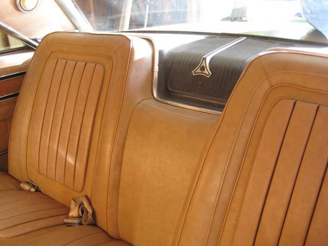

Here's a shot of the rear package tray of my car. Black is a good contrast with the saddle color seats.
