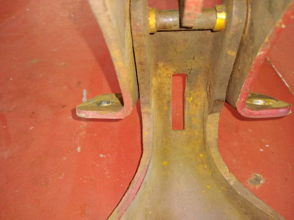

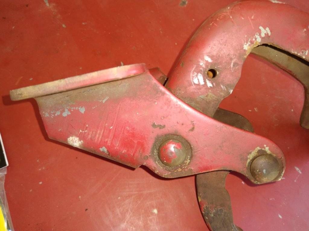

This whole mess started when I replaced the broken hinge on my car. after getting the new one in and the door realigned it really ticked me off to have the new one break the same way after opening and closing the door 3 times.
Pictures 1, 2, and 3 show the hinge with the old roller and pin removed.

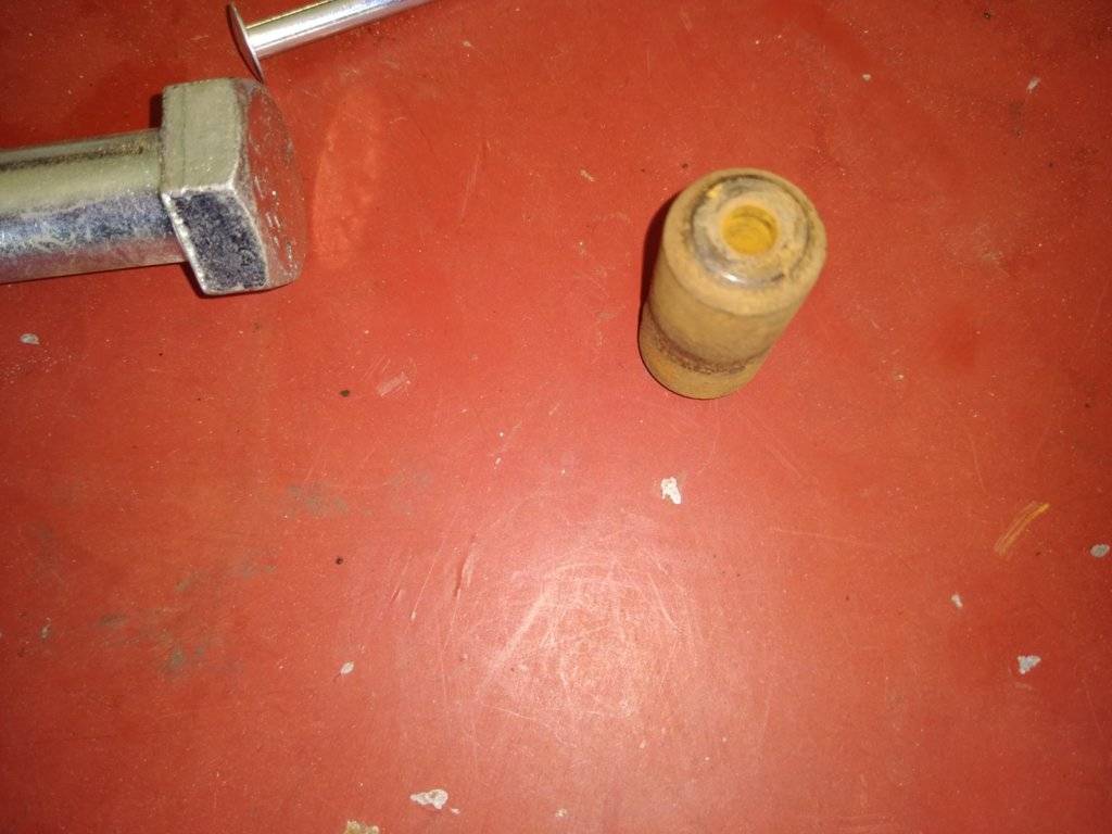

Here is the original roller from the hinge I replaced. The roller from my original hinge was long gone, so this is what I used,

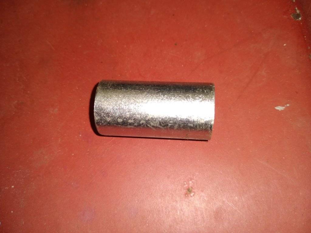

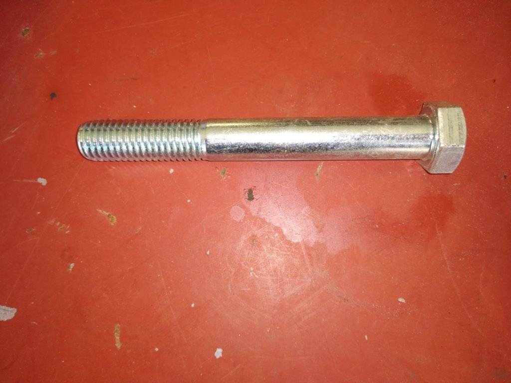

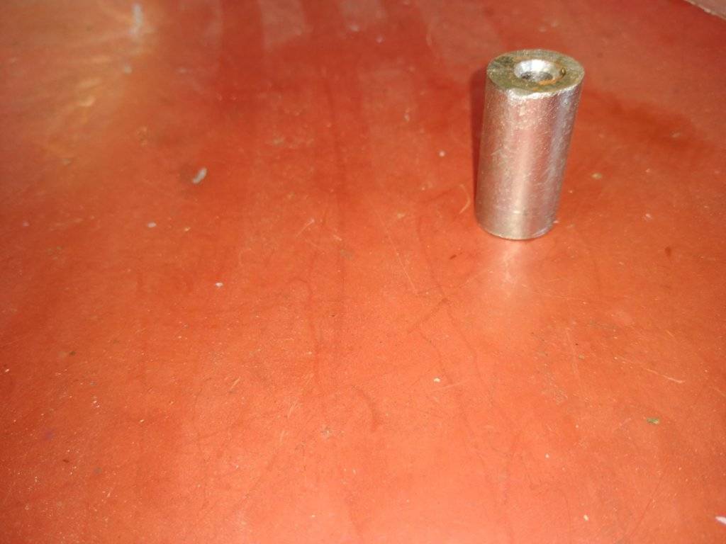

This is a 5/8" by 3 1/2 " bolt. This is the exact diameter of the roller. You want to remove the head and cut the bolt down to size so it fits into the hinge with about an 1/8" clearance between the hinge body. Drill a 3/16" hole thru the center of the bolt. Here is what the new one looks like.

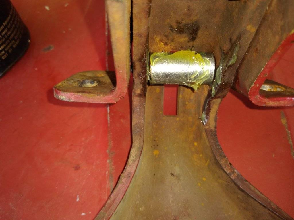

Then LUBE the new roller and pin and assemble it.
