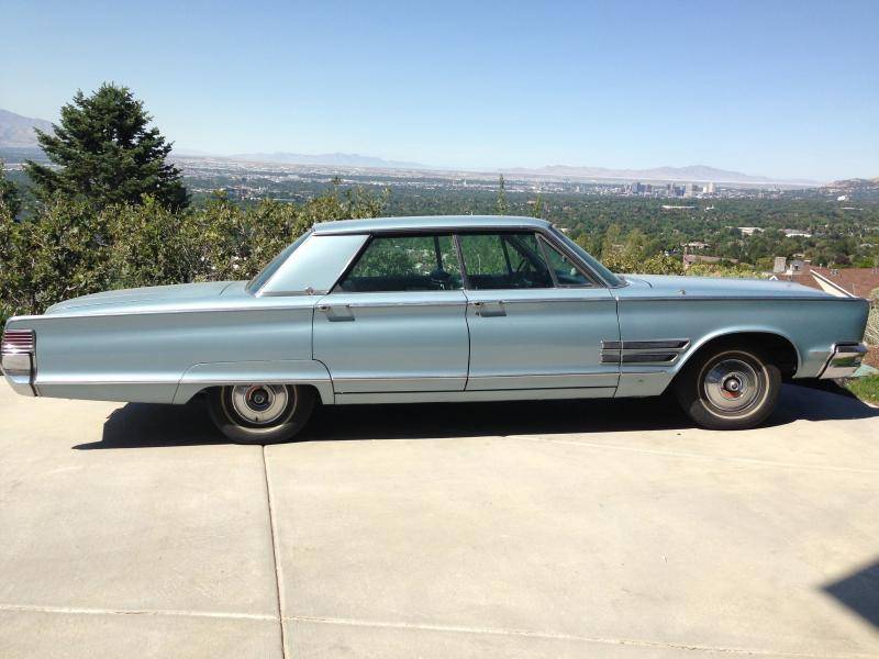

I am new to the C-Body Forum and I am looking for some advice on resto-moding, an all original, I am the 2nd owner 1966 300 4 dr 383. I found a lot of information and responses to starting restoration projects, but I was not able to find follow-up or conclusions to these. Simply put, I want a 50 year old car, kept discreet, perform and drive like a new car and need to understand how to do it right...and call me crazy but I love this body style and I do not want to do just another Cuda, Superbee, Charger muscle car.
Therefore, please forgive if these questions/concerns have already been answered in the forum, but I need help in the following areas:
  • Will 1966 C-Body accept new HEMI/Transmission drive train?
  • Does 1966 C-Body have enough rigidity in the frame to support new HEMI/Transmission drive train / HP torque etc? (I'm thinking 6.1L)
  • Where can I find specifications/dimensions for both 1966 frame and new Chrysler frame?
  • What suspension upgrades will I need to keep stance low but maintain ride quality?
  • What Disc brake packages are out there?
  • ...or should/could I get a wrecked SRT8 300C and take Engine/Trans/Rear end out and drop it in 1966 Chrysler?
I am aware that a project like this can run away quickly with exorbitant costs if I make the wrong decisions and get wrapped into pie in the sky dreams. My ears and attitude are wide open to any responses. So, I look forward to your experience and expert advice.
Thanks in advance

Welcome. When it comes to a car as nice as that, a total rebuild of stock components will be far easier, cheaper, more satisfying, and Pro-Tour with the best of them.
Rebuild the front end, steering, and suspension and it will track like a Viper with the right components.
Upgrade the fronts to discs and rebuild the rears.
Rebuild a nice 440 and the TorqueFlite.
My stock New Yorker can go coast to coast more reliably than any $50k Pro - Tourer.
Its not an Impala. It's a Chrysler C-body, a world unto its own.
Pick one project and we'll guide you step-by-step. It's been done a hundred times before by The Best & the Brightest here Forget all the Chevy crap you ever learned. That has been the biggest problem of people jumping into their first C-body. Then they give up in total failure ½ way through.

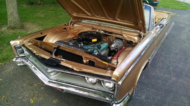

You will find most of us here keep thinks pretty stock. My 383 brings a smile to me every time I pop the hood.
Sweet car, I wouldn't change a thing and welcome to the site from the Motor City!
Brings a smile to me everytime you do that as well. Don't look now but your pride is showing - beautiful car man!
S##t, I'm proud of Mike's 300!
So many nice cars on this board. Mikes is in the top 5. And to think we saw it in the garage as he was making the deal....He's come a long way.....
