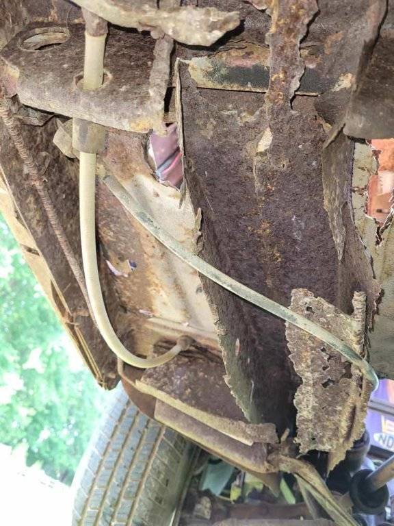

Thinning the projects ..this is a 1969 300.
Both rear frame rails look like this. passenger floor areas ok. stub ok. rockers ok. both quarters behind rear wheels bad. body panels otherwise good metal.
I do have a clean-enough '69 "donor" and skilled body men ("old school" guys with 40 years experience & still "young" enough/high work ethic to take it on).
Yes, i know its a big job. My guys have rendered an opinion. Its a "split decision" - two guys in one camp, one guy in another. Money is a concern but not a constraint to moving forward. "Concours" resto was never in the cards.
I am taking peoples' thoughts here before I make a decision next week to start repairs or scrap the whole car.
I will not derby it, but will strip it of good parts before it gets recycled. I will not be selling parts from it. :)
Sorry, there are no more pictures coming.
Thanks in advance if you have thoughts.

Ray, As you know, these cars are expensive to repair. If this car has a lot of parts that are needed to save 2 of your other cars, then I would say part it out. Good luck with your decision.
Have you a donor car with all the needed parts? If not it’s a parts car.
Parts car. The rear frame rails on a convertible are extremely involved. You will need to fabricate a steel mount to hold the body by the pinch welds and weld braces between doors and cowl to keep from flexing. Use the parts to save others.
i fixed the rear frame rails on my '69 convertible with no problems. i considered it the easiest part. doing the inner fender and rear wheel arches from scratch were very difficult. if those are good on yours, the body is saveable. in your overall position i think it's a parts car, but it's a shame to just scrap a decent shell.

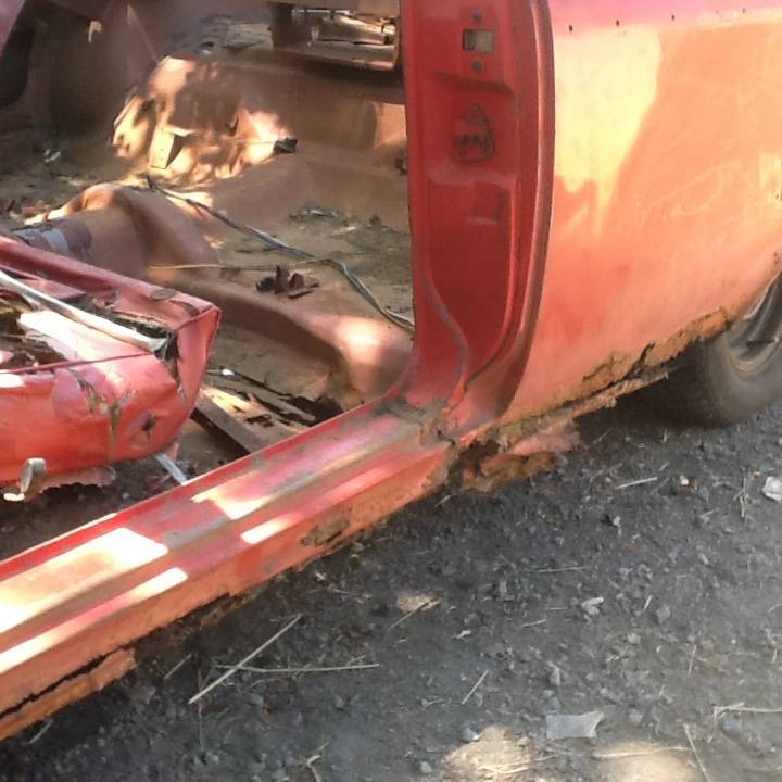

btw, a few folks here knew I have these verts and knew my plans DID include giving away (yes, "give away for NO money" .. somebody just agree to pick them up at a place/time, exactly where they are - in Michigan) the shells of what i deemed "parts cars" to anybody just willing/able to drag (they'd be four wheel rollers) them away.
NOT MINE - 1969 Chrysler 300 & Fury III Convertible barn finds, $1200-4500 Clinton, MI
Even after I picked them clean of what I wanted, there would surely be stuff left over useful perhaps on other cars that arent verts. I predict no one would want them after that, even if free, just adding time/hassle to the whole deal for everybody.
Hence part then scrap.
I am now leaning against that "give away" idea. I really just dont wanna be horsing around with, even with abandoned project cars that are free, with time wasters, nit-pickers, appointment breakers, etc.
EVERYBODY is NOT like that, I know.
But I (and my local buddy taking them apart for me) dont have patience for even ONE person like that. Two miles from where the cars are is a recycler. Show up with the titles (I have them) and if its a slow day, he'll crush them while we watch.
To me, better that fate (help save the planet) than a derby or some ill-advised attempt to put a compromised car back on the road. Simple fact is they all can't be saved.. and I am ok with that.

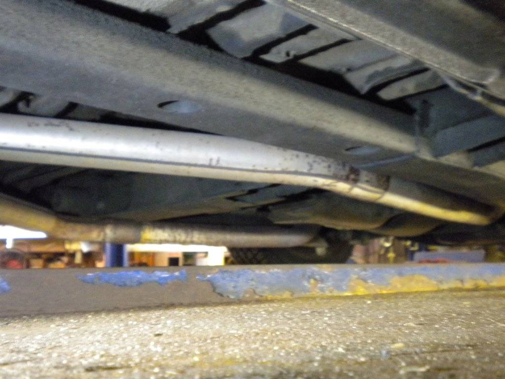

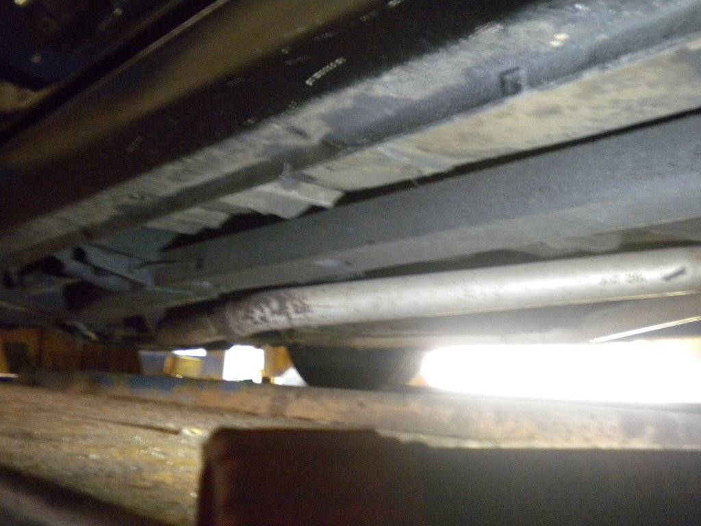

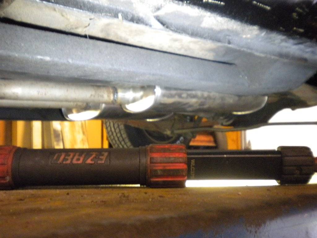

my car was so rotten that it could have broken. i built frame connectors for it and made it rock solid. both doors can be opened and shut on a lift. they weren't even difficult to make. in the case of this thread, the decision is made and should be acted on.
