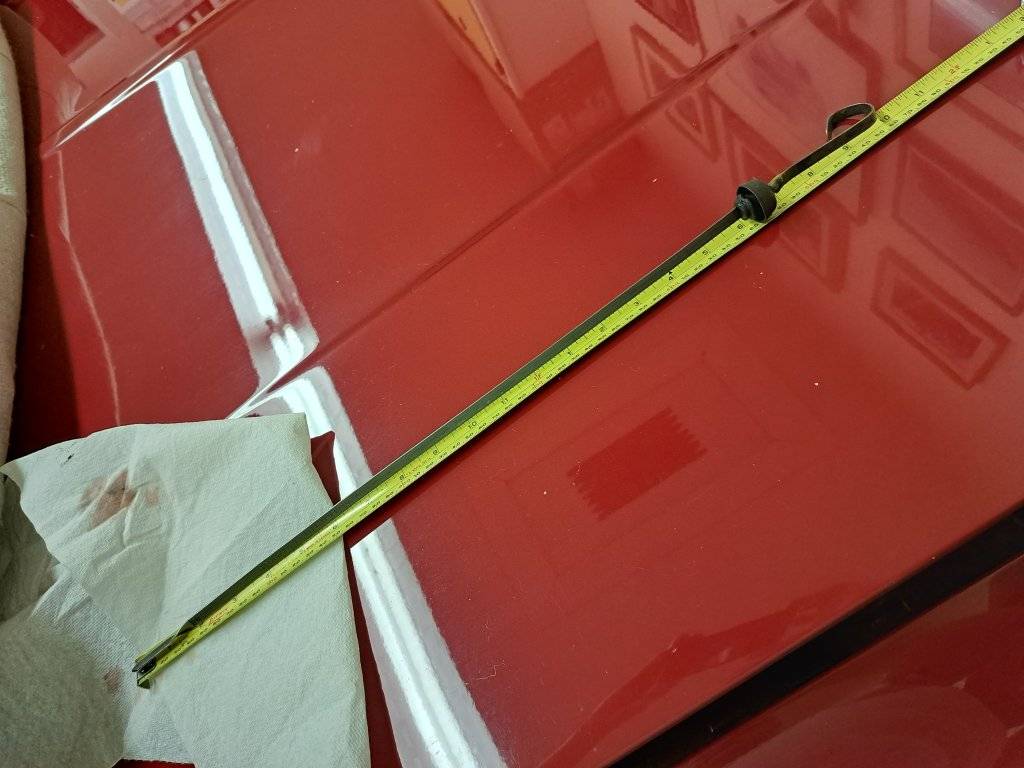

I bought a dipstick but it's a universal and it's too long.
From the top of the tube, could somebody measure their dipstick for me so I can cut this one, and measure the low/high marks from the top? Please?
Thanks
Phil
I can measure mine on my 66 T&C for you, but it's a 440... so I am not 100% certain that the dipsticks are the same length.
Regardless, perhaps someone can verify as to whether the dipsticks are the same length.
Stand by.

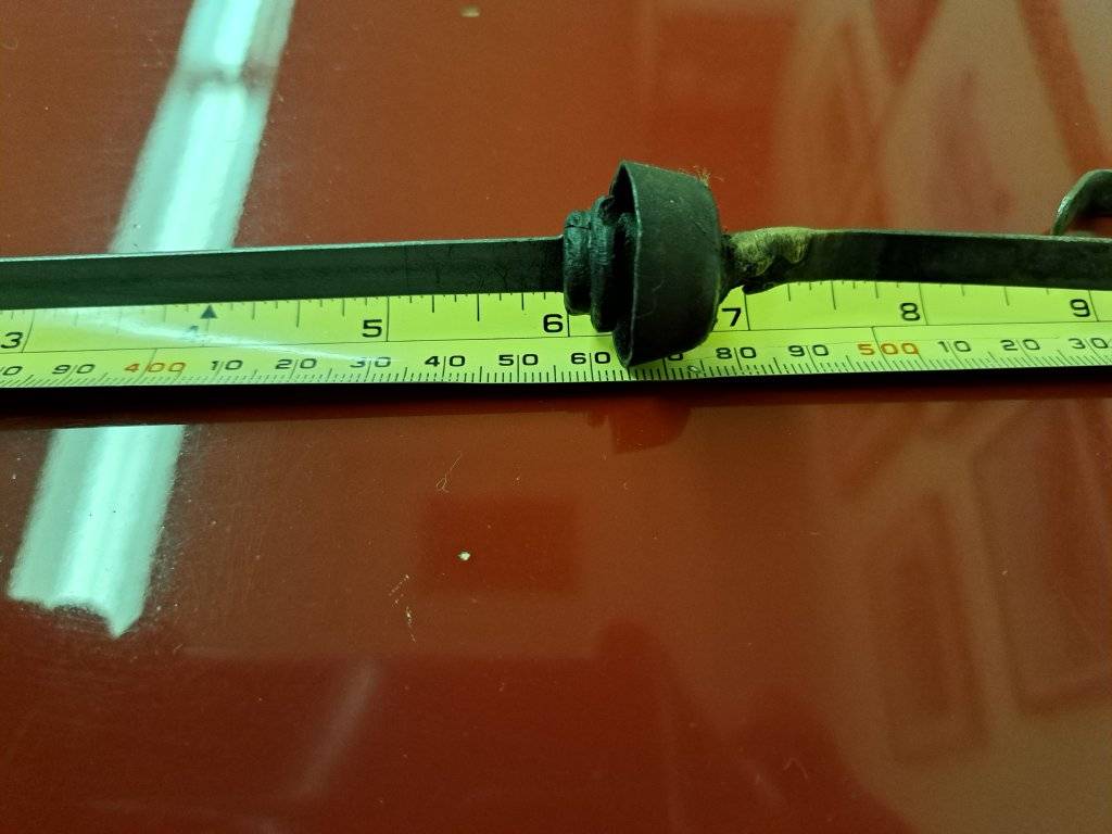

18" from the tip to the bottom of the handle plug:
22" tip to end of handle loop

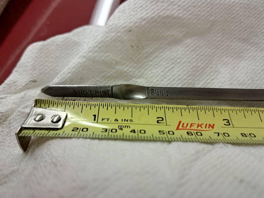

Add mark at 1 & 5/8th", full mark at 1 & 3/4"
I checked my parts book - EXCEPT for Hemi Engines, all auto transmissions in 66 regardless of body designation use the same dipstick - 2466 302, and the seal at the top is 1316 815.

Also, ended up with generic dipstick because nobody locally could find a cross reference. Everything came up 27" for the 727. Which again, is wrong for '66.
Got it calibrated. I'll fire it up tomorrow and see where it sits in D. Right now it's way too high, but the torque converter definitely drains down on this gearbox.
