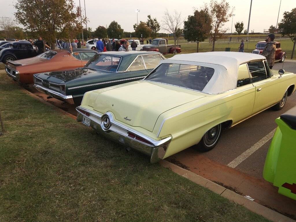

Tonight was cruise night in my little ' burb...
The car has been running great, so today I dropped the top and headed out. Did 75 on the highway without issues. And mysteriously, three of my four windows worked again! The DS front is still locked in the "up" position. That helped my attitude!
So, I made four circuits and parked, to do some looking at some cars as they passed by. A fun, cheap afternoon. A guy and his car. Put about 30 miles on the Imperial tonight. There is still stuff to do, but I'm going to drive and enjoy it this Summer!

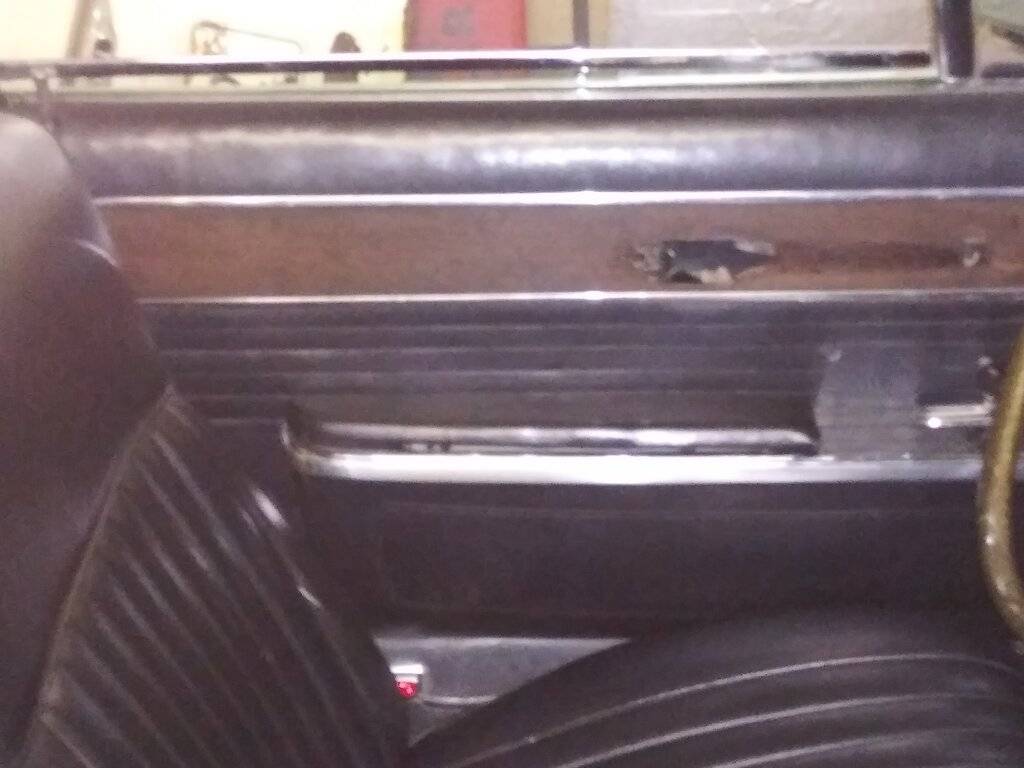

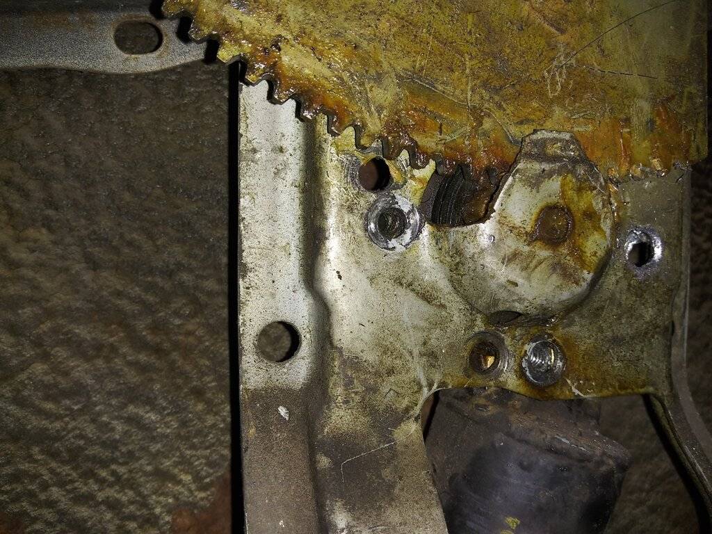

Got the door card off tonight after putting it off forever. The motor has a hidden fastener that is proving to be a pita. So, tonight's work will continue tomorrow.
Good luck. Definitely going to keep watch on your window motor saga. On mine, all work slow and the DS rear window went down and won't come back up. Weird thing was - I was pushing the button on the driver's door forward (up) and it still went down. The back switch seems to work right but I think there's a dead spot somewhere on the motor armature as it only twitches now and then, if anything.
It looks like there are extra mounting holes for the motor ?
It doesn't line up with anything, though.
I was able to pivot the motor enough to disengage the gear, and allow manual movement of the window up and down. It needs to be lubed up, but that's gonna wait until later on. Once Summer is done, I'll tackle removal of the mechanism and repair the motor. I want to drive it!

Well, I finally got back to the window on Saturday. I'm gonna wait for Fall to r/r the regulator. It works fine by manually lifting and lowering the window by hand. I left the motor disengaged from the window gear, and unplugged the inop motor. It works for what I need right now.

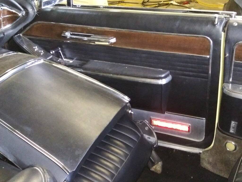

The bottom of the door card is pretty sad. Moisture over the years has made this extremely fragile. For a stop-gap measure, I reinforced the bottom inside (facing the door) with Gorilla tape. Not visible if you look at the door. The three remaining clips stayed in the holes. It's been off before...a few times! So, I had no choice but to loop gorilla tape and use that to hold the door card to the door. Again, a temp measure.. The door is reassembled and the car is ready for a drive again.

I forgot I'd left the motor plugged in. I was raising the windows up on Saturday, and hit the DS front switch by mistake. I heard the motor! Since I can manually raise and lower the glass by hand, it appears all I need to get things going right is degrease, then relube the regulator, bolt the motor up and see what happens!

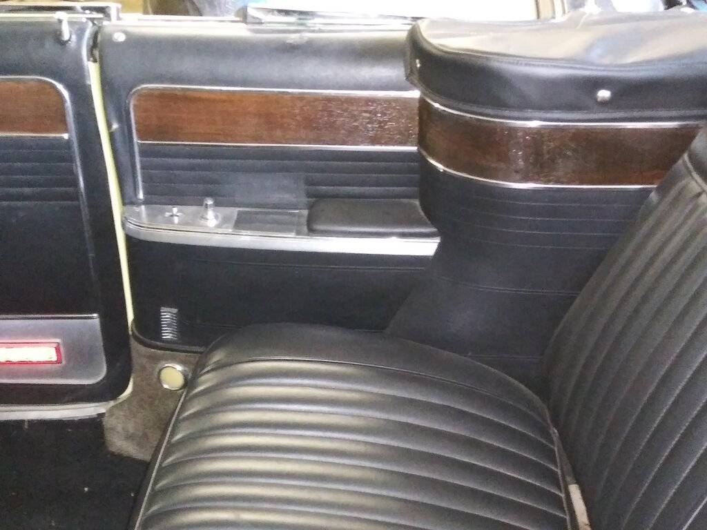

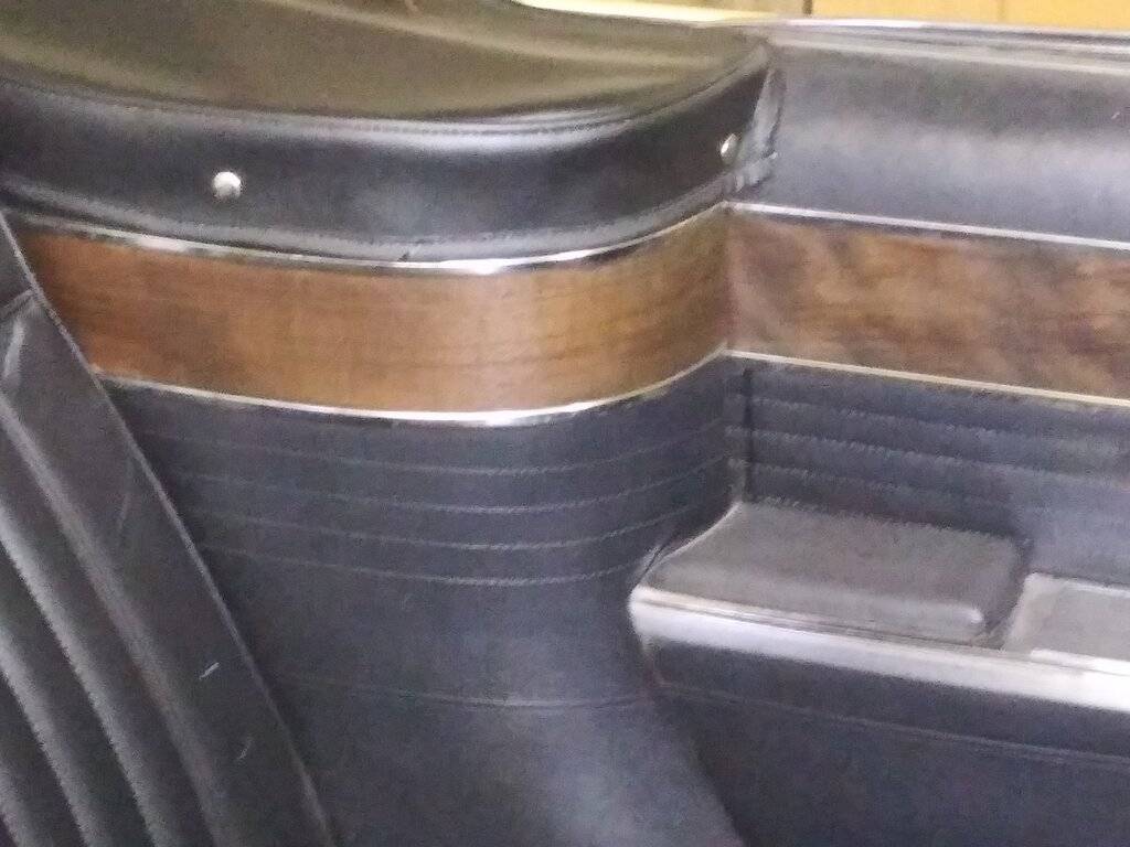

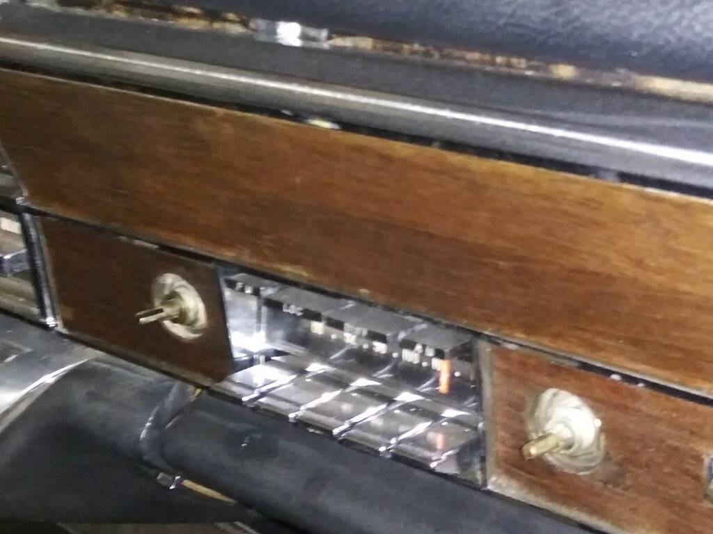

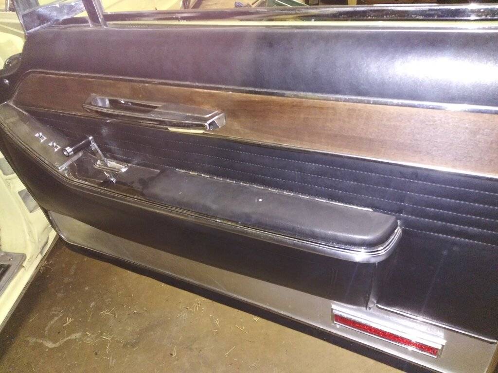

Been looking at the faded walnut trim on my car since the day I bought the car. Today, I did something about it. I got a half-pint of walnut stain and a top-quality brush, along with some 1600-grit sandpaer, and restained all of that trim. I am going to do a second coat tomorrow, and then clear with some polyurethane. Some pics of the evening work...
