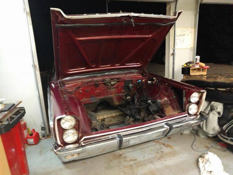

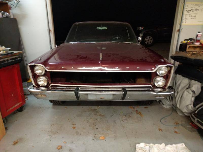

Engine and transmission are out! Last night, my dad came over to the garage to help me finish taking the car apart. We wound up pulling the engine and trans as one unit. This took us around three hours. The transmission is getting a complete rebuild, while I am just going to be putting the correct intake and other assorted pieces back onto the engine.

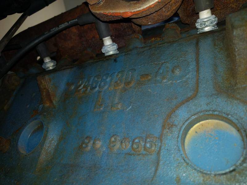

It has become obvious that this car has had some sort of accident damage in it's past, as the inner drivers side wheel well and fender are blue. The good news is that the engine is almost definitely original due to it's 8-9-'65 build date (made a month before the car)... Now where did I put that trailer?
Did you have a hard time removing the Core support?
Not too much of an issue. The previously rounded off bolt heads were what was holding us up. We had to take it all apart to get it to come out though.

Are you pulling the trim yourself, or leaving that to the bodyshop? Excellent thread you've got started... every time I think I will take pictures of a project I get focused and forget about the camera until cleanup time. Please keep it up.
I will be taking off the trim and doing my best to restore it or replace it with what precious extra I have acquired. I'm glad that you enjoy the thread!
