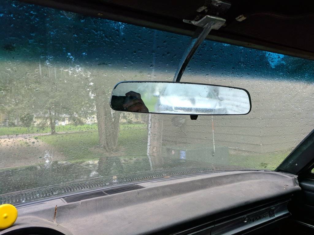

Found the rear view mirror under the rear seat, wondering where it went. Put that on too.

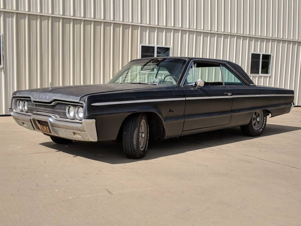

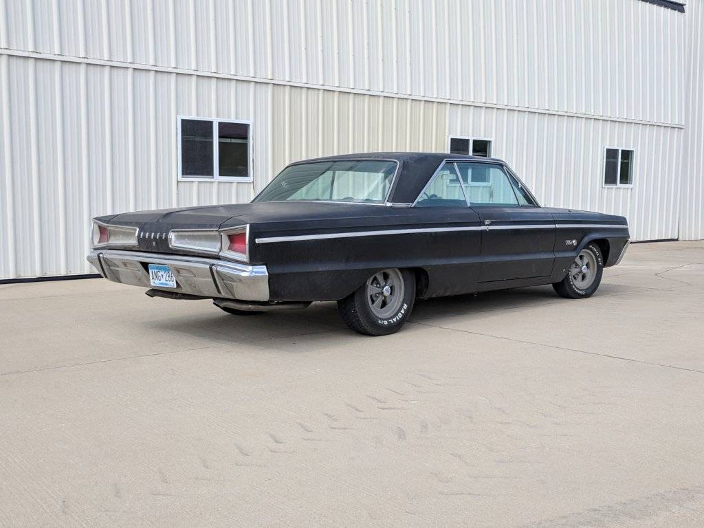

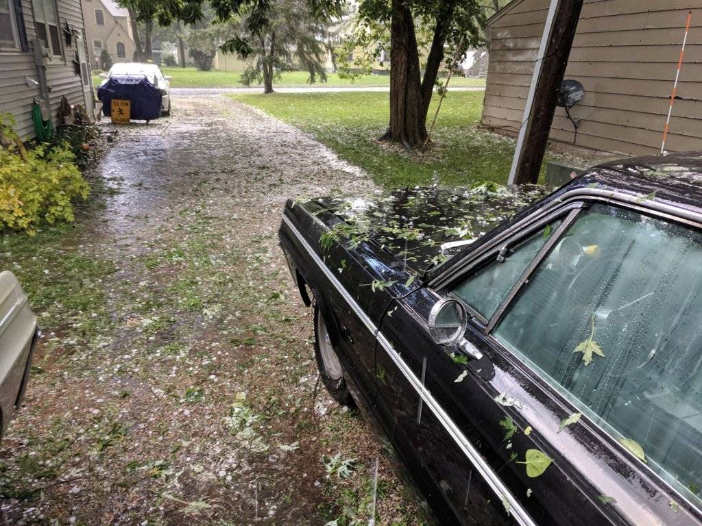

Speaking of rain, I'm glad I stole the passenger side wiper from the gray car, this is what my car looked like as I left for work.
Thought I had a picture showing the front better, oh well. We had a hail storm come through 10 minutes before I left. Good thing the old dog is made from real steel, not a scratch. The little bit of wind cleaned off most of it.

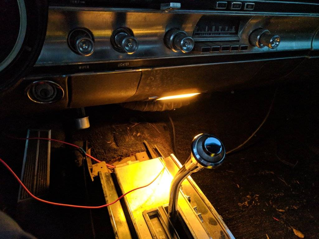

Being a complete motorhead, I adjusted my wiper and verified the switch at the door works for the interior lighting.
Now I need to check bulbs, and more wires.

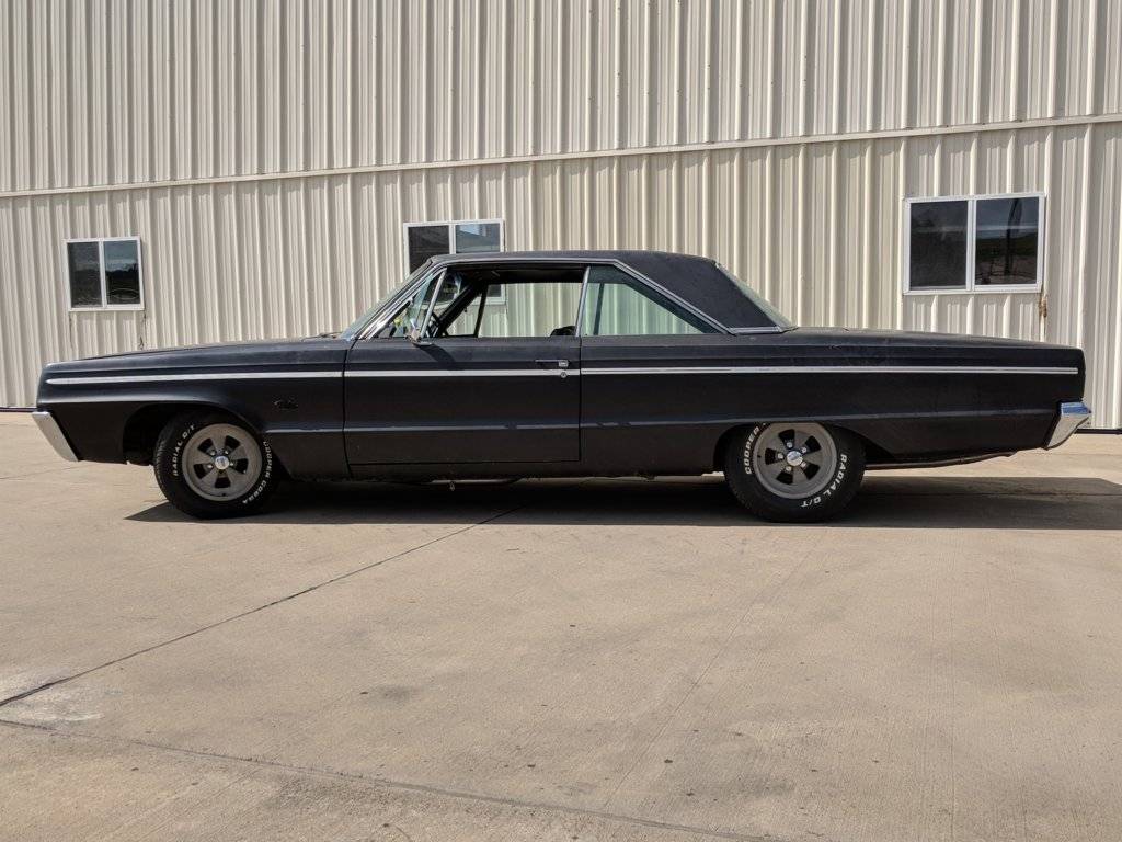

Before
After
But I'm not surprised, just another chance for me to get to know the car better.
Just looking at the two pictures above, I love the look of tinted glass in a car, don't know why, but I do. My Dart and both Polaras have tinted glass, the 500 being a non A/C car.

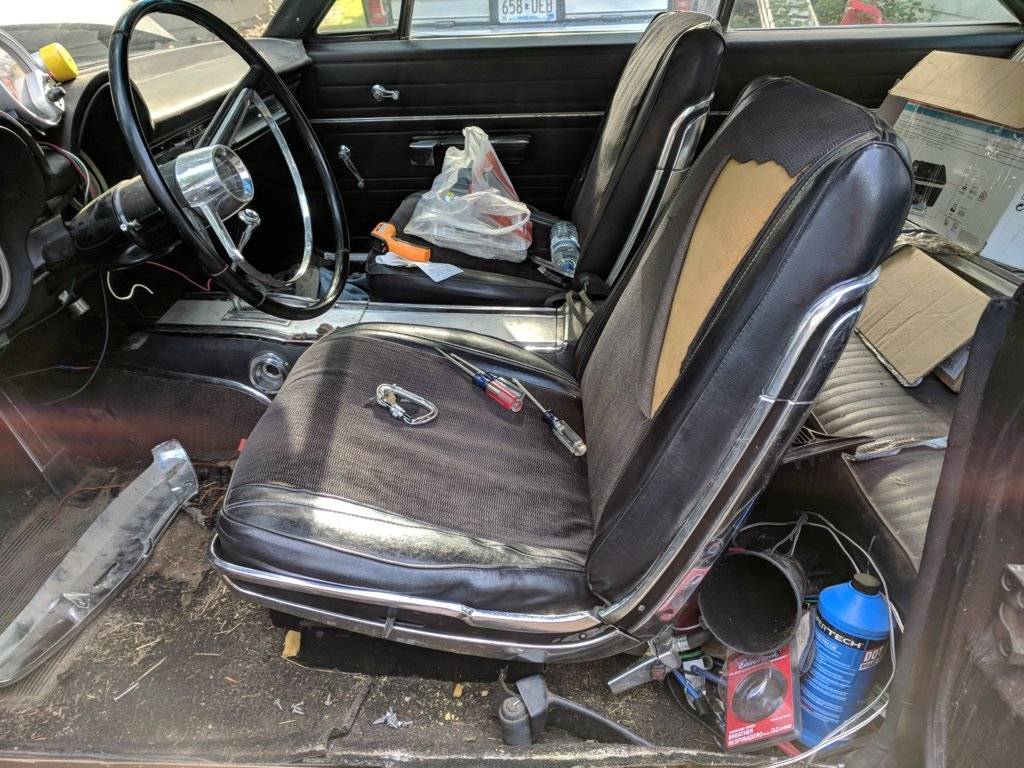

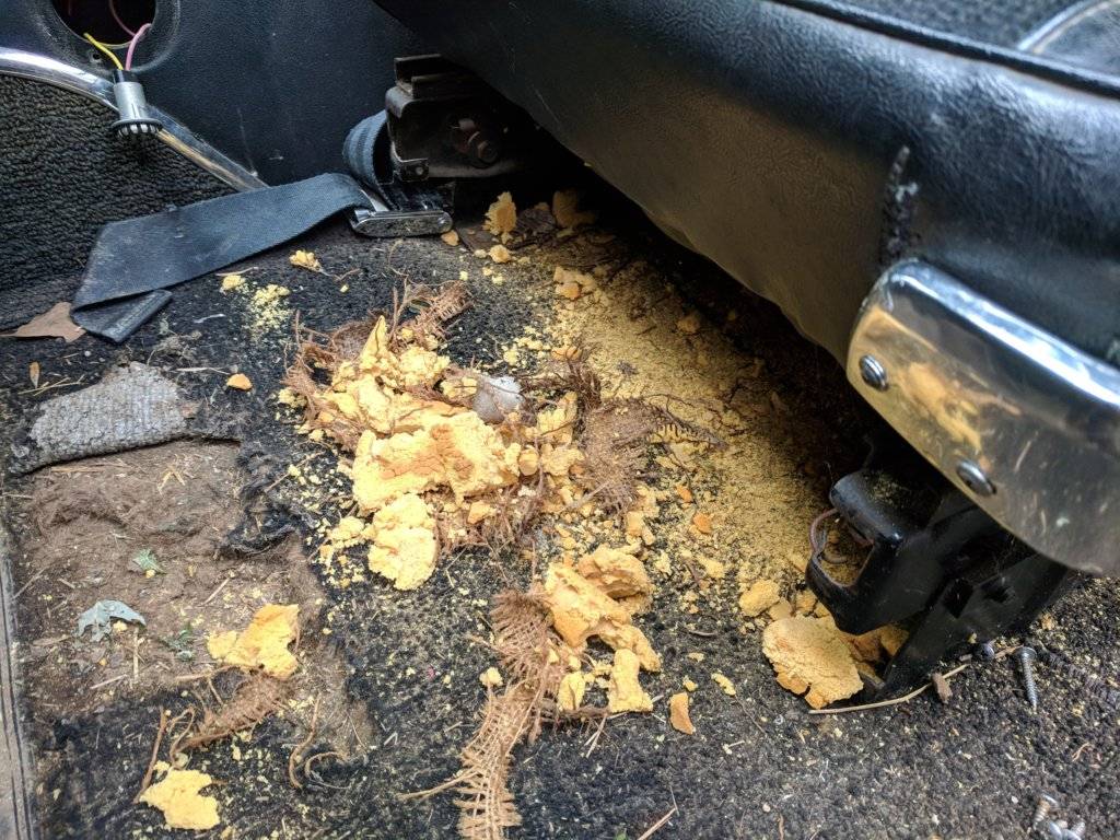

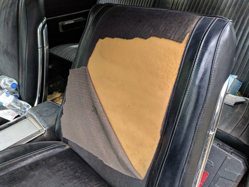

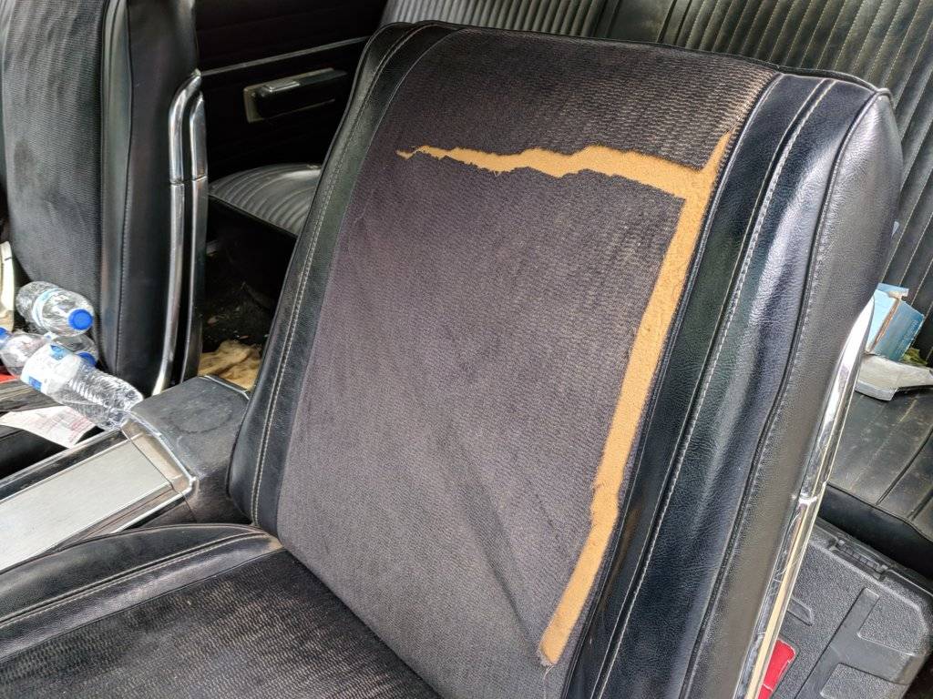

The driver's seat is going quickly. Too many dry popcorn farts must have done it in.
Got that reaching under the seat to retrieve a screw I dropped. The seat back is no better.
It was already starting to rip a little each time I sat in it, then I turned around to put my beer in the back seat and rrrrriiiiiiiiiiiiiiiiippp, a nice clean look at the foam! I'm debating weather to have these recovered or have my spare set done and swap them out. I could always drive around with red buckets for however long it takes.
Swap them until you repair them, which is original the fronts or rear?
Shocks, the fronts might be? I took the car for a drive, using a GPS tachometer app, I think I might have a higher (?) gear ratio, maybe 3.23's instead of the 2.76's the car was born with. Now I'm not 100% sure the tach is right, but the car sounds like whatever the number is reading. I know the speedometer needs some work, it bounces around over 50, and under 20. Between there it's great! But I was running 2500 rpm at 70 mph, that's a lot closer to the gray cars 2800 rpm at 70 mph, and the 500 has an inch taller tire.
I'm stupid, the seats! Both are original, I think, the front may have been recovered. Haven't yet determined if there was some funky option for the seats to have that carpet like insert. I'll dig through what I have and can find, if I can't come up with anything conclusive, I'll go with a stock style cover.

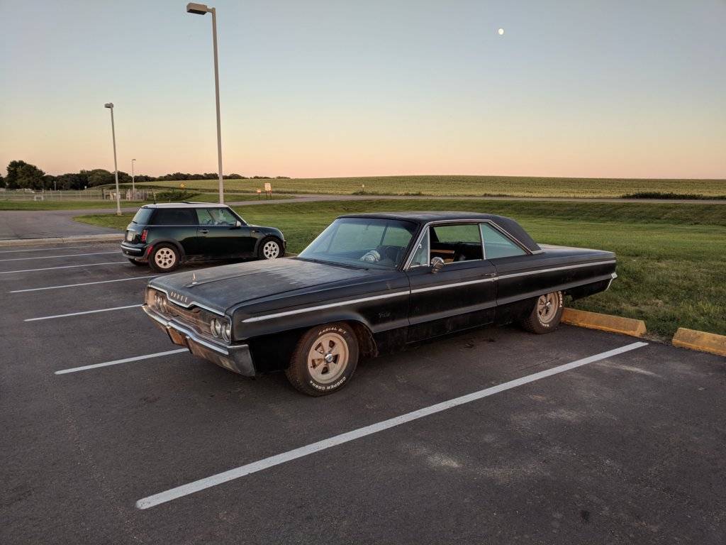

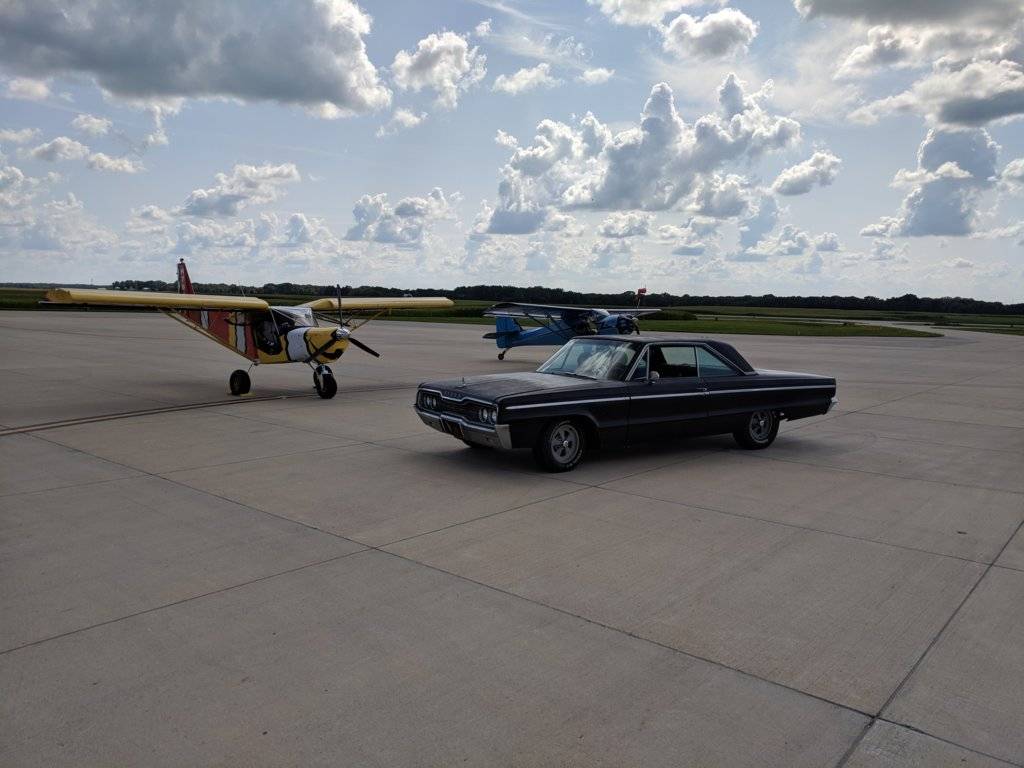

Took the car down to the local airport and did a quick photoshoot. They had a few old planes there, so I took a couple shots with them. Nothing great, but thought I'd make the pilots happy by including them in some shots.
And just the car.
And that was that. I got my picture, said thank you to the pilots and headed home for date night with Laura. I'm going to go back and get some pictures in front of a windowless hanger.

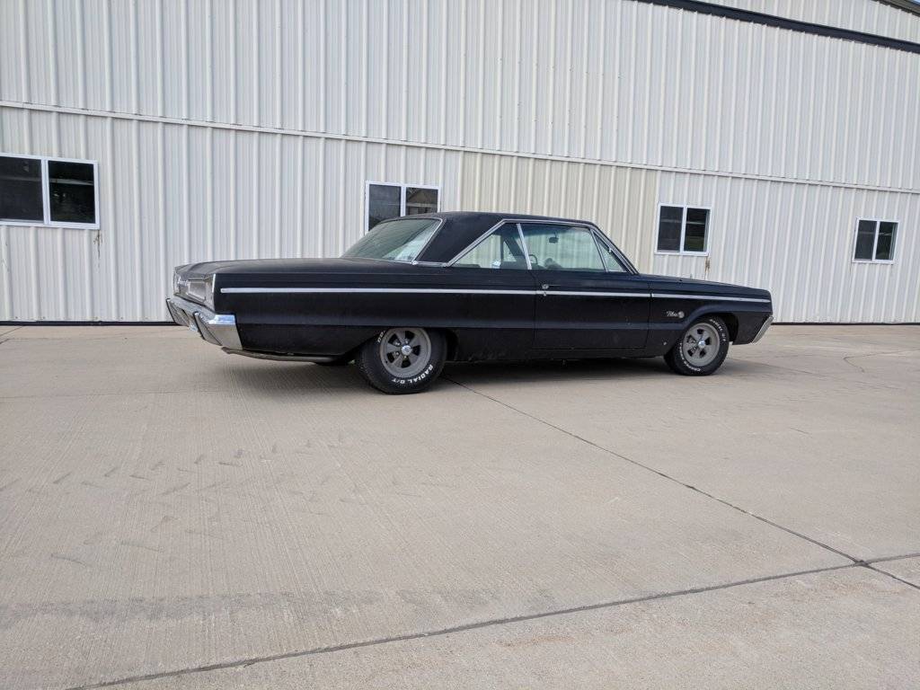

I am digging the wheels, there just raw aluminum right? No kind of finish on them?
Yeah, they were blasted when I got them. I cleaned them up, somewhat, could have been better, and sprayed some flat clear on them. A last ditch effort to find wheels on Craigslist before I sprung for brand new ones.
