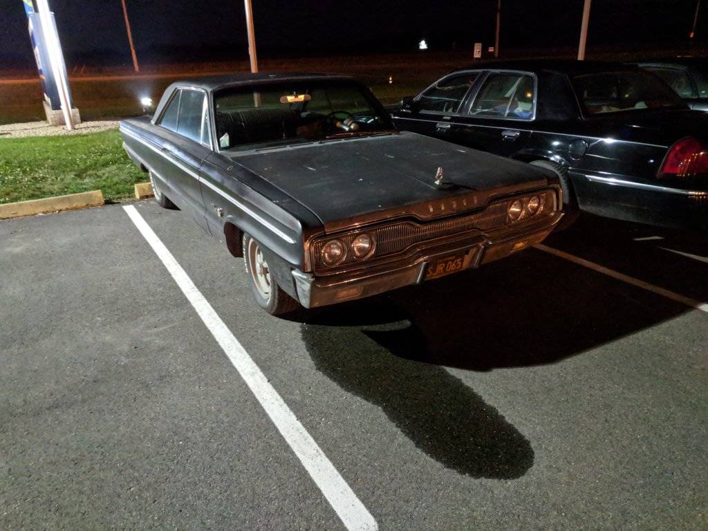

So on the way home from the amusement park, after my post I made halfway home, the car died again, but at least I was only ten miles from home, and had the spare battery I had just bought. Swapped them and got home. The car is a local car for the time being, I have a new alternator to install, and another harness if I need to replace wires. It might be time to make a wire loom board, having three '66's that have original, and hacked harnesses, using another 50some year old wires might not be the best. Time over the winter, or money to someone else. We'll see. If I ever get a day off from work I might get some more wires inside the car hooked up correctly, and get some more interior lighting, like the speedometer, and gauges.

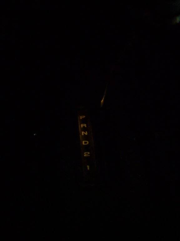

Got the shifter light plugged in, so there is a little but more light inside the car at night.

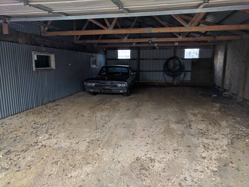

Got the new storage space, enough room for 2 cars for sure, maybe three or four, if I need it.

The new storage space looks great, but dirt and gravel floors inside a building always worry me. I think it would be a good idea to put down a 10'x20' poly tarp, and park the car on top of it. Although it looks dry, you can get quite a lot of moisture coming up through the floor, The tarp isn't much money, especially if you are near a Harbor Freight store.

That's my thoughts too. I'm just trying to clean up the yard and get a few things out of the way. Some barrier needs to be put down, I'm not too keen on long term parking on gravel, although my Dart fared pretty well after a decade parked on a gravel driveway, but I'm going to put something down. Anything going in will be a driver, so it won't stay there after the snow melts.
The added expense has me thinking what my options are for ling term storage. The guy I rent from has a building he wants to sell me, something like 40 x 70', an old school I could store five cars, and all my parts. Already built is a plus, I'll have to check it out sometime in the near future.
I like to put blocks under the wheels and get them up off the floor as much as possible. Safety jacks would work too, let the air circulate.
I don't think that will fly, with the gravel being not the most packed I've ever seen. I'm going to go for barrier coverage, I'm not too keen on jacking cars up and down every six months, I'd probably keep them jacked up and never set them down again.
