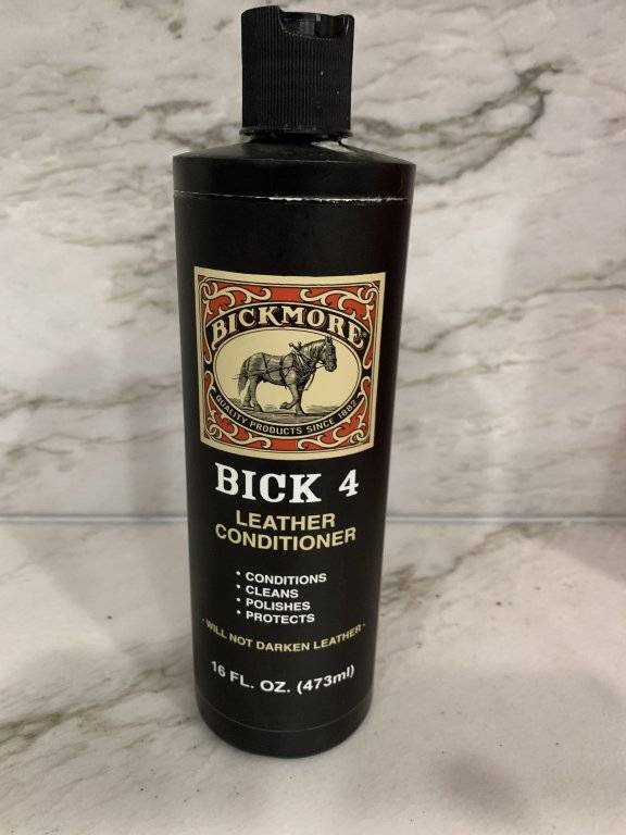

I have tried many products including Lexol , Adams Polishes leather treatment etc … this is the best I have found . Was recommended by the manager of a Hap Tallmans saddle and western store . I used it on a 1989 BMW 325i E30. Convertible thats leather was rock hard . I applied liberally with my hands . Literally poured it on and left it overnight with the top up . Next day it had drank it in so I applied another coating . I repeated until the leather was soft . Covering with plastic may work even better .
Your leather is probably Vat dyed like the BMW so it should penetrate well . I used it in my 75 Imperial as well with success although I believe by 75 Mopar was using surface dyed leather which doesnt absorbe it as well .
Buy 2 from Amazon . Not sure where you can get it locally now.

I have tried the Bick 4, starting with a small section of leather. The first application took a full day to soak in. It’s been cool here, so not surprising. The second application was absorbed in about a half day, the third even faster. After the 4th coat soaked in, the leather was noticeably softer. I’ve now applied the Bick 4 to the rest of the leather, and will keep working it in until I don’t see any further improvement.

Based on Mbaird’s advice, I’ve been working Bick4 into the leather. I’ve used 2 bottles so far. Most of the leather has softened up. The front driver’s seat is still stiff, but it keeps soaking up the Bick4, so I’ll keep applying it. I’ve ordered a third bottle.
