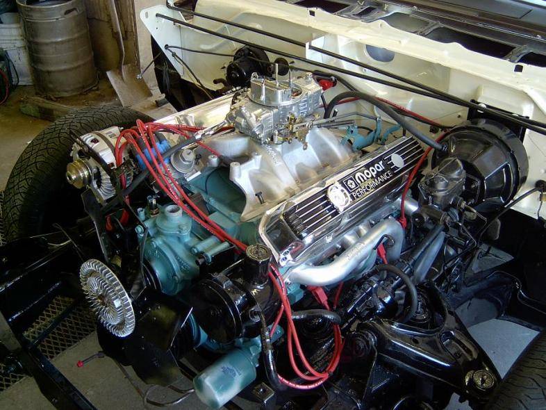

Do you have the FSM? It'll show you how the pump and mount attach to the block. You've also got an empty pulley on the crank that drives the pump, so that will tell you how far out from the block the pump needs to sit so that the belt lines up properly. It likely has a pivot bolt at the top and then another bolt that goes through the front portion of the block mounted bracket that goes into a threaded hole in the pump body that allows you to pivot the pump to tension the belt. If the bracket is still on the block, a little fiddling will pretty much show you how it mounts.
The mounting spots are the same as Stan's picture , but the earlier cars did not yet use the Saginaw pump.
Your AC will have a mount that shares the slack in the power steering pump bracket on the top bolt.

In '67 it could have been any 1 of 3 pumps they used.
They all used different mounting methods depending on A/C or no A/C added to the mix and I think you ending up with 1,427,115 variations of mounting.
