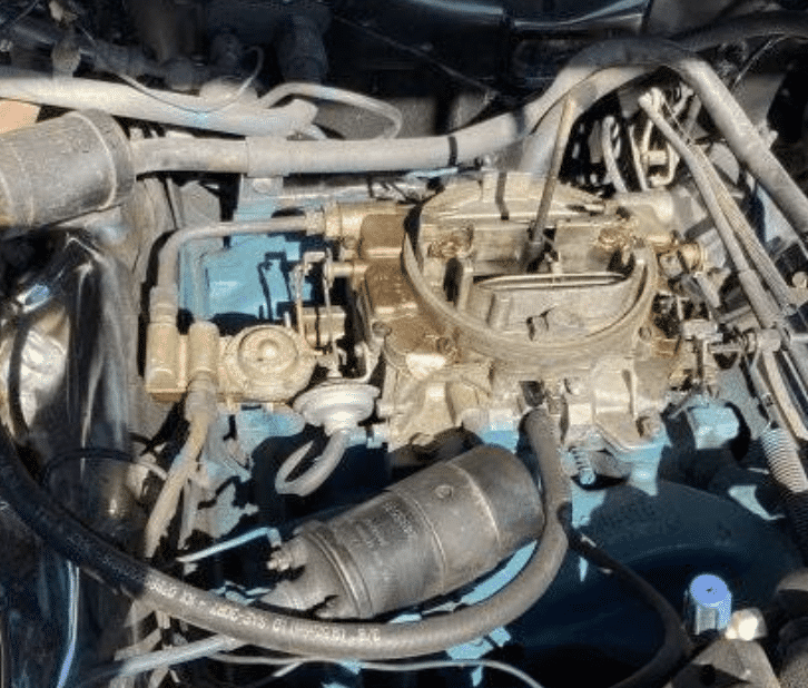

Is this a fuel regulator? And is it aftermarket? I've never seen one from the factory, but that one really looks like it belongs there, possibly because it's been there for so long.
