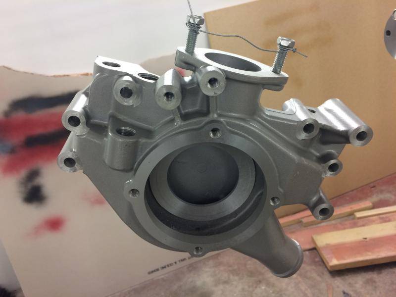

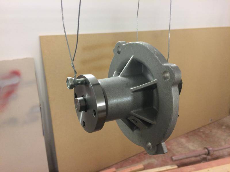

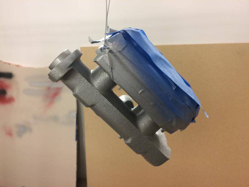

A small update of aluminum and finished bits that have been high heat clear coated.

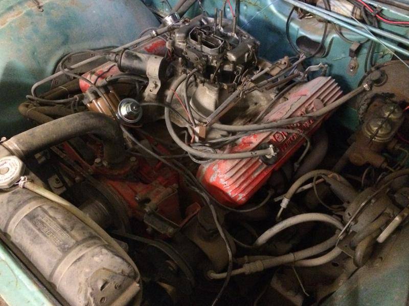

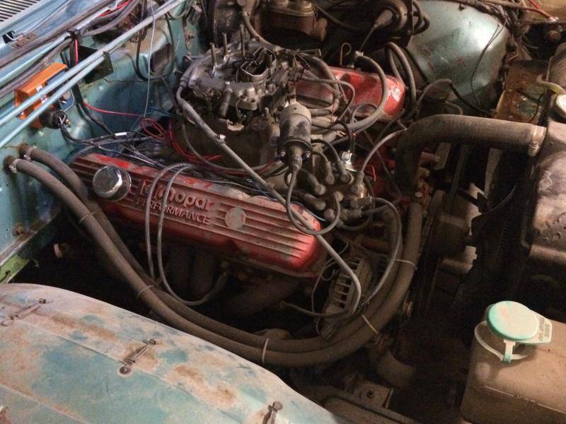

The engine is definitely looking like it's been neglected for close to a decade. This engine bay used to shine, and the engine was a high gloss "Chrysler Red" that you could eat off of it was so clean. A good clean up with a pressure washer is needed to wash the years and dirt away.
As as you can see the raw aluminum intake looks quite old and tired (yeah, I know it all does....) but untreated aluminium looses it's lustre over time. This was one of the driving factors in cleaning up the new raw aluminum bits and clear coating them. When the engine comes out I'll cleanup the intake (possibly sandblast if needed) and clear coat it.
The engine and compartment will definitely look much different over this winter - fabricated aluminum valve covers, aluminum water pump assembly, aluminum radiator........
