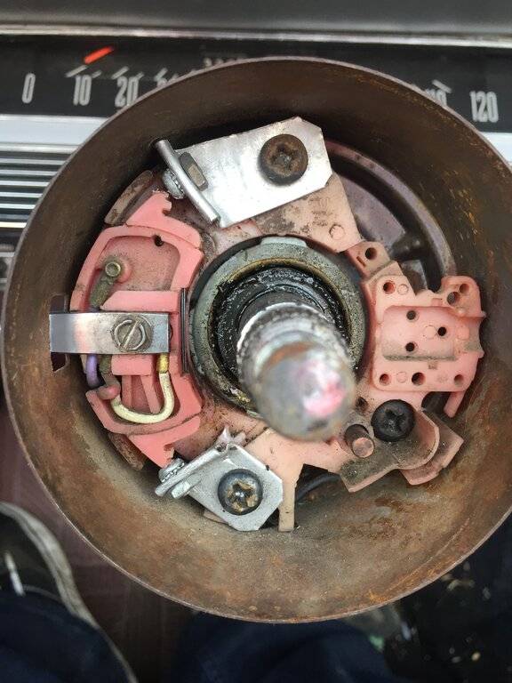

My turn signal cam is not in the best of shape (both of the arm ends are broken off).
I pulled the steering wheel today to look at it (and centre the steering wheel!).
Whomever a previous owner was did an interesting mod to help with the issue. As you can see in the photo they added some pieces of metal with small nuts and bolts to help hold the cam in place. (this was not working properly and I readjusted them for now to help it return to its original intended mod)

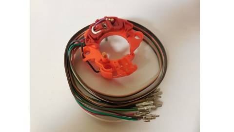

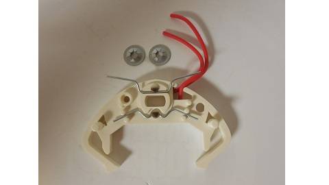

I was thinking I just needed the cam, but after browsing through Vans Auto, I'm wondering if I need the Saginaw one?
Turn Signal Cancel Cam - Fits 1967 1968 1969 Mopar A-Body, B-Body, C-Body
Saginaw Turn Signal Switch 1967 - 1969 C-Body
Or can I just replace the cam onto the switch I have?
It's a $130 difference. (and I have more time than money over the summer)

It's not tilt/telescopic (that would be nice, though, if I had that option). The Saginaw switch I posted is not for tilt/telescopic.
