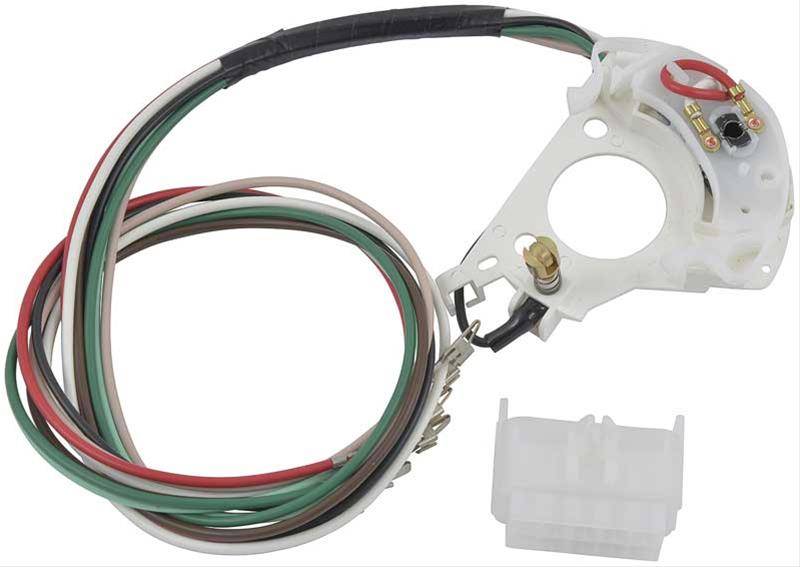

I have not pulled it apart, but I was wondering where I would find the springs in there? Is it not a plastic piece? Like this:
They might be on the plastic piece that the pictured item attaches to, I suspect.
The first thing you need to do is remove your steering wheel to see what's going on with the switch. I suspect one or both of the plastic cancel fingers broke off due to the plastic getting old & brittle. If that's the case you're probably in for a new switch, gluing them back on likely won't hold for long. You have to be wary when buying replacement switches on 68's, they used 2 different switches depending depending on who made the column. Given the prices on replacement switches, you may want to decide if you want to live with it if that's the only problem.
