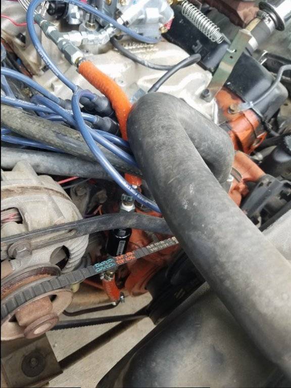

Around the first of the year I swapped my cars carb to a Holley street avenger. I wanted a good dual feed fuel line setup, and ordered one. Come to find out it hit my intake in several spots, and was a very poor choice. I decided to build my own at work. What I built is a stainless steel hose with Teflon tube, and static dissipating liner. It took a few tries, and many fits. I'm very happy with the outcome. I also plumbed in a 6an fuel filter. The Orange cover is firesleeve. It's good to 500 degrees, and protects from heat soak.
