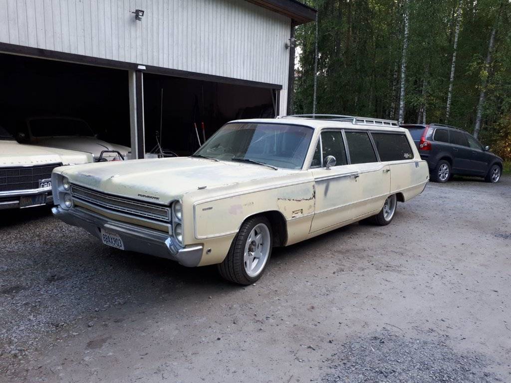

    Bought this car from craigslist january and later find out it was Helomech1969 old car.
    I imported it to Finland and now im enjoying my first mopar. :)
    Car has 383 4bl and 8 3/4"(742) sure grip.
    Next im going to install Fitech EFI and Mallory electronic distributor.

    Welcome; nice Lincoln (in the garage). We had one of these around the house that my dad worked on back in the day. It was green/green with a 383 and front disc brakes.

    Thank you. Lincoln is 69 continental with suicide doors.
    Sadly this one has drum brakes right now, but disc brakes are on the todo list.

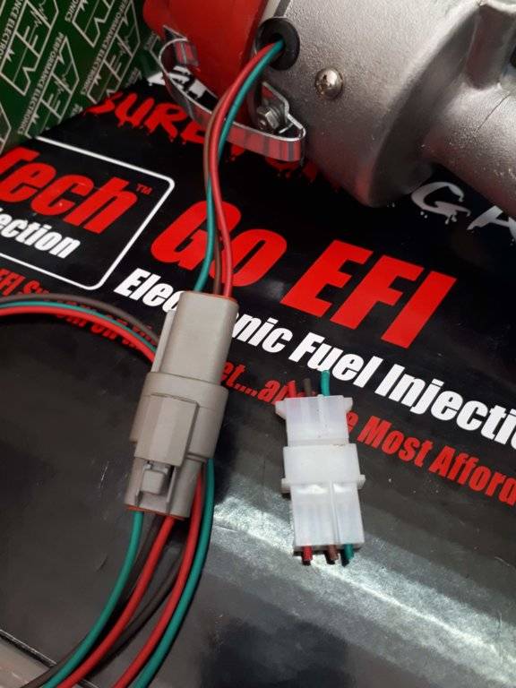

    Got the goods today..
    FiTech Go Street EFI – 400 HP System
    AEM 340LPH E85-Compatible High Flow In-Tank Fuel Pump.
    Mallory 3757701 Unilite Distributor
    I didint like that molex connector on mallory so i changed it to Deutsch DT Series.
    Already intalled the distributor and it works really well.
    Next project is getting rid of some leaks and then installing FiTech..

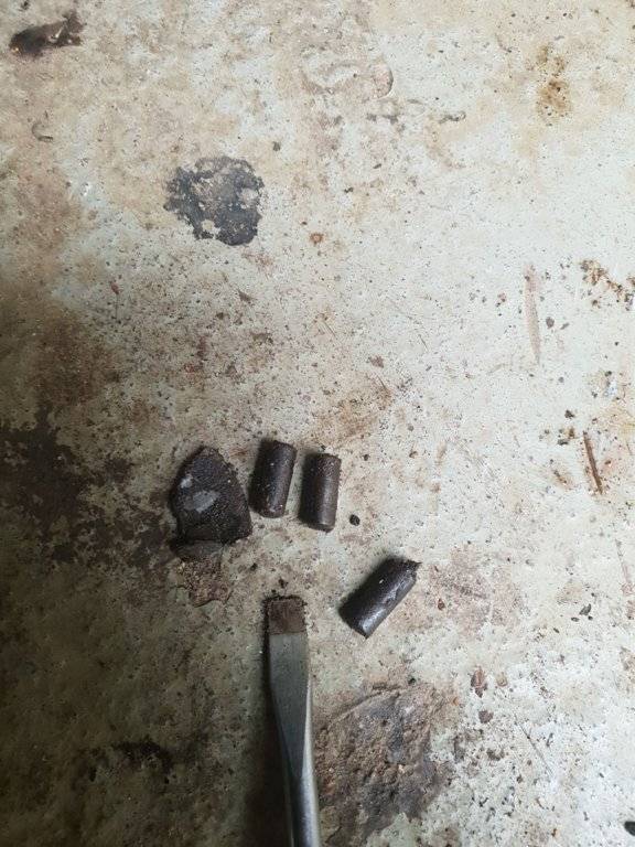

    Had to remove transmission becouse shifter seal was leaking so badly.. I also ordered B&M shiftkit and complete overhaul kit for it.
    Found these 3/16" diameter metal rods inside of bellhousing... no idea what they are.
    I also installed mallory distributor and started the fitech installation.. Had to order 1/2" carb spacer so it wont hit on intake manifold.

    Those rods (pins) look suspiciously like the alignment pins that align the bellhousing to the engine.

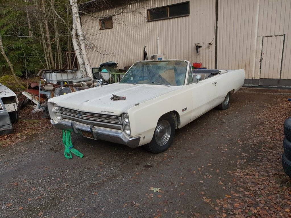

    Yeah so i accidentally bought 1968 plymouth sport fury convertible, but more on that when it arrives.

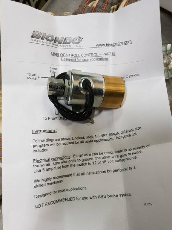

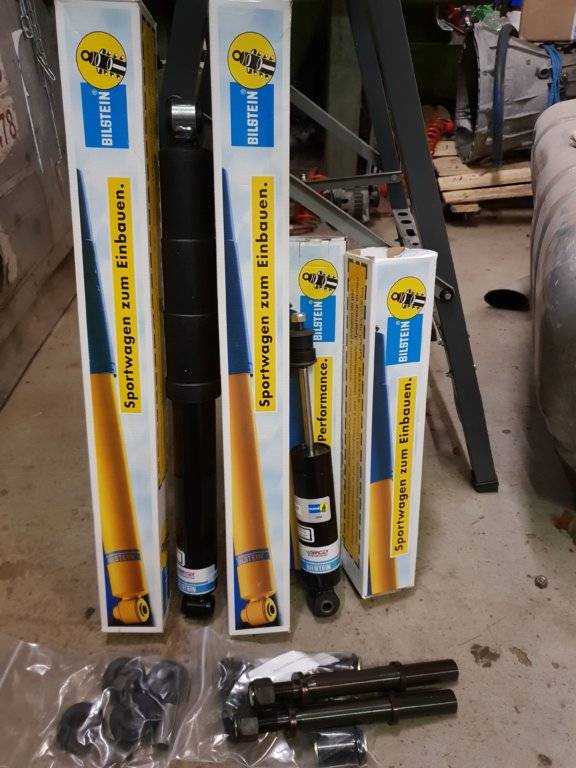

    More goods for this car:
    Full set of RCD Bilstein Shock Absorbers and Firm feel Urethane Bushing Kit
    w/ Greasable LCA Pins.
    New fuel lines for fitechi installation.. They are stainless steel braided teflon hose. Little overkill, but oh well. :D
    Line lock for back wheels so i can do good burnouts. :lol:
    • Like Like x 4

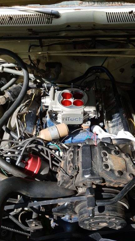

    Fitech is installed.. firts crank and it fired right up, but I saw spikes at the rpm signal..
    had to add like 140k ohm resistance to rpm wire and the spikes went away and it works really well now.
    Transmission has small problems.. gear indicator is little off and kickdown is not working after the rebuild..
    • Like Like x 2

    Convertible is running nicely after 10? years of sitting :)
    i think i need to make seperate restoration thread for it..
