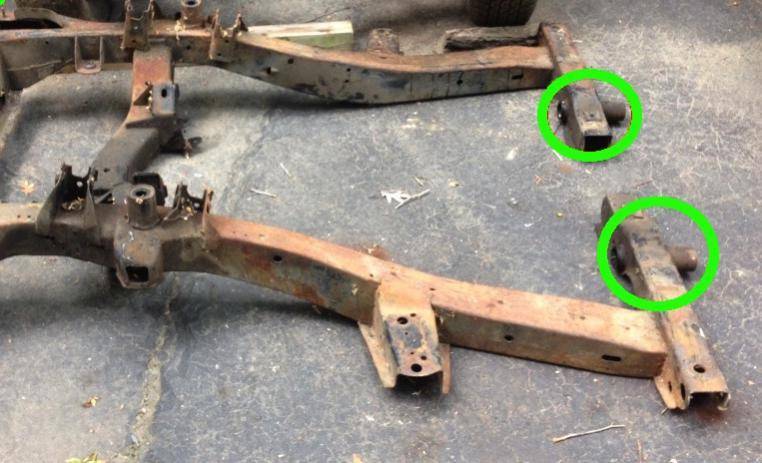

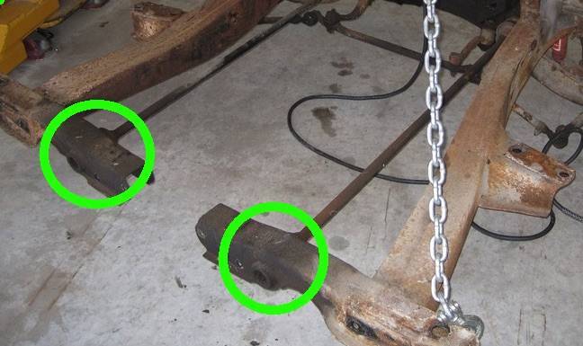

The V8 Frames are not all the same. The difference between the 47 inch torsion bar frames found on Chryslers and Dodges and the 44 inch torsion bar frames found on the Plymouth's and later Dodges can be identified by the torsion bar hex anchor in the crossmember. This is where the 3 inch difference is on both type of frames, on the longer T-bar frames the anchor is longer and protrudes out the back more than the shorter T-bar frames, all other dimensions are the same.
View attachment 55395View attachment 55396
This speaks volumes, this appears to tell me that the ONLY difference between Chrysler, Dodge/ Plymouth frames is the length of the hex tube itself, all other dimensions are the same?
Yes, if you choose to use the longer torsion bar stub in a Fury or a shorter torsion bar stub in a Chrysler it will bolt up, it won't be correct but it will still work. As I tried to point out early on you are not limited to just one year or car to get the correct parts from and how you can't just use anything, you need to use the correct parts that go along with whatever style stub frame you have (rigid, T.Q. or Imperial) such as fender wells radiator yoke etc. and to point out why they did what they did and why mixing these parts might not be such a good idea. There may be earlier stubs that can work on 69-71 cars or later stubs that might fit them, I only gave the information I had access to. If you want to know other applications it is not hard to research the information, it is out there. The information that I presented in this post used to pretty common knowledge among the C body folks years ago but I guess as time marches on there are less examples and experience to reference from so misinformation becomes more abundant. I am aware that I pissed off some gentlemen on this forum but I hope that I was able to help some others find answers to their questions.

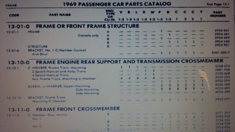

So in preparation for a possible front stub frame replacement, the thread states that any stub frame may interchange between any Plymouth except the sedan and hardtop (wagon is application). Is this true between divisions.
With this in mind I looked in both my Plymouth 1969 passenger car application loose leaf catalog and the 69 collision parts book. I found only 1 part number for the frame part#2934 459 for the eight cylinder. Maybe discussed but additional enlightenment or clarification of what I have read. The wrong replacement could be expensive. Attached is the reference page section.

commando1 thanks for the quick reply, the additional length accounts for the the same part numbers for the Dodge and Chrysler(these have longer torsion Bars?). With the Imperal also having a different part number. Finally with the Plymouth having yet another part number due to the length difference. Ordering the stub frame is still off in the near distance. Yes, from the thread the Torsion Quiet was never considered due to the info posted
