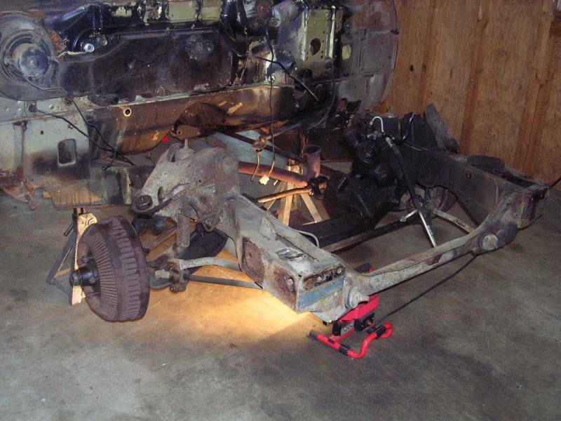

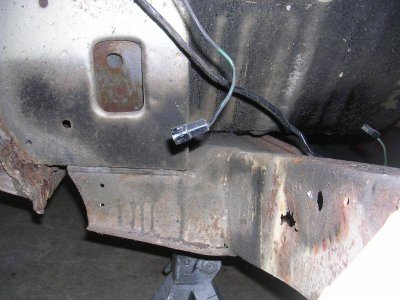

1969 - 1971 C body Stub Frame (subframe)
1970 Sport Fury BB V8 Stub Frame

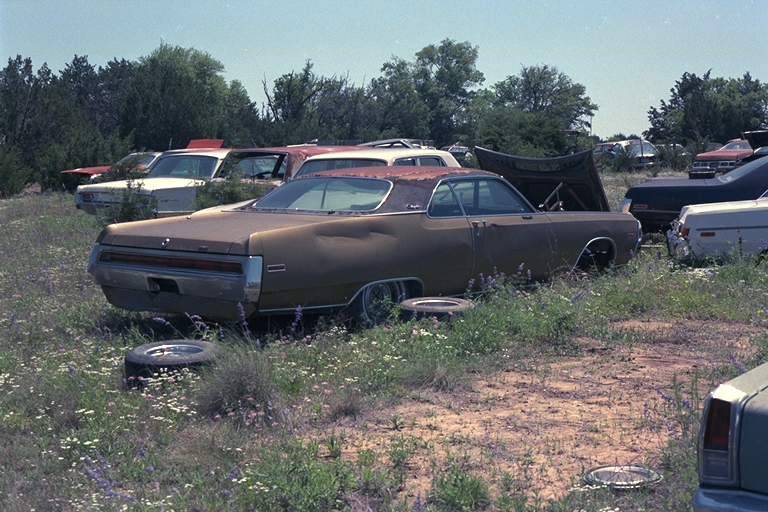

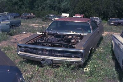

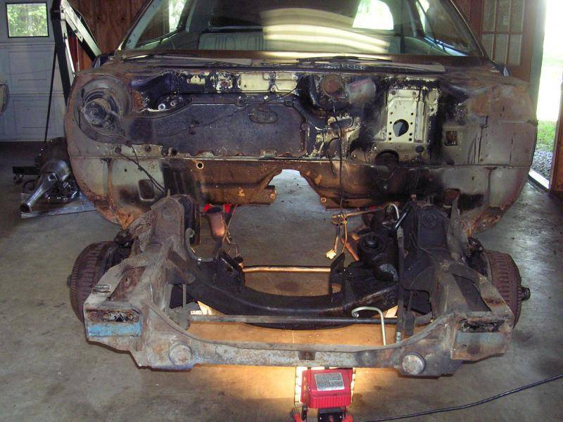

These pictures are from a 1970 Fury 383/727 parts car. I believe the V8 stub frames are all the same. One of the pictures shows a close up of station 2.

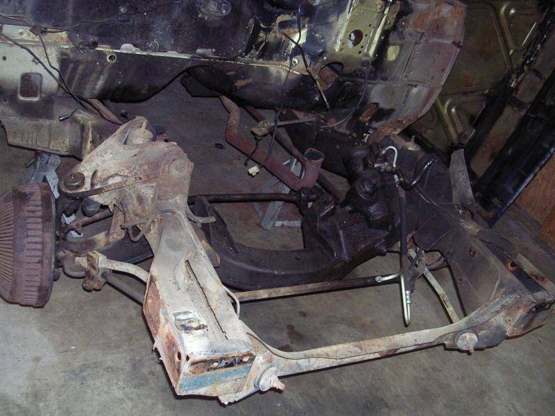

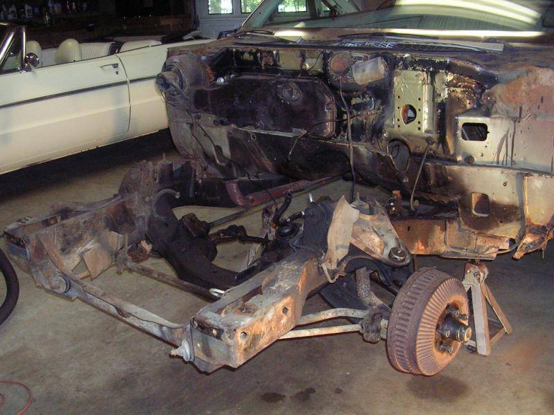

Several years ago, on my 300, I had to replace the SubFrame with a donor from another 70 300 sitting in a junkyard which I bought and salvaged many parts from, should have done a better job in salvaging it, and categorizing the pulled parts, but, like everything we do 15 yrs ago, we need to be doing it better today -- at least this is my aim!

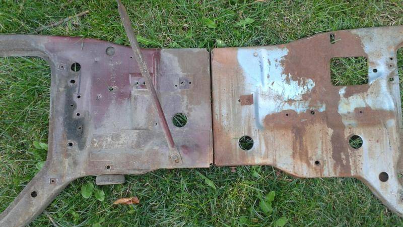

Radiator Yoke Differences
I wish you could lay the two of them flat down, one posed over the other,
and could shoot down with a camera while standing on a ladder.
But man that's a lot of work....

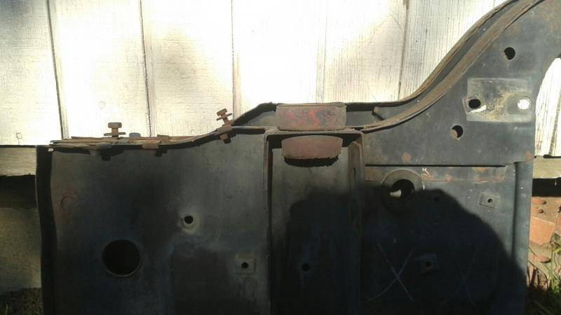

Attached are photos showing the difference between the TQ radiator support and the rigid mount support. I also have pictures showing the differences in the front wheel wells if anyone is interested.
TQ support has provisions for the extra support bars that the TQ frame requires
You can see in these pictures the differences in the mounting points along with the extra gusset on the TQ support.

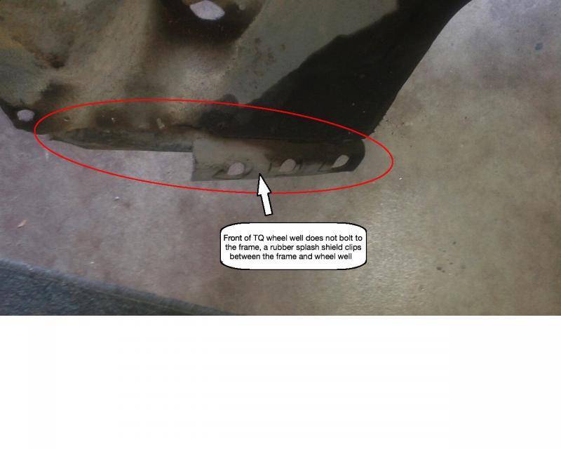

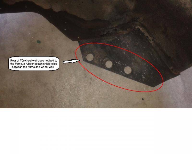

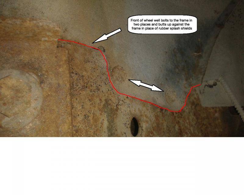

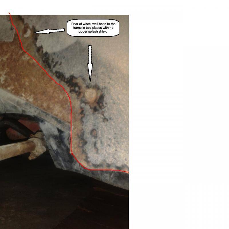

Yes, please post the pics of the different wheel wells.
The wheel wells on the rigid frame cars bolt up to the frame in four spots whereas the Torsion Quiet wheel wells do not bolt to the frame at all, they only have a rubber splash shield connecting the wheel well to the frame.
TQ frame
Rigid frame

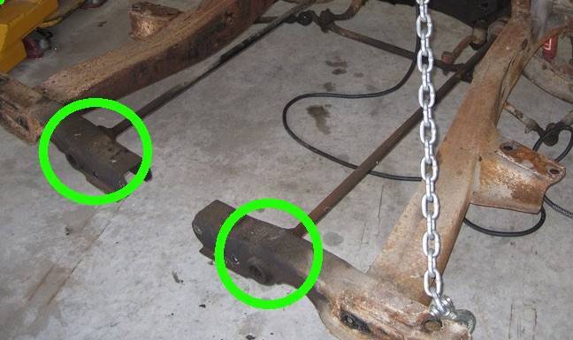

Frames Are Not All The Same

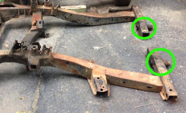

The V8 Frames are not all the same. The difference between the 47 inch torsion bar frames found on Chryslers and Dodges and the 44 inch torsion bar frames found on the Plymouth's and later Dodges can be identified by the torsion bar hex anchor in the crossmember. This is where the 3 inch difference is on both type of frames, on the longer T-bar frames the anchor is longer and protrudes out the back more than the shorter T-bar frames, all other dimensions are the same.
