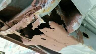

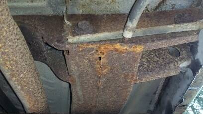

yup escaped the problem by buying the whole dam donor car.
this from this
