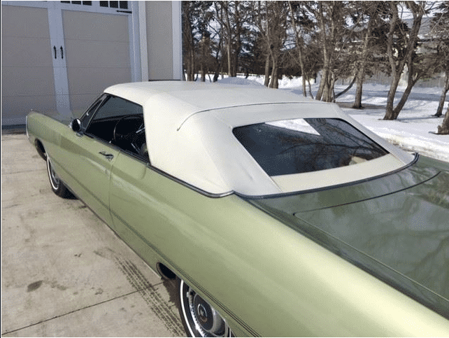

Hello all! It’s been a while since I have posted due to some health issues but I’m back on my 300 restoration. The soft top that came with my 300 had a perfectly flat glass rear window. I am having a new top which I got from Robbins installed right now. The installer said the new window had a curve to it and was a bit taller than the one that was in it. Can anyone tell me if the rear glass window was originally flat or came with a slight curvature to it? TY all in advance… looking forward to getting back to posting my progress!

Not sure but I think the original had a slight curve like in pic. Car ad said car is a survivior and all original, but he could have had top replaced. What does your look like?

I would suspect that the rear glass would have a small compound curve to it, top to bottom and side to side, to match the contours of the car body. Putting a flat item in that situation could cause extra stress on the seams, possibly, which might compromise the look and ultimate durability of the top fabric in those areas.
Just a suspicion,
CBODY67
Top guy said it had seemed like the top had been replaced at least a couple of times so…. Also, I ordered the top from Robbins who I called directly and didn’t bother fishing the internet. The top guy said that the top wasn’t specific to the 300 I have… label said “full sized Chryslers”. He is having a few small issues when it comes to where to staple it because things just don’t seem right to him. I trust him because he has been doing this for over 30 years and if he is still in business then… he must know what he’s doing! Will give updates next week when I get the car back.
