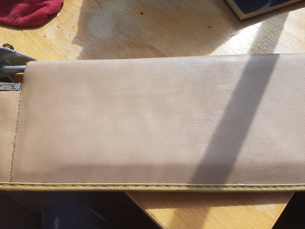

Sunvisor after rubbing it with SEM Soap.... much much cleaner. But did buy wrong prep... plastic and leather... sigh. So no painting yet. Chromed parts are too rusted, but much better looking after cleaning them with 0000 steelwool. Have to get silver paint, so can paint mounting triangle.
And need new plastic caps for mounting rods.

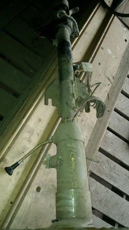

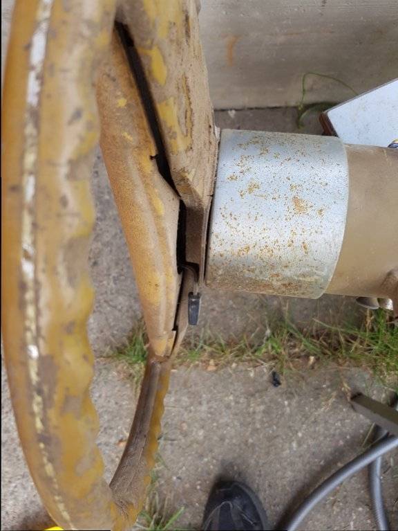

Gathering more parts. Tele/tilt column. Tho its from -70 300. So have to do some rewiring...
And i want Tuff steering wheel on that... lets see how hard its to do.

Congrats on that column. Looks like it came from a floor shift car, which would be added bonus.
I'll buy that steering wheel from you if you don't have any use for it.
Its from column shift car. Wasnt that lucky to get floor shift column. Tho i think price was good, 100$. If i figure how to change Tuff style steering wheel into it, i sell that wheel to you. It has few shrinking caps and cracks in it.

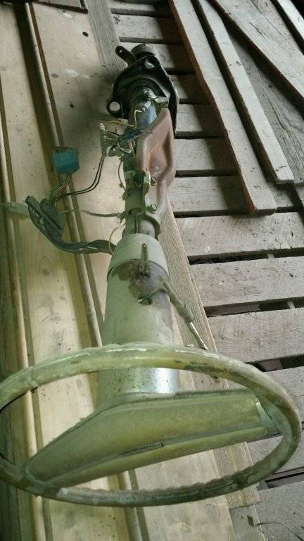

Edit, now i just need backseat back with arm rest and center speaker from New yorker, Imperial etc, PW...
If you figure out how to install the Tuff wheel let me know as my 70-300 t&t column's wheel is all cracked. In fact what colour is your wheel it's hard to tell and if you are not using it would it be for sale?
Wish I could help on that Tuff wheel change. I'm afraid I don't know anything about the interchangeability of B and C-body wheels. Are you going to use a genuine B-body wheel, or a repro? I read somewhere that the Grant Tuff wheel is not a plug-and-play thing, not even in a B body. - Restoring a cracked rimblow wheel is laborious, but it can be done.
Was thinking Grant repro wheel.
No idea of color, its still on its way to Finland from US.

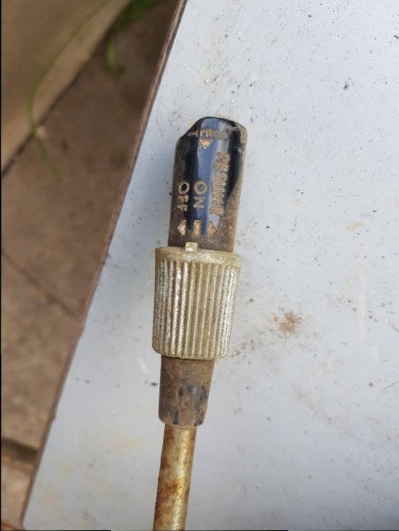

Column arrived today. Have to check bearings, turn signal system. Then clean it, paint it black. Order Grant install kit for Repro tuff steering wheel and hope it fits...
But must find new turn signal lever, its broken.

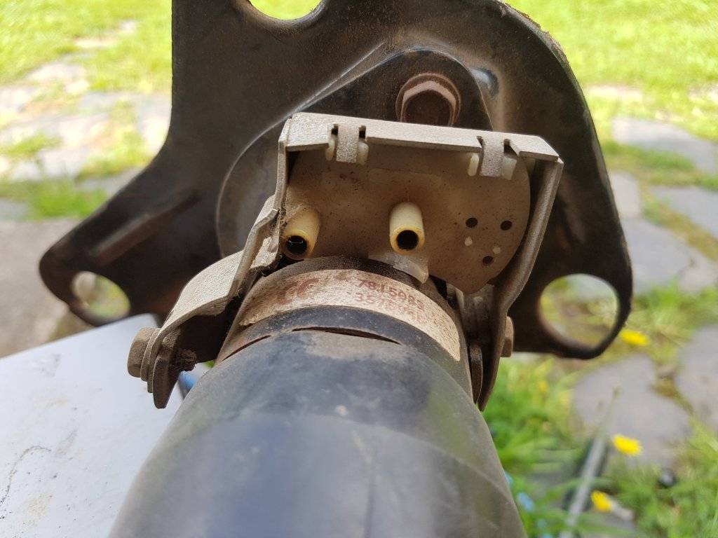

And what is this part?

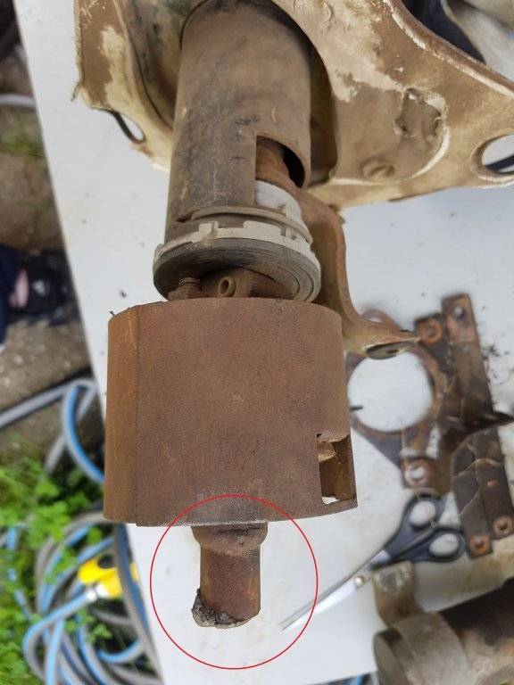

Sigh, i hope this aint tele/tilt column only part...
Looks like the roll pin can be removed to remove the coupler and cut shaft. The switch looks like a vacuum switch for e-brake release if it was a Mopar option I have seen it on Lincolns.
Cut shaft is attached to coupler with 2 bolts. So its easy to replace.
